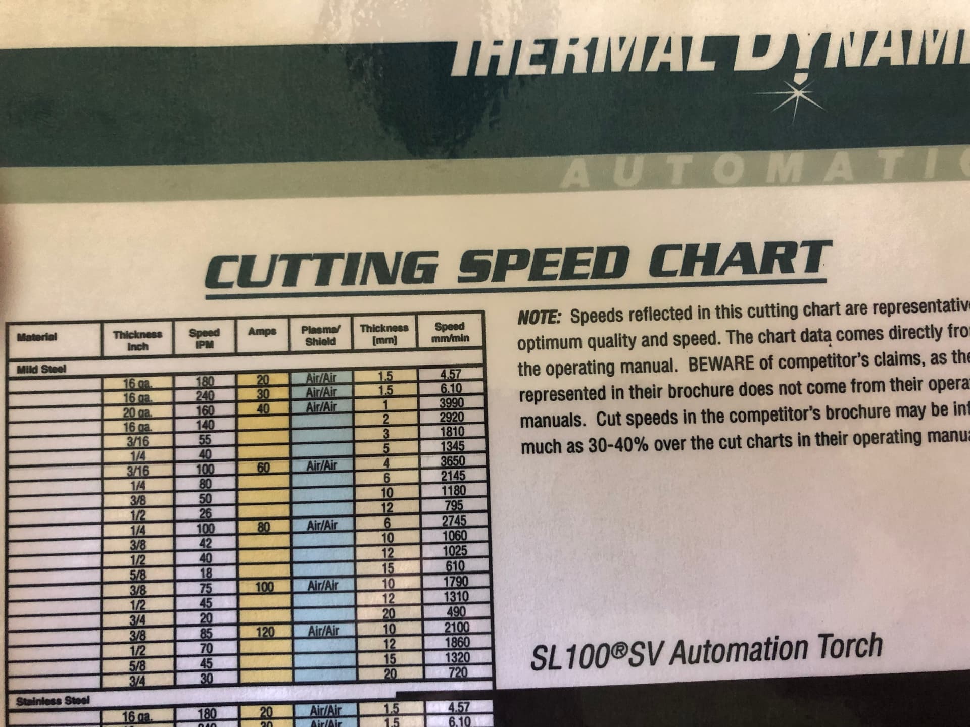

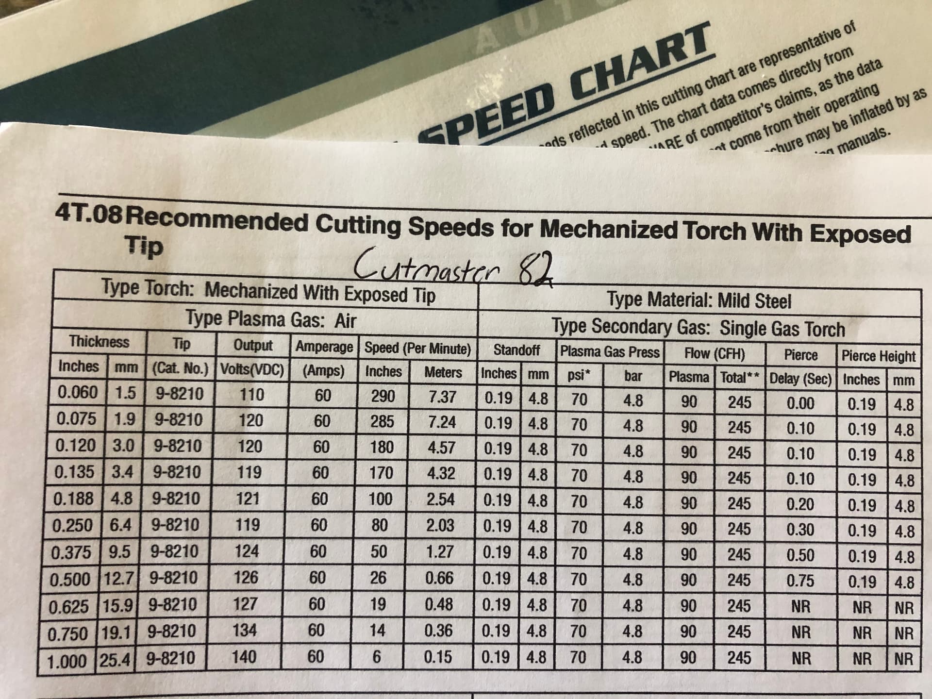

I had to drop 1/4" plate cut to 24ipm to get it to cut clean at 60amp with 60amp consumables genuine Thermal dynamics. I think I could get it up a little higher however my charts says 40ipm-80ipm. I will try to attach pics of the charts. One is direct from manual one is for the sl100v mech torch.

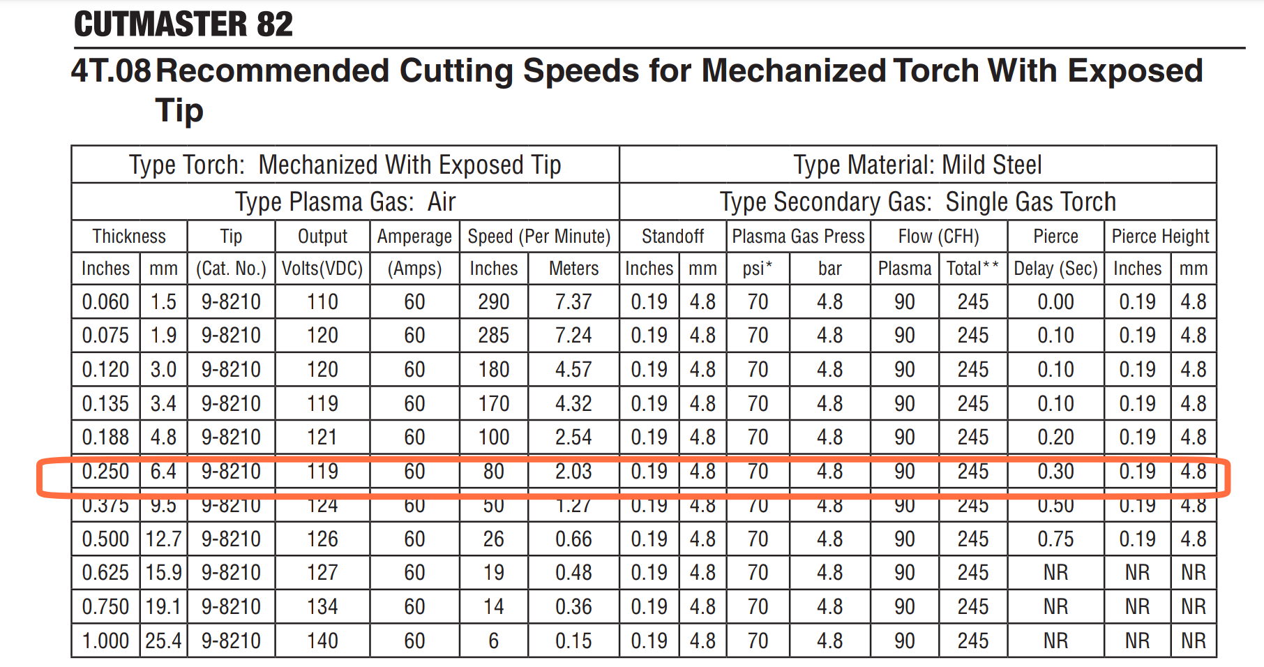

Why would you set your cut height to .06? Your cut height in the chart is the same as the pierce height. 0.19

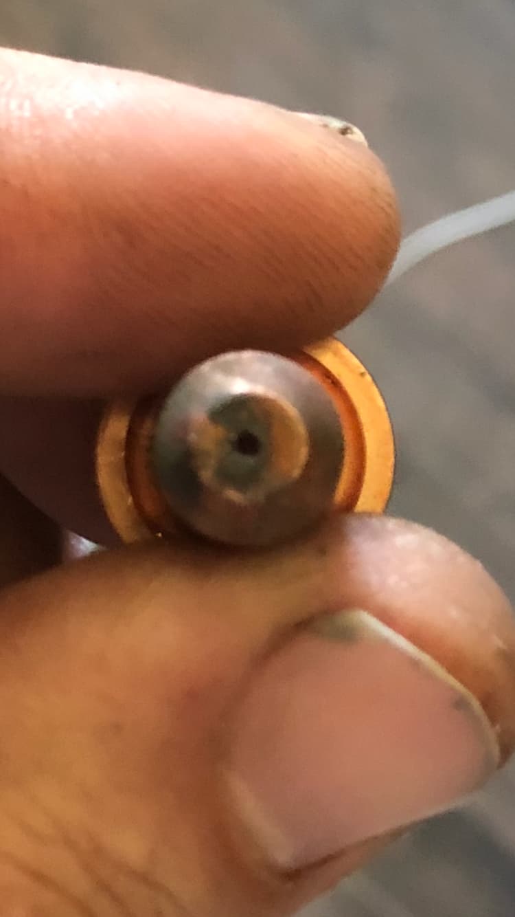

What is the current condition of your consumables? If you are unsure post a picture. What kind of deflector or shield are you using on the front of your consumables?

In these cut charts standoff height is cut height.
For this operation it looks like they want you to have nozzle.
9-8210

I am using the first set you have highlighted but I do have the second style as well. Yes I have the 9-8210 tip in as that is the 60 amp tip.

And your consumables are in decent condition? Air issues like you had and cutting it incorrect heights could wreck a set consumables very quick.
I replaced these thinking they are bad.

.25" 80 ipm 119v .3 delay .19 pierce and cut height as chart says. no go! just a nasty gouge. slow to 60 ipm did fine
.5 26ipm 126v .75 delay .19 pierce and cut height also no go
lower to 25ipm and had a mix of pierce and then just gouge 1.5" into 3" line cut.

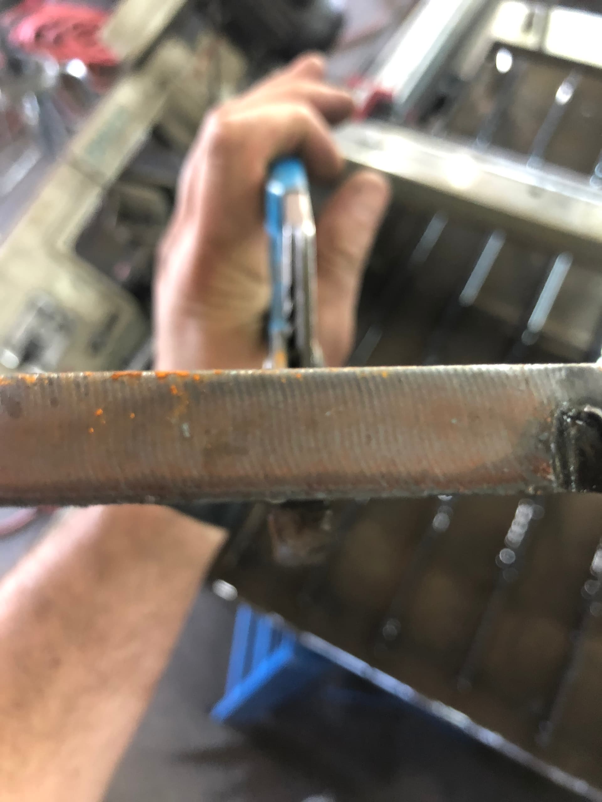

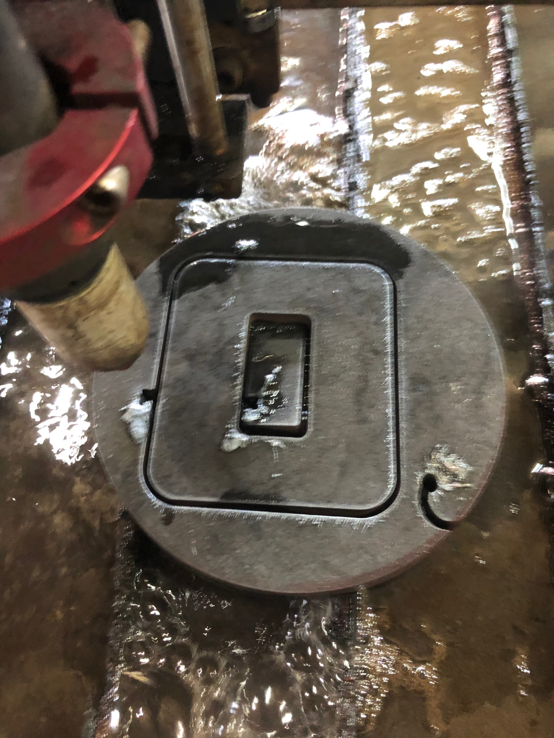

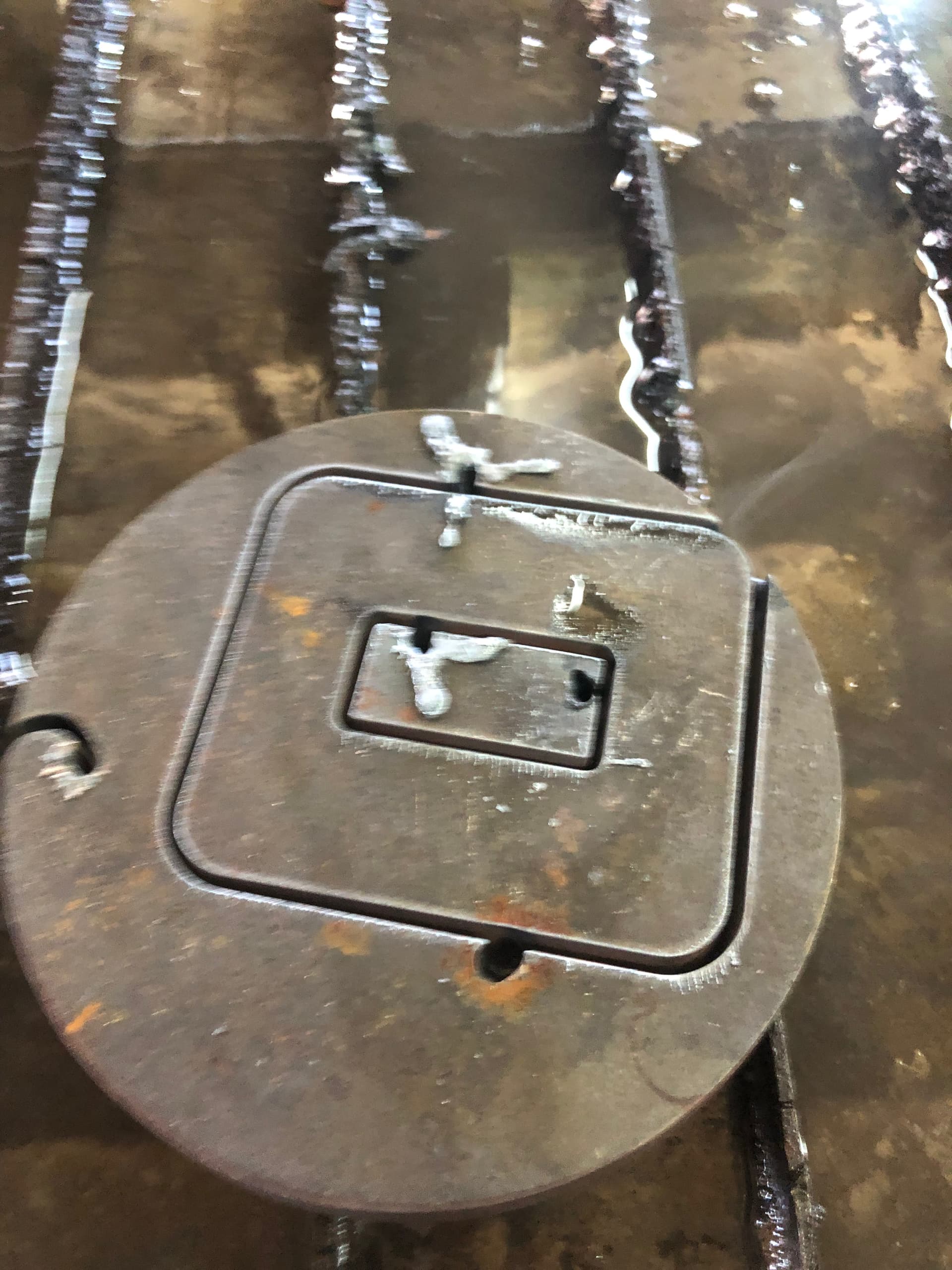

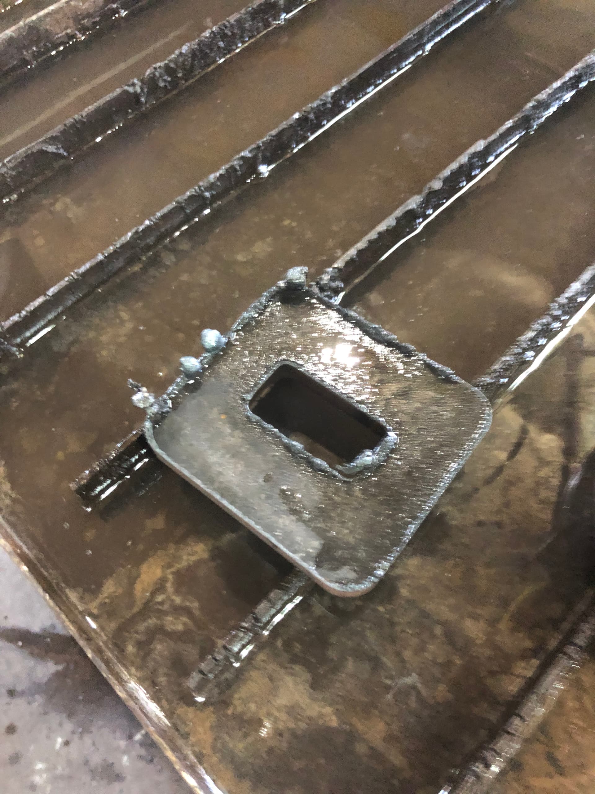

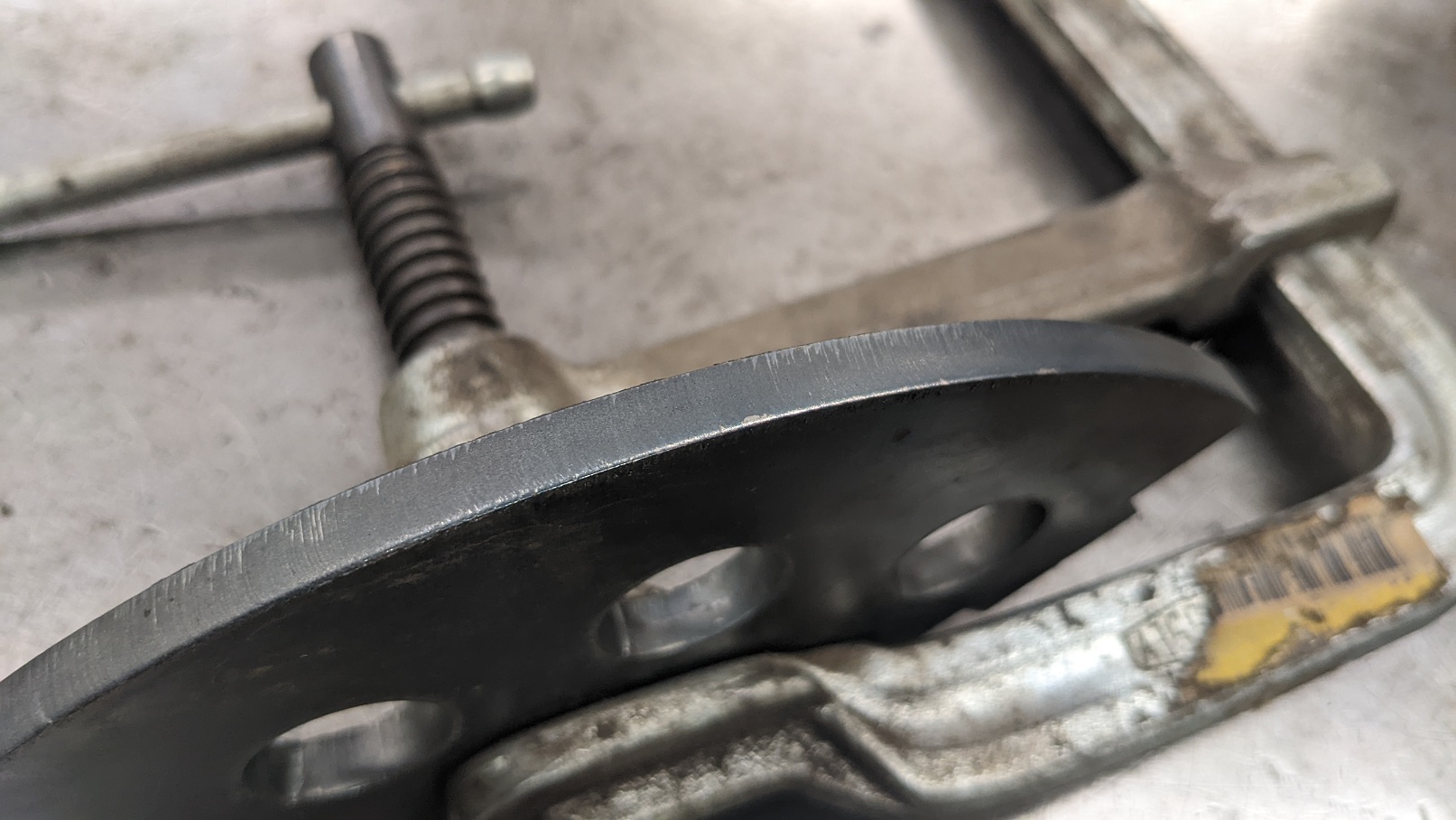

lowered to 24ipm and had success. At this point I tried cutting a part. had bad bevel. This was all with the consumables form pics above. installed new electrode and tip and had good results but still more bevel then I would like.
above is with the used consumables.

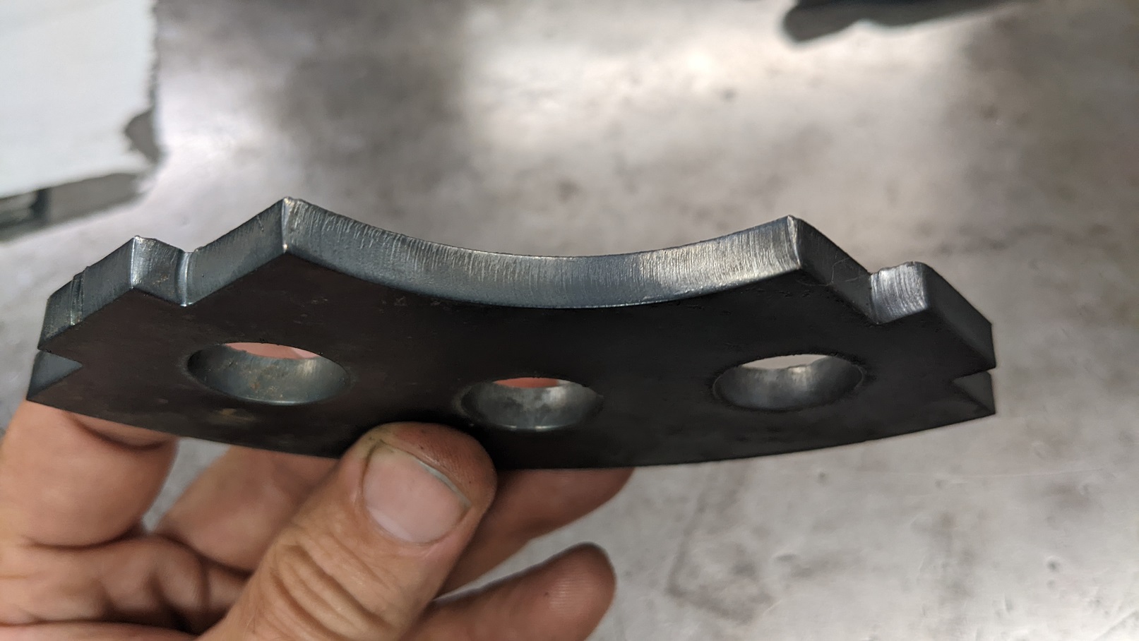

here is with new consumables
have you tried a cut using smart voltage?
Those small pieces sure make it hard to clamp to, They also don’t touch the slats much making a good circuit through the slats harder.
The bottom of the side picture looks like a great cut.
I have done both with no noticeable difference yet. might be my untrained eye though. I ran into the ground clamp the cut before these ones so I cheated to the slats. these are actually scrap from the big plasma table at work. they get out in the recycle bin so I grabbed them to do test cuts on. plate steel aint cheap to be testing.

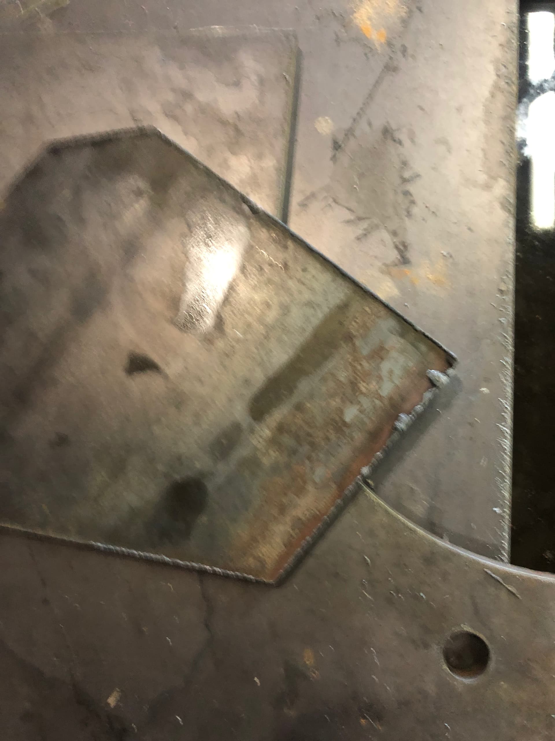

Today cut a couple parts out of 1/4" CRS using the setup above.
This is straight off the table with no clean up. The steel is pretty dirty on one side. You cut see there’s only a little doss in spots with the edges are clean and square. The edges in the corners get a little wonky but that is from me being lazy and not tweaking the feed optimization during setup. These consumables had 213 pierces on them when beginning.
