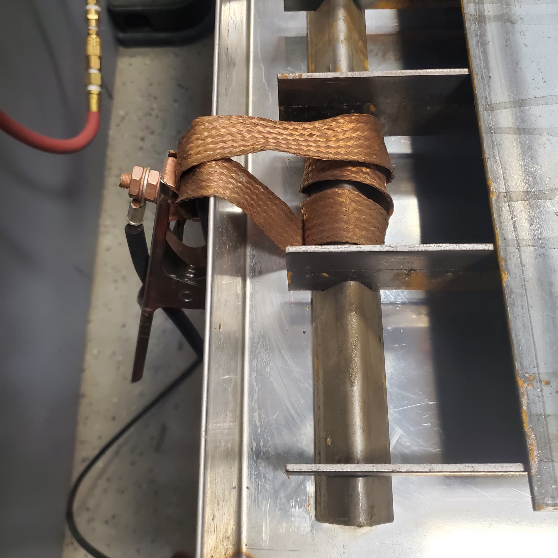

This is my ground clamp set up. It is all under water when cutting.
Your work clamp should always be clamped to the metal being cut. NOT on the table, slats, water pan, etc.
Sometimes you have to watch whether the decimals in the right place for your cut height. I’ve seen many instances where people write in .6 instead of .06.
Anyhow sometimes this easy fix is overlooked for newcomers
You “might” be getting a good connection with the bright clean metal while the table slats and the metal you are cutting is clean and free of mill scale and oil but as George says “Clamp to the metal” whenever possible.
That removes one “possibility” of cause for an issue.
Knowing what I know now, to rule out the work lead connection to you work piece, I would unplug the cutter, open the case and find the wire that connects to the connector for the work lead. Using a Volt-Ohm meter set to “Ohms”, jump one lead on that wire inside the cutter. Now put the other lead of the meter in between the jaws of the work lead clamp.
Watch the meter and wiggle the work lead where it connects to the machine and where it connects to the work clamp. See if there is any changes in the reading. Your reading should be very low: something in the order of less than 10 ohms.
This test would rule out everything about your work lead. Finding the problem is all about eliminating the “possibles.”
That could cause for capillary action, with your work clamp being attached the way it is leading to rust and more. That would also increase resistance which could attribute to your voltage issue as it directly relates to cut height (and in this case, beveling).

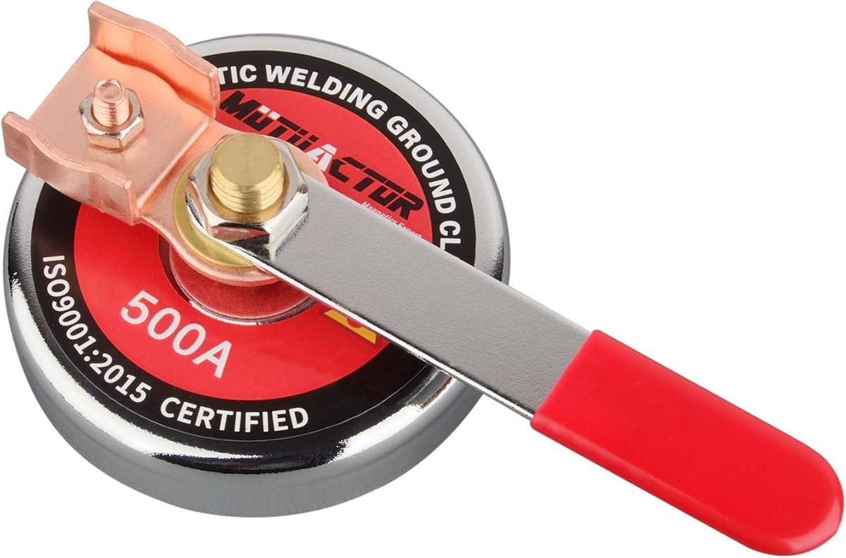

The work clamp setup you have may work in theory but believe us it won’t. Work clamp on the metal you’re cutting always. This chart will give you an idea of what’s happening. Now there are several other factors that could lead to beveling.
Worn consumables or cheap Chinese shit will contribute. Amazon or Plasmadyne are great examples of junk.
Get yourself something like this and attach directly to the plate being cut.
MUTUACTOR 500 AMP Magnetic Welding Ground Clamp, Φ3.34” Strong Gripping Quick Release Magnetic Mount Welding Support Clamp Tools for Welding Cutting Factories Industries Work and Instrument Processing - Amazon.com
