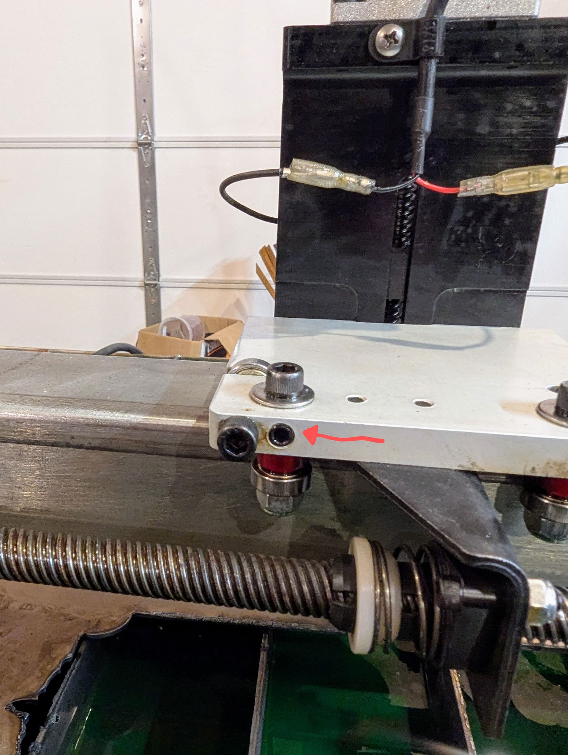

I didn’t make out much better with my leads/peircing, but I did swap out four more bearing blocks, and I think that I found the root of the wiggle! I’ll attach a photo of the set screw that I think was allowing the wiggle.

That set screw is the adjustment for the X carriage bearings, mainly to adjust the tilt of the carriage. Loosen the nut that holds the bearing and use the set screws to move it in or out. There are two there and two more on the bottom of the carriage.
Also check the wheels that roll on the rods for the Z axis. The two on the right side have eccentric axles to adjust them. Loosen the nut and the axle has a flat on the end to be able to turn it for adjustment.
