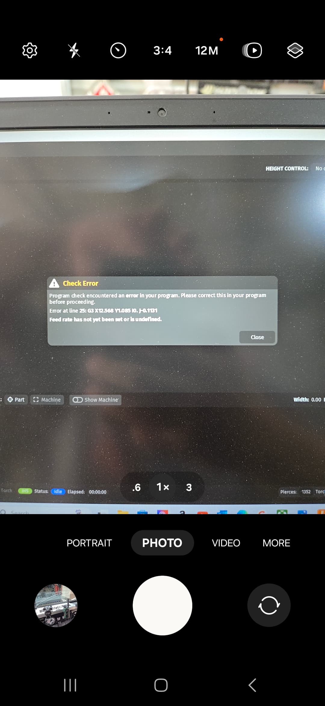

Feed Rate not found or undefined Error
I have gotten this error a couple times now and have yet to find a proper reason or fix. Using Fusion 360 and it simulates the NC without issue. When I go to upload in Fire control it shows the error. Im stumped.

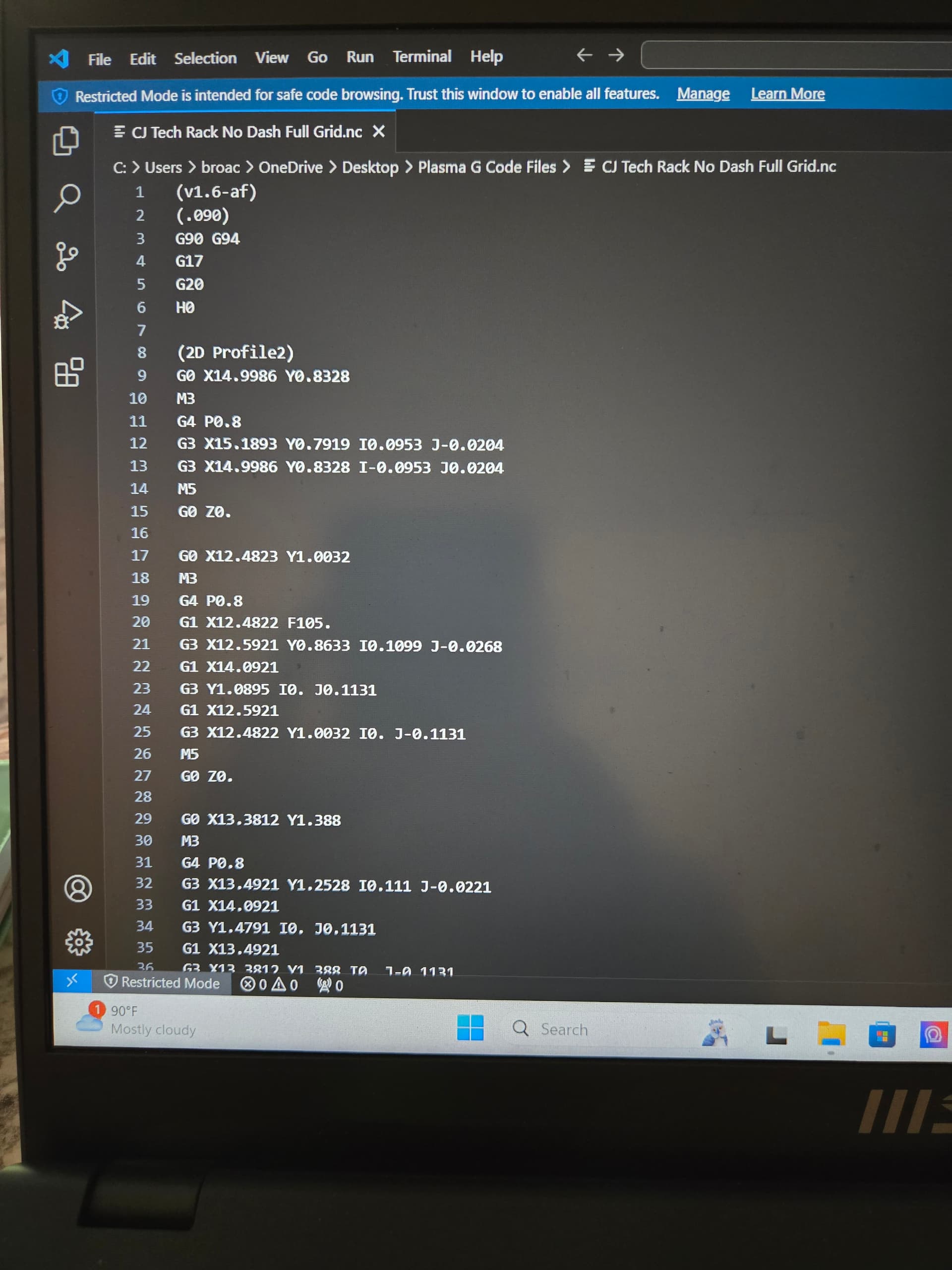

Heres to odd deal. The line it is referenceing in the code does not exist in the code.
G3X12.568 does is not in the NC program.

I re wrote the file and now it shows a different value but I do have a G3 X12.xxx.
The only thing I changed was the Keep Knozzle Down selection. I always use it as i dont have a Z axis.

Looking at your screenshot of code, it seems very odd that there is no feed rate command until the 2nd profile (Line 20 I believe.) At the very least, line 12 should have a Feed rate (F parameter) at the end of the line.
I also can’t say I’ve seen the comment on line 2, the (.090) in any of my code generated by Fusion. May be setup related, but not sure.
