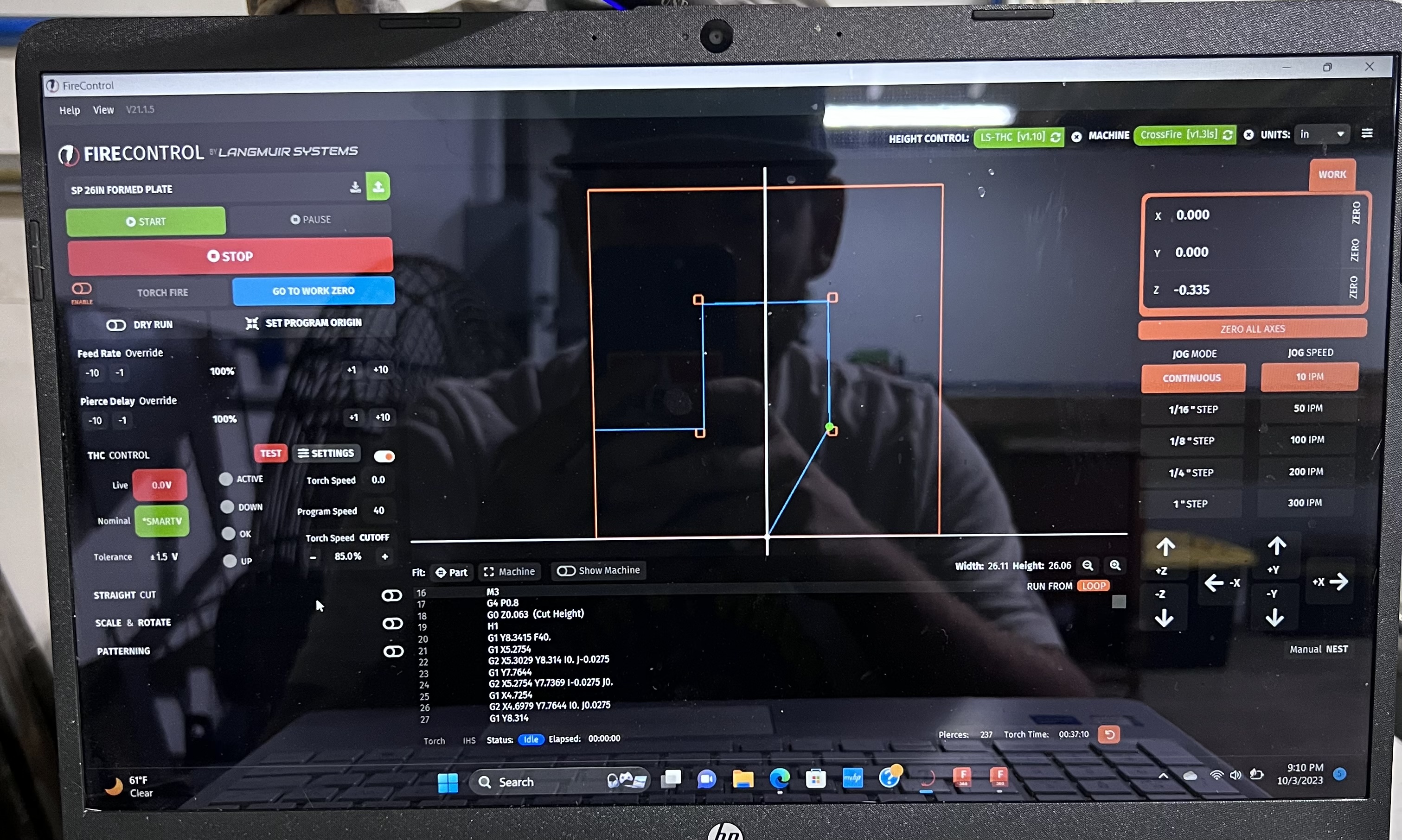

Faults on New Machine (SOLVED drag shield removed)
This is hitting the space bar mid cut
The clamp is on a very cleaned off surface. Even cleaned up the copper jaws just for good measure. Nothing solid yet.
I believe you have your drag shield on. This will throw off the cut height considerable.
And, was a cut program in process when you hit the space bar? That is how you need to test. A tape measure will not measure 0.06 inches. You are showing more than 0.25 inches right there.
You will need something like this to measure the cut height:
I have valve shims. Yes I have the drag shield on, I’m a rookie!
No shame though thank you for your help. I will pull the shield and re-calibrate THC
Exactly. We are all just here to help each other.

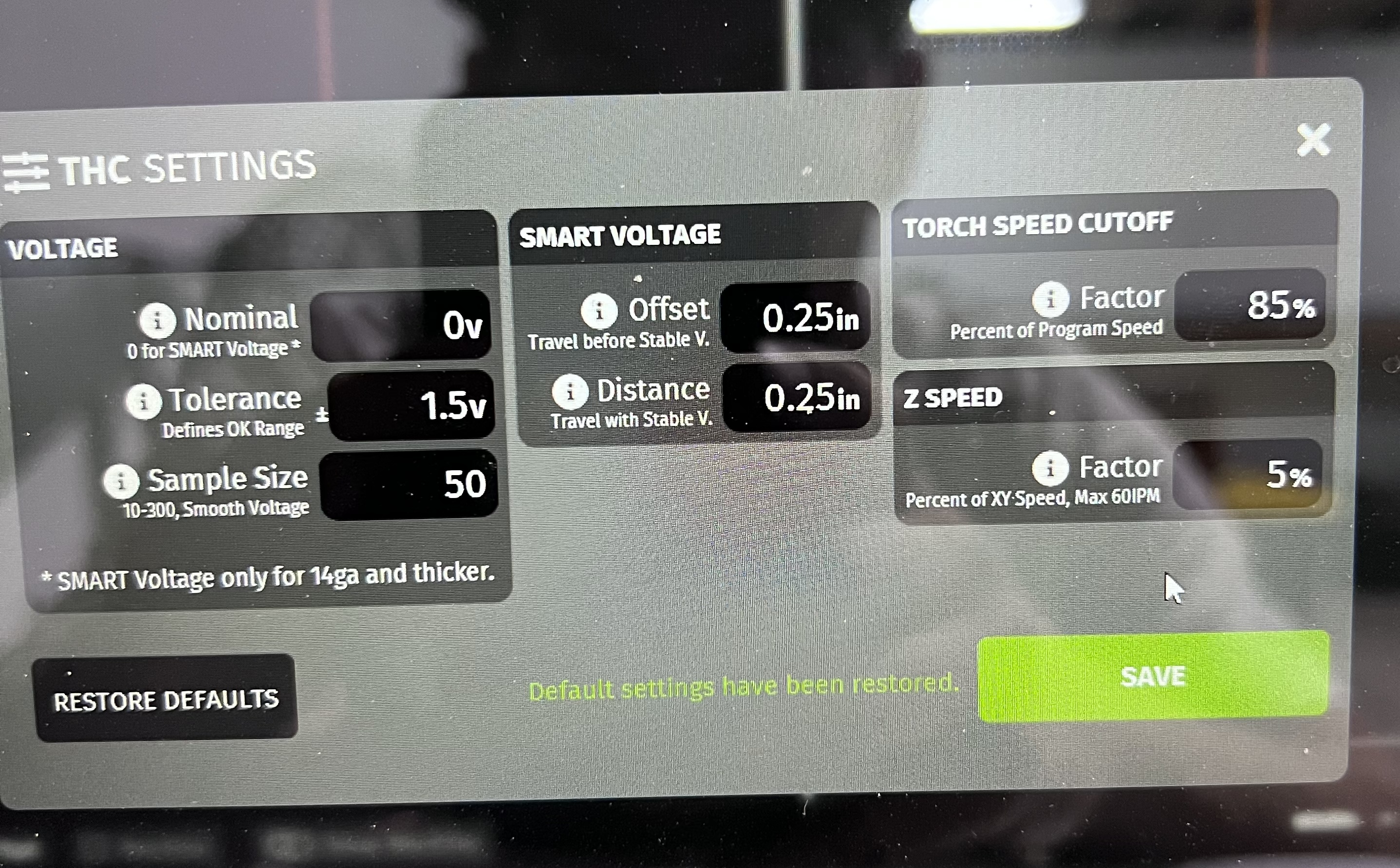

Are these default settings acceptable?
Test run setup
I think so but I have only messed with the sample size.
Did you remove the drag shield?
You will never get it to work right till you take the hand cutting standoff off the torch.
dude…I have a 62i…so lets get this right,…
get rid of the little leg stand ooff unit …that little ring with legs is only used for free-hand cutting…remove it from the torch when doing CNC.

I pulled the guard off of the torch and did the THC testing process for good measure. Everything cut perfectly….immediately. Thank you guys.
It really is amazing how it was something so simple. But this is something I’ve never been around. And I don’t feel that bad because I’ve had guys over that have been using plasma cam setups for years and no one else caught it.
