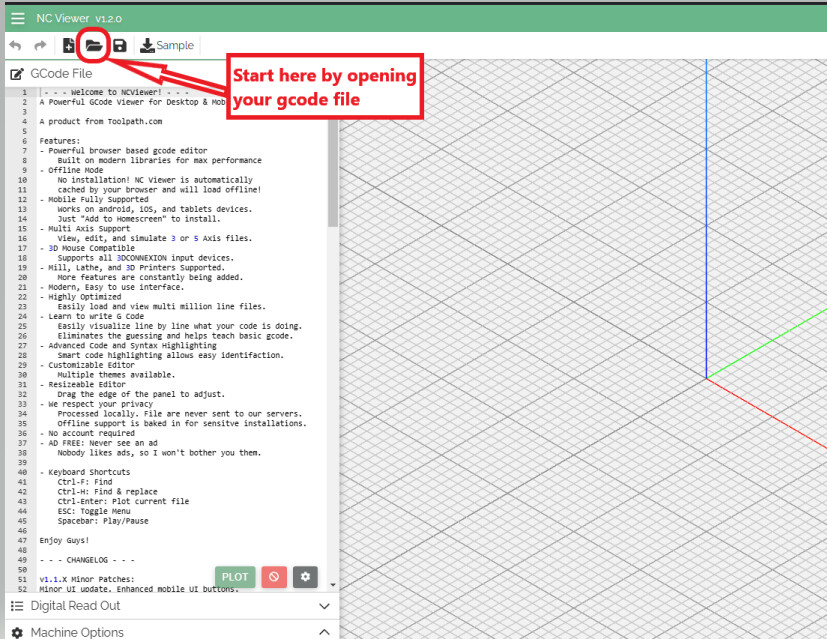

ok, hoping for a longshot. i was drawing up a layered sign and got the top layers cut. Now i am moving onto the base layer and my computer updated and i didn’t save the f360 file yet and now it is gone.
the top layer Gcode has all of the holes that need to match up with the base layer, i just dont need it to cut all of the shapes except the outside.
is there any way to reverse generate the gcode? or at least choose in firecontrol what to cut?

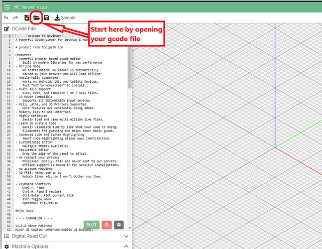

I assume you mean to get the design from the gcode? Yes
Try this (and it is free)

If you just need parts of the original file cut, just click on the outline in Firecontrol and select run from loop. Stop it before it cuts stuff you didn’t want and do the same thing on the next desired cut loop.

Well thank you for all the input. I ended just cutting the outline and i will line up the top lauer and hand drill those parts.

g code Ripper is also an option to recover some version of them file
