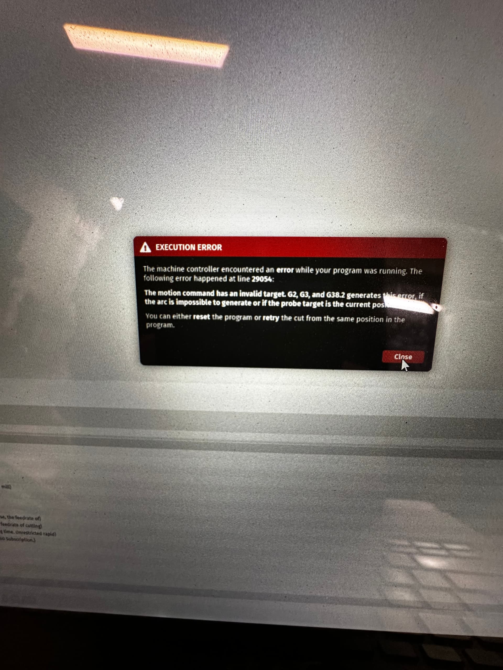

Got an error more than halfway through my first real program. Mill just resets and says it needs to home, and no way to restart there. Tried deleting the first 48000+ lines but then it didn’t go back down to the correct cutting height. This is straight out of fusion 360. Any ideas?
The second half of this part is a much longer program, I don’t want to have it happen there too.

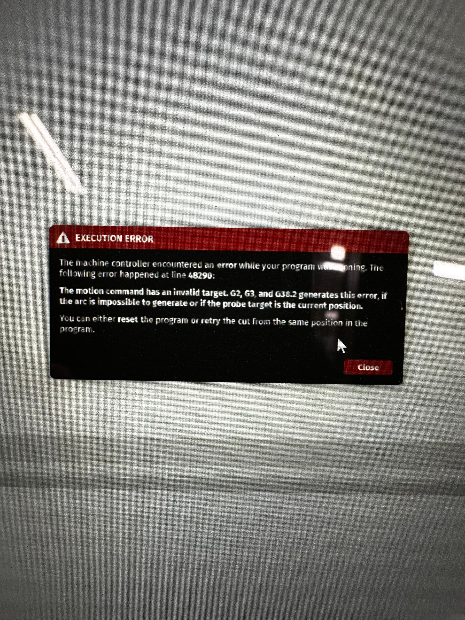

Here you are, looks like this will work. This is the original with the error at line 48290.
mountain 375.nc (1.6 MB)

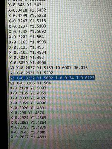

Ok, were looking at this. I did the analysis on line 48290 from that program and there is a .0002 error is between what the end point of the arc is and what is should be. I’ve asked software engineering to let me know what the tolerance is that is built into the controller. Will get back to you.
Another observation, there is a LOT of code here. I recommend reducing the count by increasing the smoothing and reducing the tolerance in CAM.

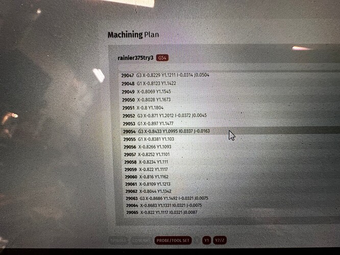

Yes we found this issue in our firmware- working on the update now. I’ll let you know once its ready.

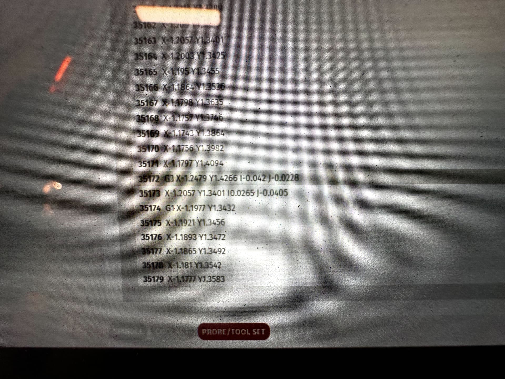

So did this get resolved? I updated machine firmware to 1.3MR which is what i already had, and it has the same error code twice now. Same execution error and saying it was a g2 g3 problem.
