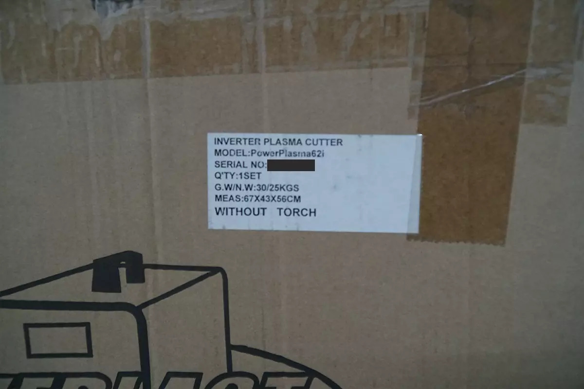

FWIW - I just picked up a new 82i to use on thicker material than my PM45 can handle. Bend-Tech is getting rid of what they had in stock and selling them on eBay. They have the 62i and 82i models available as of today 11-5-24. I am still hooking mine up but they are brand new and I can at least vouch for getting what they stated in the eBay description. Mine was QA in 2021. Here is a link to the 82i (3 left). This is the machine torch model. $700 and taking offers.
torch included?
Would presume it comes with this basic package

I am waiting for a response. Like I need a 3rd plasma cutter.
Be careful; that deal sounds too good to be true… Something isn’t right. I don’t believe that dealer cost is that low. Hopefully, you will get a good machine—just my two cents, buddy.
The listing for the 62i s they are selling are clearly marked WITHOUT TORCH.
Without more information I would assume the 82i also includes NO TORCH
Good catch.
That is a $400 part for work clamp and torch easy.
ETA - Now hang on a minute…where did you get that photo ( I read to fast found it )? I went back to the link above and could find nothing about the torch being included or not. Nor is that photo part of the listing.
@TinWhisperer - I’ll confirm when I get an answer from the seller.
Their description talks about it being used with torch not that it includes a torch.

Now is the listing party purposefully being vague (a lie of omission) or negligent with the description ?
They have a listing for the 62i as well as the 82i . the photo is from the 62i listing
I figured that out after I re-read your post, and edited mine, like 3 times. Gotta stop with the knee jerk responses in the AM. My bad.
The add states NO returns. There most likely is NO repair warranty on them from Everlast. If it works and you get a few years out of it your ahead of the game. If it fails it will cost you maybe close to the $700 to get it repaired by Everlast.
It is good to be true. I’m not sure that whole initial post wasn’t a bot. The guy’s last post was Sept 23.
I am also waiting to hear about the torch, if it comes with a torch I will contact Everlast about a warranty
