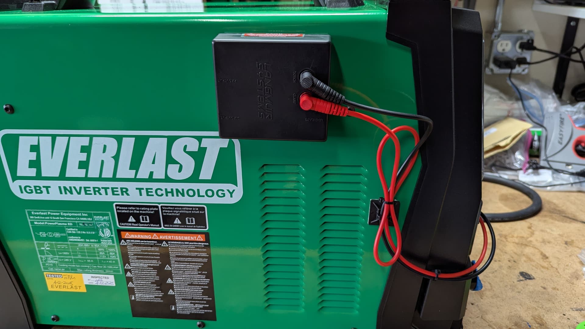

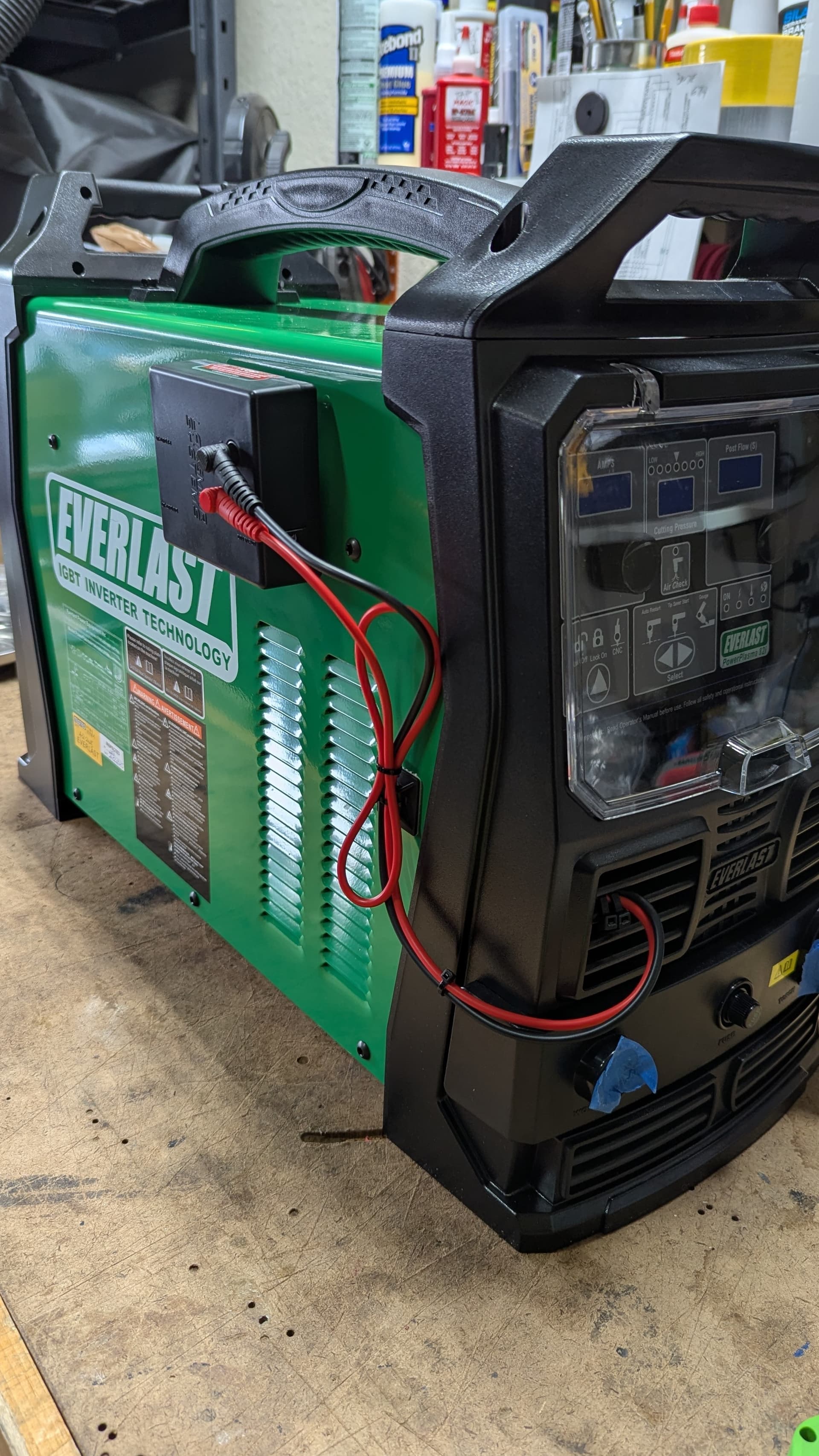

hello i bought a brand new 82i and a used crossfire pro. the plasma is cnc ready which is the best way to hook up the system. any pointers are appreciated thanks Jon
You will need to look up the instructions off of the Langmuir main website.
You want to hook up raw voltage off the plasma cutter to the Vim box on the plasma table.
Then use the CNC Port connected to the control box to fire the torch on and off.
This. Only use the CNC port for the on/off signal.
DO NOT use the CNC port’s reference voltage for the THC system. Go straight off of the main outputs
The 82i has a 50:1 voltage divider, stock. Why wouldn’t you use the CNC port? I’m about to start wiring for my 82i, so this is of keen interest to me.
Just wire it for RAW voltage from the terminals for a lot less trouble. CNC port for the trigger wires is OK.
Thanks, @mechanic416 This is my first CNC plasma and I’m trying to do things right the first time. I have read a few posts about inconsistent performance when using the Everlast CNC port voltage signals, but nothing real definitive. A lot of variables there. Bad solder connection, wires picking up other EMI, etc.
Hate to open up a brand new machine and likely void the warranty, but the direct wiring seems very simple. Besides, I’m not thrilled about having to solder onto those microscopic pins on the CNC connector. So, the less pins I must solder, the better. I have one of those lighted magnifying glass things on an arm, but it’s difficult looking through that and using tools. Might be easy if you do that everyday but I sure don’t.

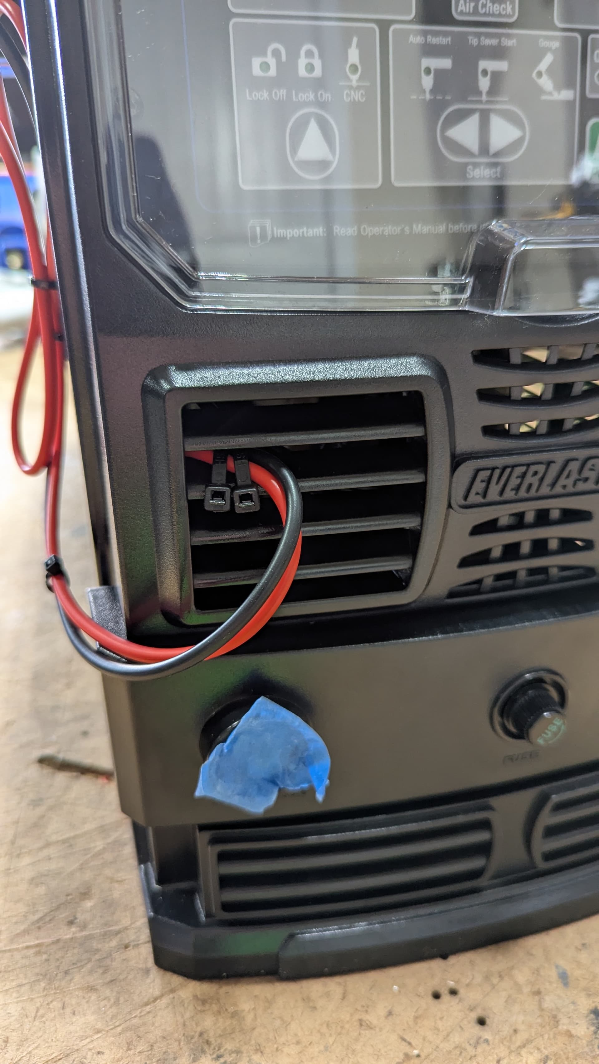

Your not going to void the warranty. Just run the wires through the air vent holes.
Thank you. I’m in the process of doing that now, in fact. Trying to figure out some strain relief for the wires beyond zip-tying them to the air vent slats. I’m toying with the idea of drilling a hole for a gland/strain relief. But drilling a hole in the front fascia will 99.99% void my warranty. It will likely be zip ties for the win. Zip ties and duct tape have held my life together for years now.

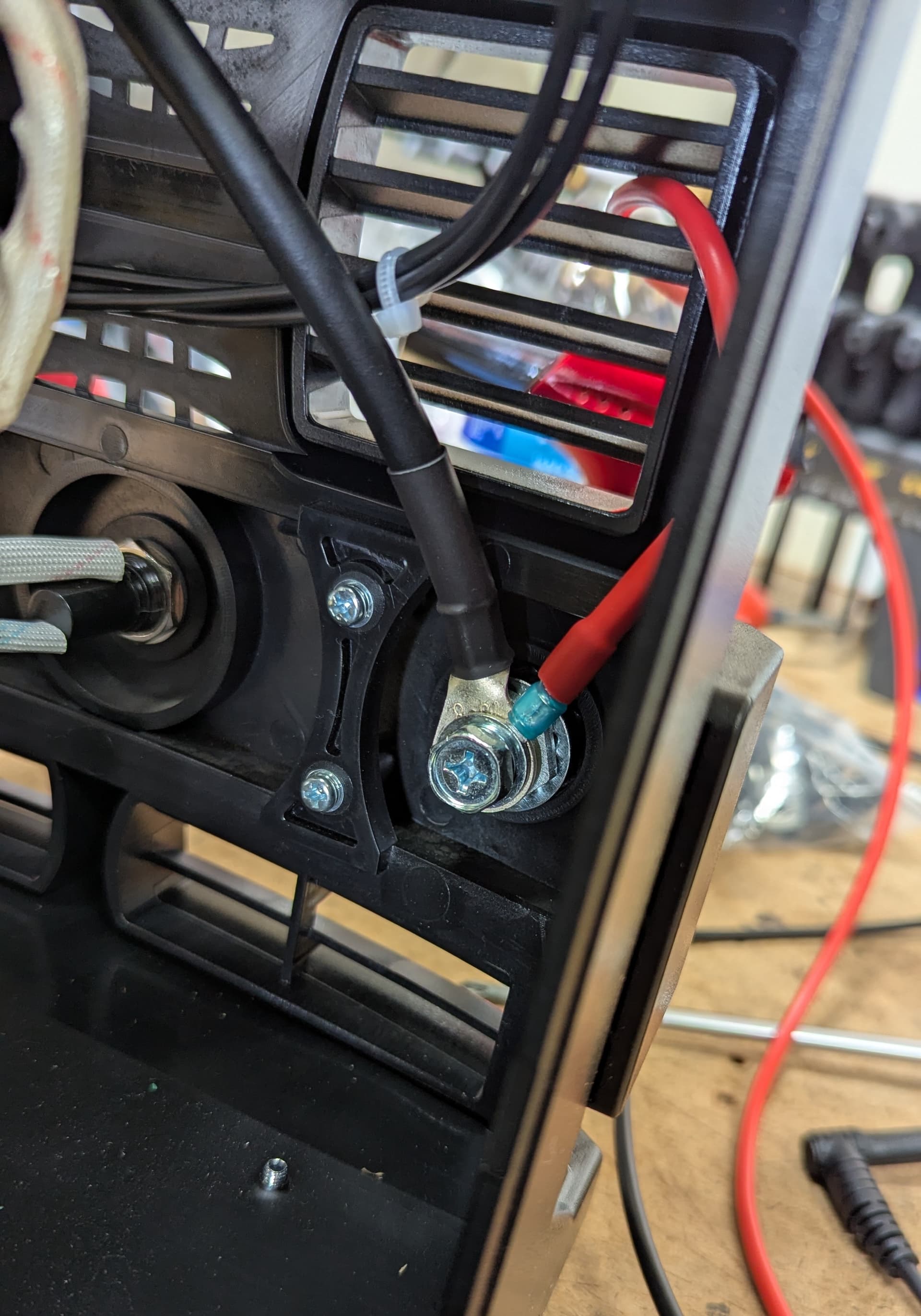

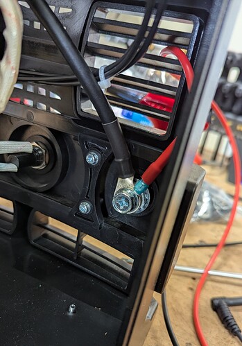

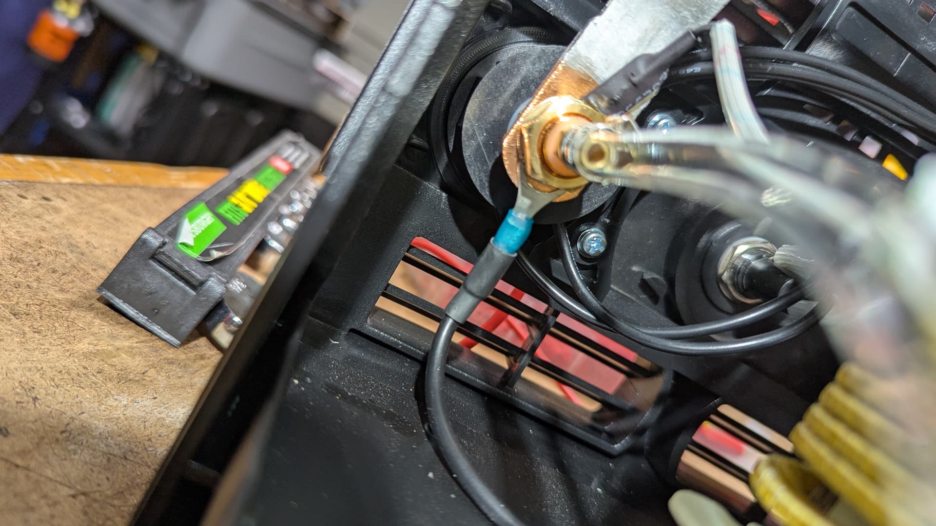

And done. THC is hooked up to the 82i via raw voltage. I chickened out on my idea to run a gland through the front panel. I’m just not going to drill a hole in my brand new plasma cutter and void my warranty before I’ve even used the thing. Maybe later though as the wires running through the front grill triggers my “that don’t look right” anxiety.

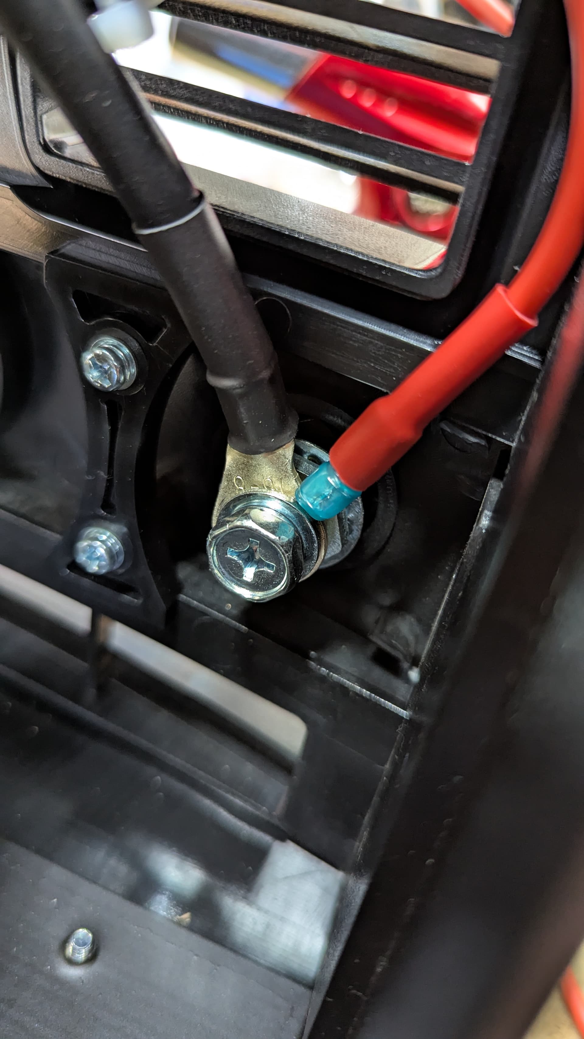

The black/positive lead is more secure than it looks. That is a large ring terminal with just the top of the loop cut off so it fits around the bolt.
The silver nut on back of the positive/clamp bolt is 13mm and it’s stupid easy to get at with a socket and short extension.

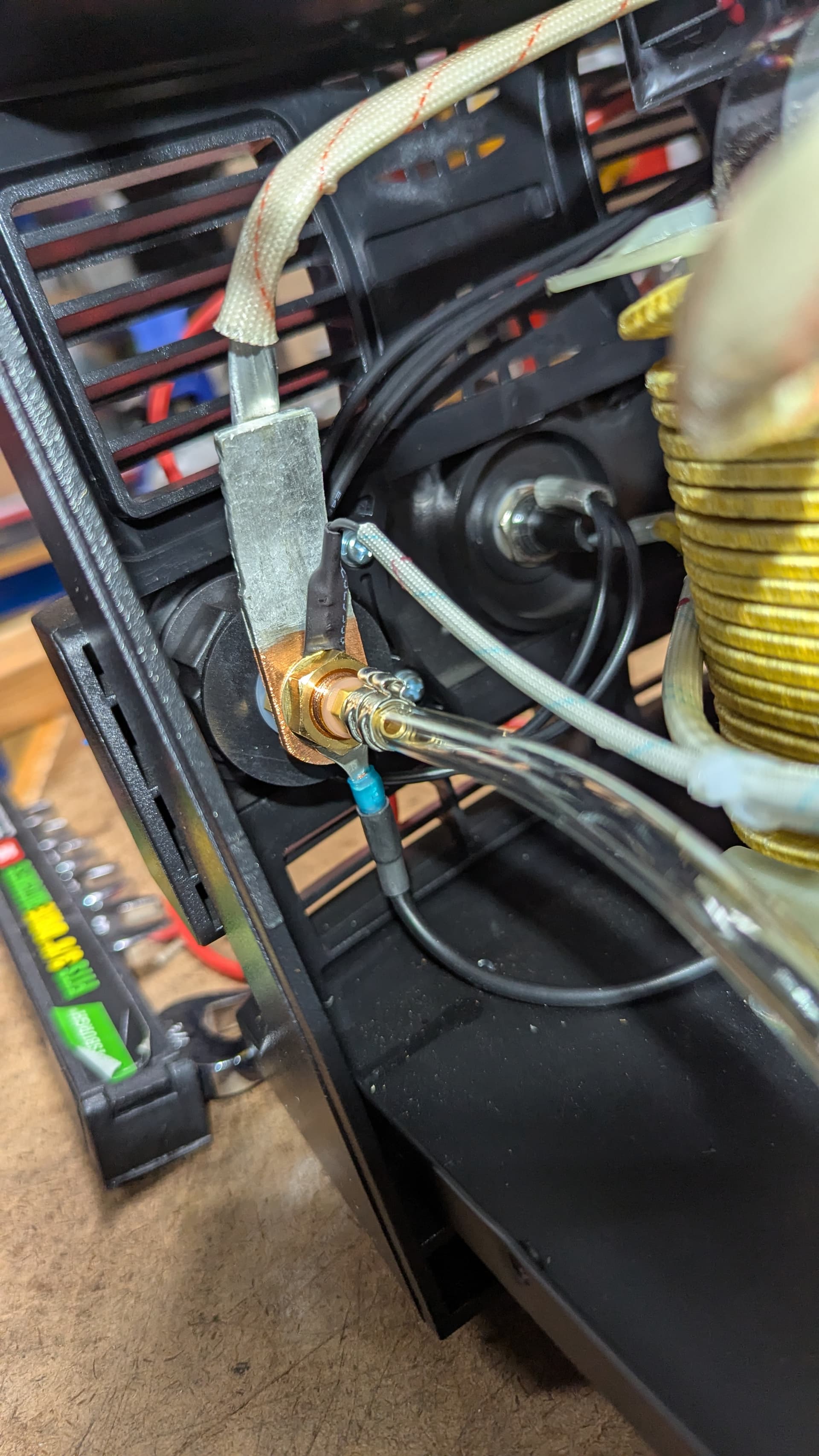

The negative/torch lead bolt is a different story. It is 11/16" (or that is the wrench size I could fit on it) and unless you want to risk breaking stuff by using a pair of Channel Lock pliers to get it off, you will need a crow’s foot wrench. That connection is easily visible but not so easy to get your fingers in there to turn the nut.
I can count on one hand the number of times I’ve used my crow’s foot wrench set in the past 5 years. Today was one of them.
I thought about trimming the THC leads to length for neatness, but I decided to keep them long in case I ever need to disconnect and re-run them for any reason.
Oh, because someone will ask: The blue painters tape over the lead connections is to keep dust out while the leads are disconnected. Yes, I do in fact OCD a whole lot. :smiley:

Yup. :smiley: I looked at your pictures and was surprised at how easy it was to connect directly to the torch/ground terminals. I’ve never opened up a plasma cutter before so really didn’t know what to expect. On a scale of 1 to 10, this was squarely a 1.
Most people using a plasma cutter have some technical skills or background, so taking off a bunch of screws and putting in a couple of wires is easy stuff.
Thanks for sharing your pics, BTW.
