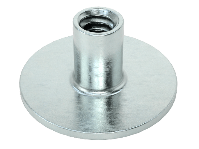

One future interest is in fine detail with thinner material like .05” aluminum and steel with numerous .14 holes to mount standoffs. I can go larger holes and use weld nuts or threaded inserts and glue them in place with JB weld. Point is would a fine cut tip show an improvement to drop $1475 more on the 62i bundle for crossfire pro. I’d rather spend more and avoid further downtime, keep the 45 as a backup. I want to start the machine and not be stuck watching waiting for failed cuts. I don’t foresee doing much thicker than 1/4 or rarely a 3/8 steel. I cant see a need for more than 1/2 material. Typical for me would be 1/8” alum and steel looking for nice edge detail.

I understand that is why I have options for various inserts. I just need the barrel to clear the inside of the hole and the hole to be on average “pretty good” even if not a perfect circle. I can make the holes a little larger for the barrel, then use a jig to hole 4 inserts in position while while I use UV glue to hold them in place which takes 3 seconds per insert to glue and light up. Once in place I can tighten the bolts and lock the inserts into position. JB weld would be more than adequate for some projects to hold standoffs in place.

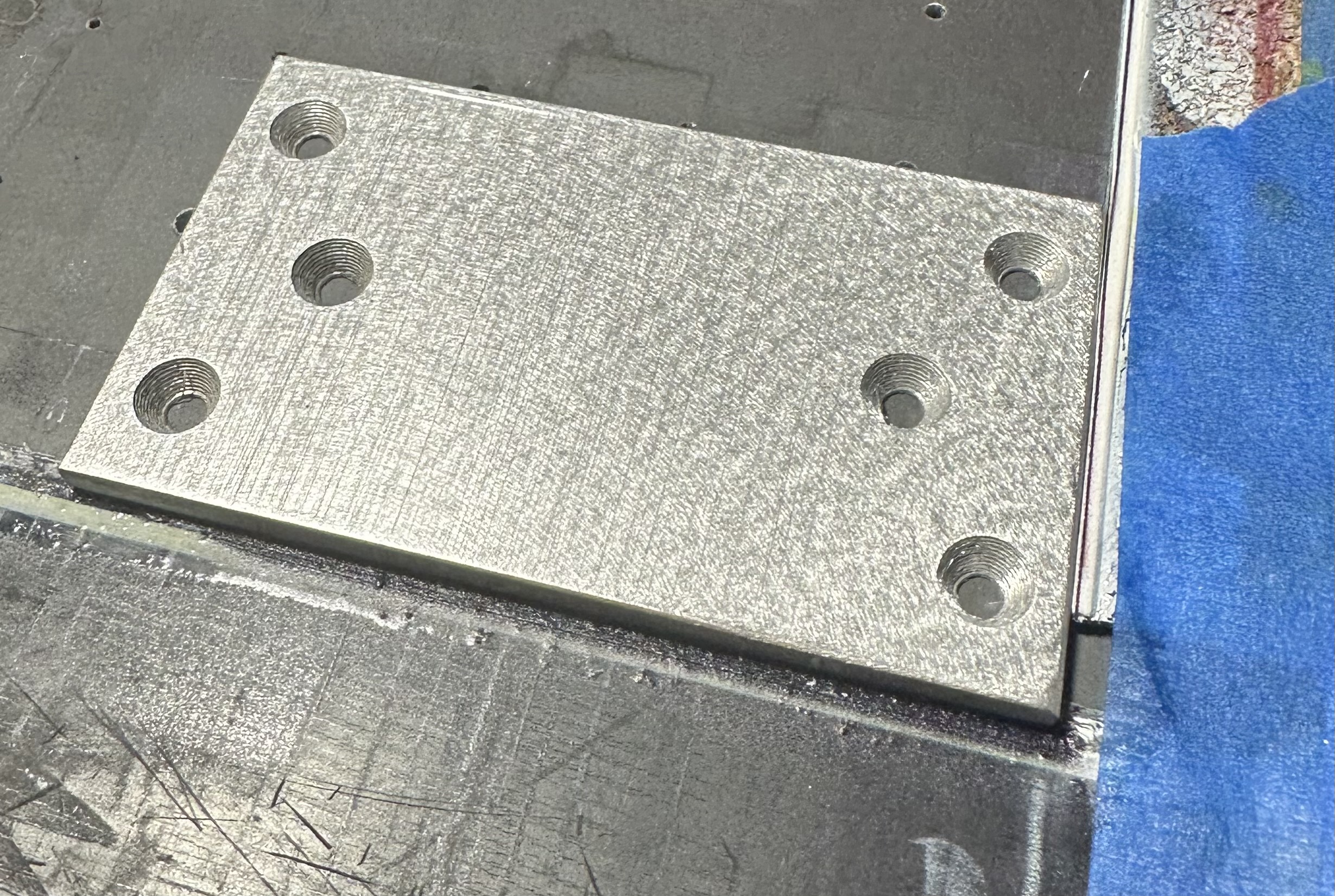

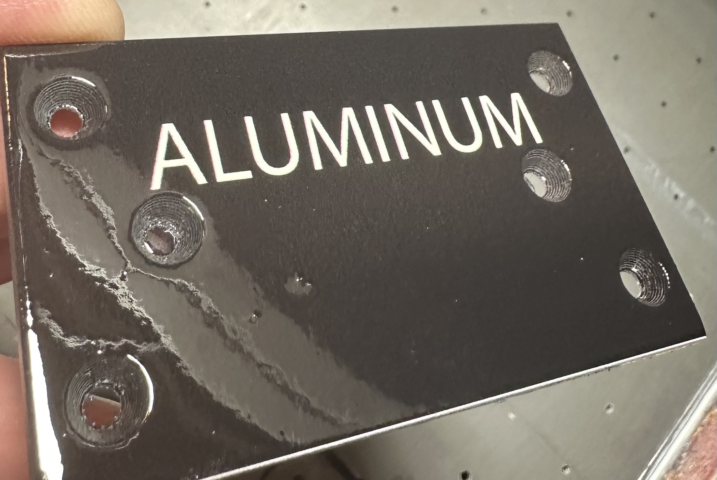

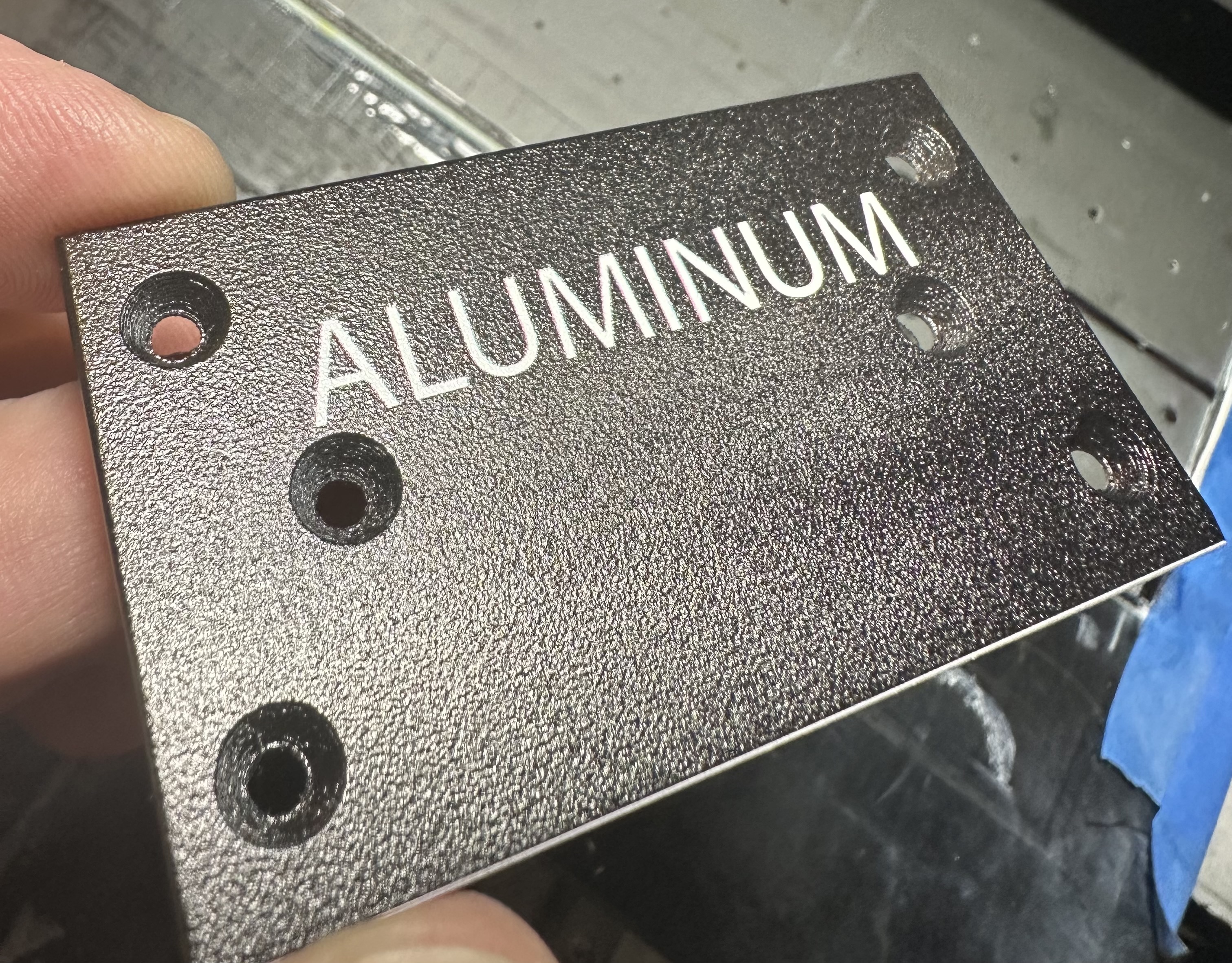

I can Cnc alum but I don’t like the noise. And it’s slow- no coolant system. I was hoping to get decent edges with plasma that can cleanup fast on a belt sander and brief orbital. I can replicate powder coat with my 24”x36” uv printer. I just made a test to show an example. 1440dpi graphics. 1. Raw alum. 2. White base black top layer reveals graphics. 3. Print varnish layer (separate print head )
2 minutes to print this

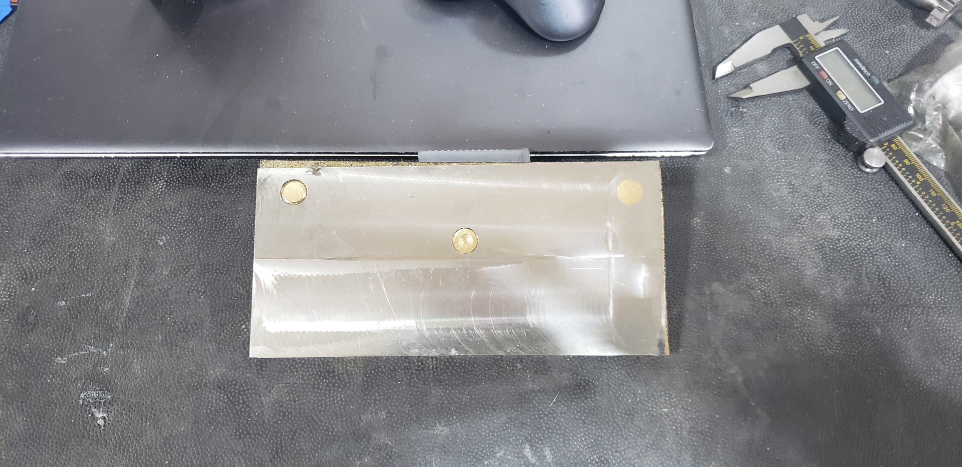

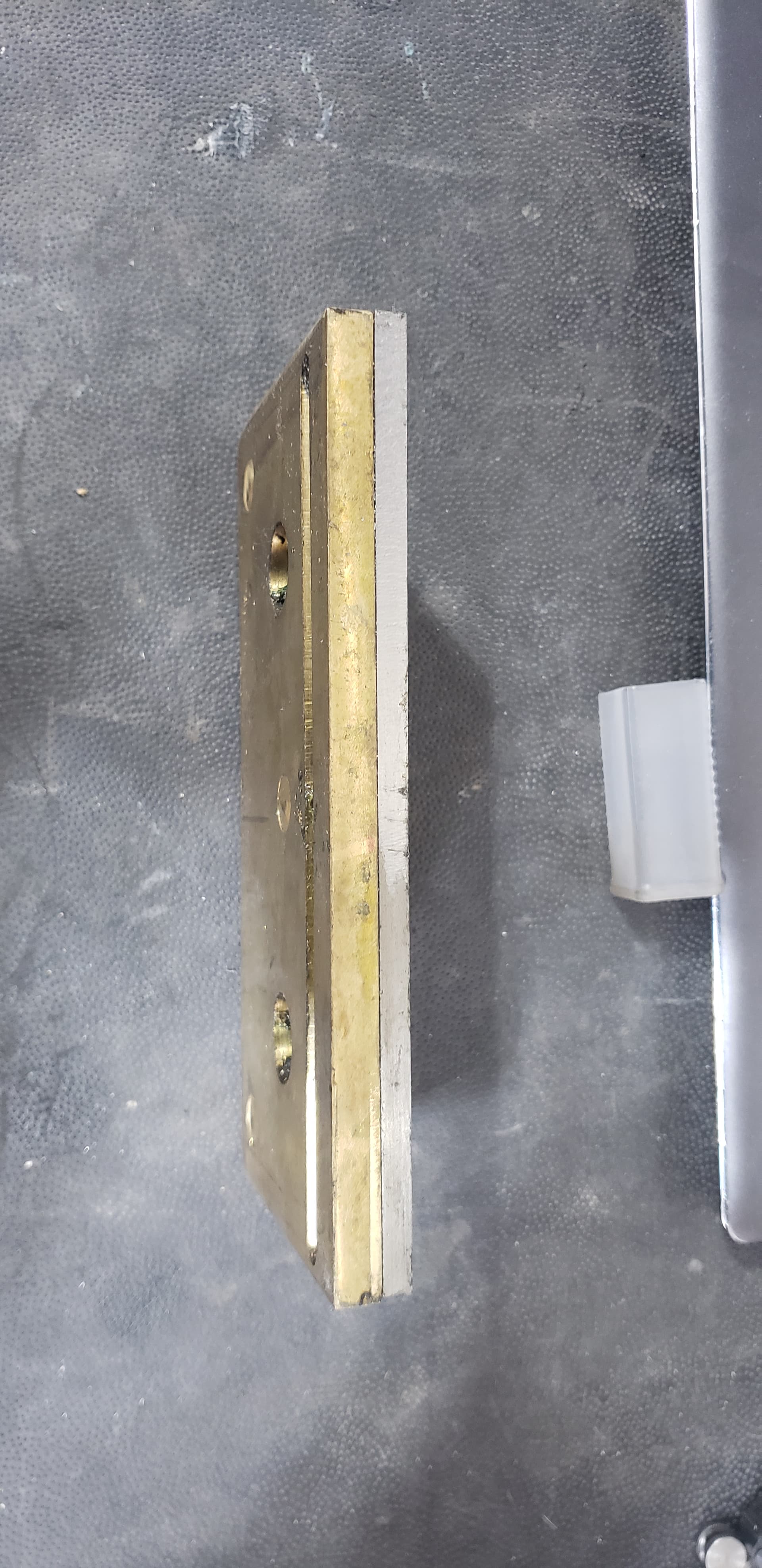

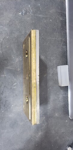

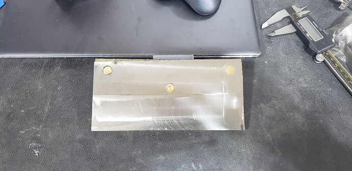

That may be what the destructions say, but this brass plate was bonded to the 303 stainless steel and then machine to thickness . If it needed pressure, it was gravity after I did a twist and slide into place.
