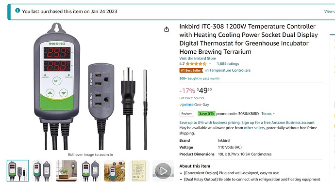

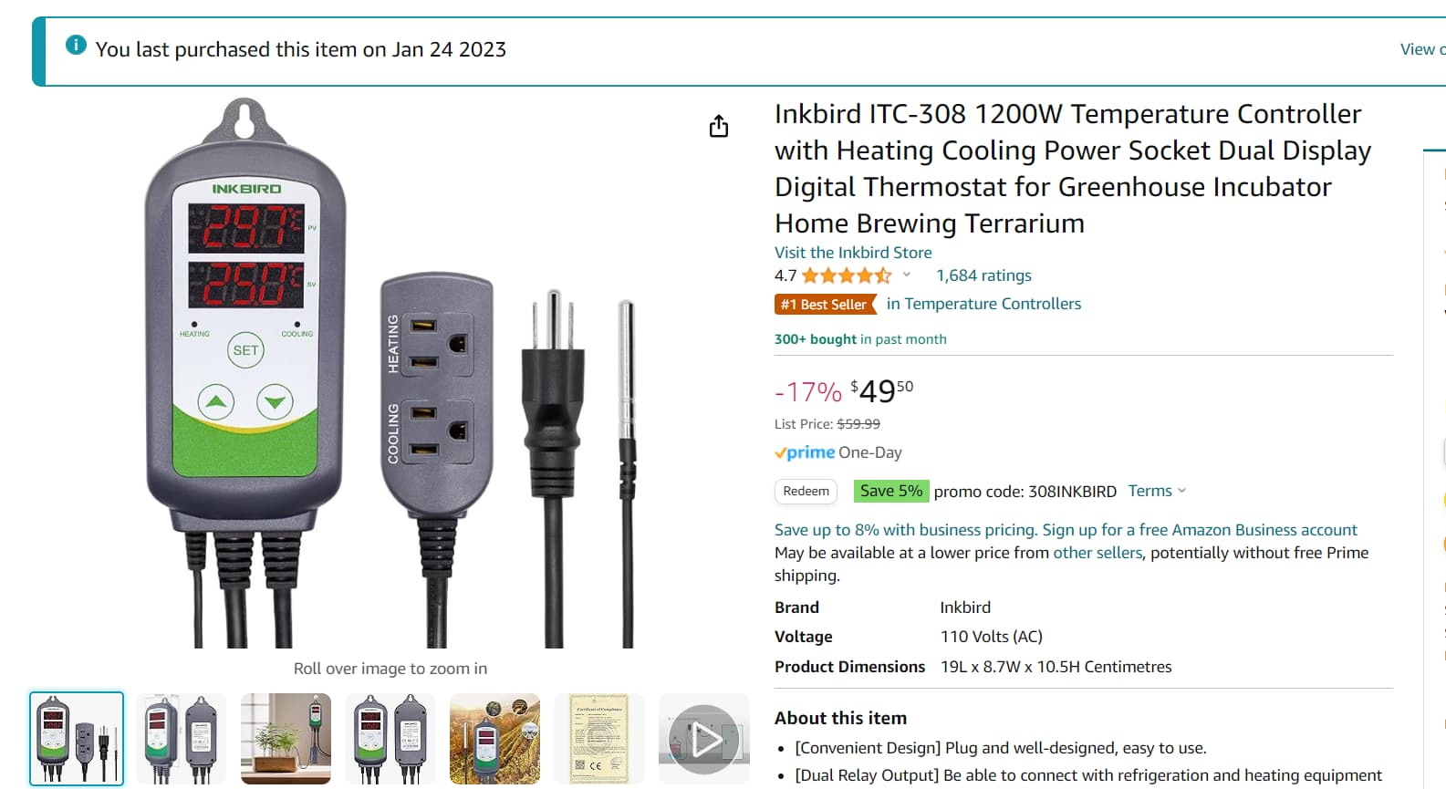

this is a great device to have in the shop…the sensor is real accurate and is handy to have.
I have a couple of them…one is attached to mt copper cooler that turns a fan on and off to cool the copper.
I have another tied into my flooe heating system in the concrete to turn it on and off…
you can use one for a emergency shop heater in case it drop to low it comes on and alarms…
so it would be great to use as an accurate temp reading device…for air temp on pipes…
the problem with the IR guns is they are not very point accurate…
you do not have to use copper…
you can use PEX wich anyone can do…cut and crimp for real low cost…just use 3/4’ pex
as for space you can even mount this on the ceiling if you want…just give it a small slope to drain the water to an outlet…
there are soo many options…
just some ideas…
Great, I’ll go ahead and get one of those sensors.
