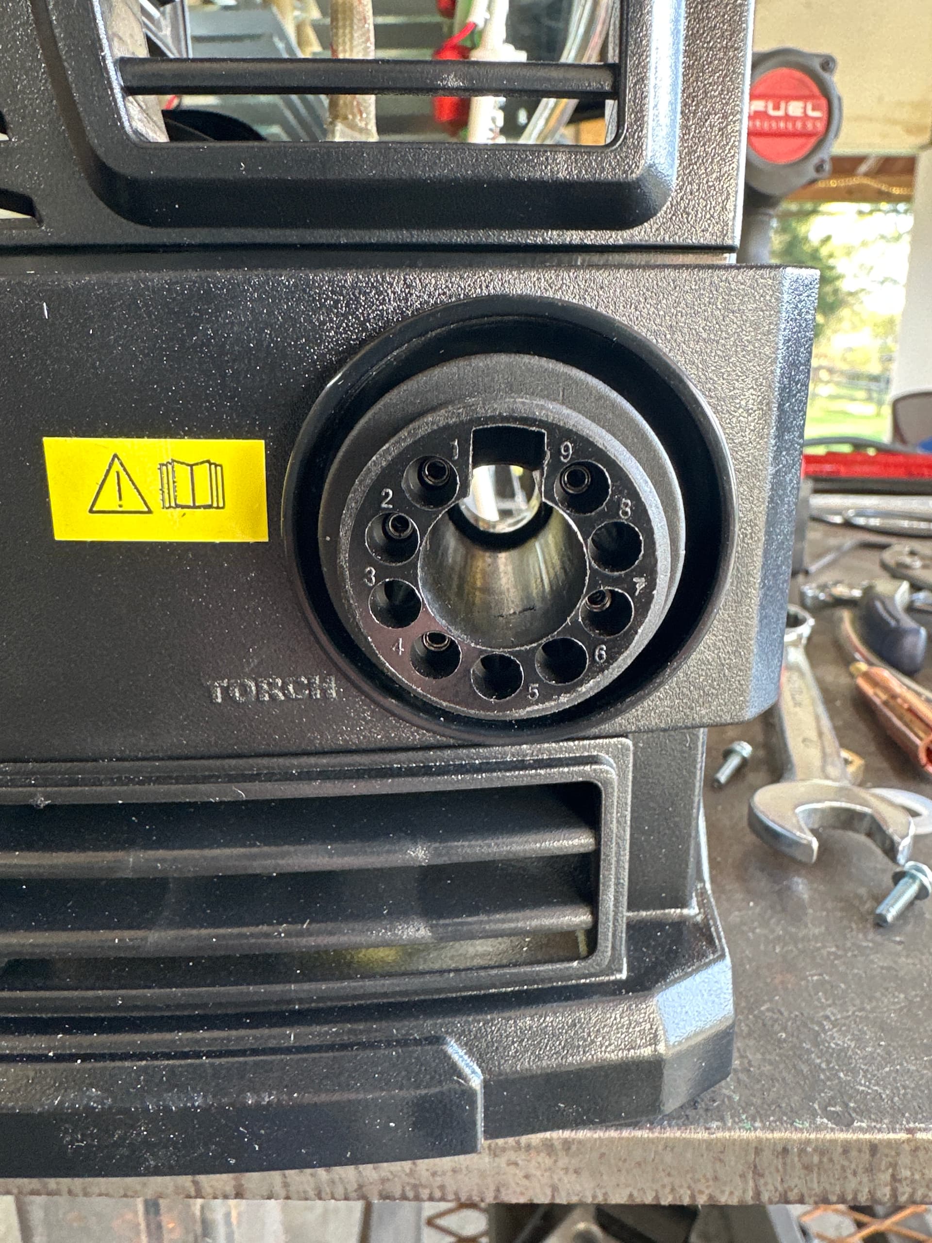

Hello, so I’m sitting here looking at pins 1&2 that I’m supposed to solder too. Do you have any pictures on how you did this? I don’t want to go tearing anything apart I don’t need too. Do I taetyhis all apart and solder onto the back? This is my first time doing anything like this and could use some help. Please
I don’t own an Everlast, but have been told it’s similar to a PrimeWeld.
If pins 1 & 2 are for torch on/off, just solder them to the end of a barrel plug. That barrel plug will then go to the ON/OFF on your control box.
The plug on the back, not the torch connection. Did you get a CNC plug with the machine? You need to open up the machine for the raw voltage connections anyway.
That is for the torch. The cnc port is on the back of the plasma cutter.

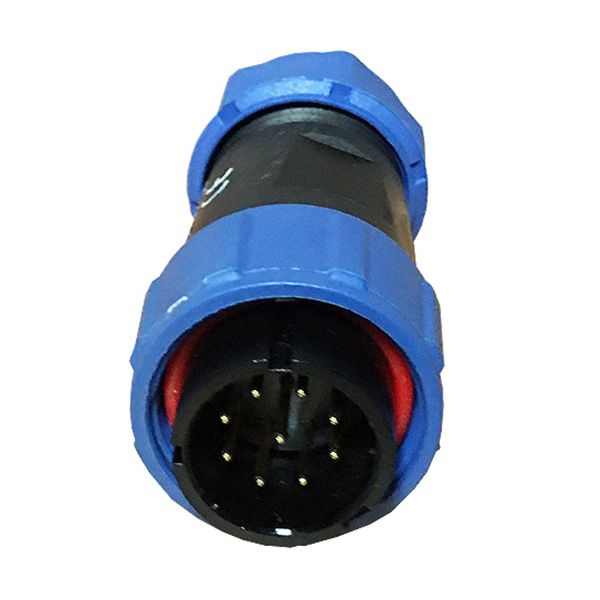

You need this plug. WEiPU SP21 CNC Connector 12 Pin | Everlast Generators
One should have come with the machine
If you don’t have the 12 pin plug let me know. If you pay shipping and handling I will send you one with pig tails soldered in already.
George you’re incredibly kind. Once I get home from work today I’ll let you know. Thank you!

George, i Have the connector for the back and soldered it in. were all good! thank you very much

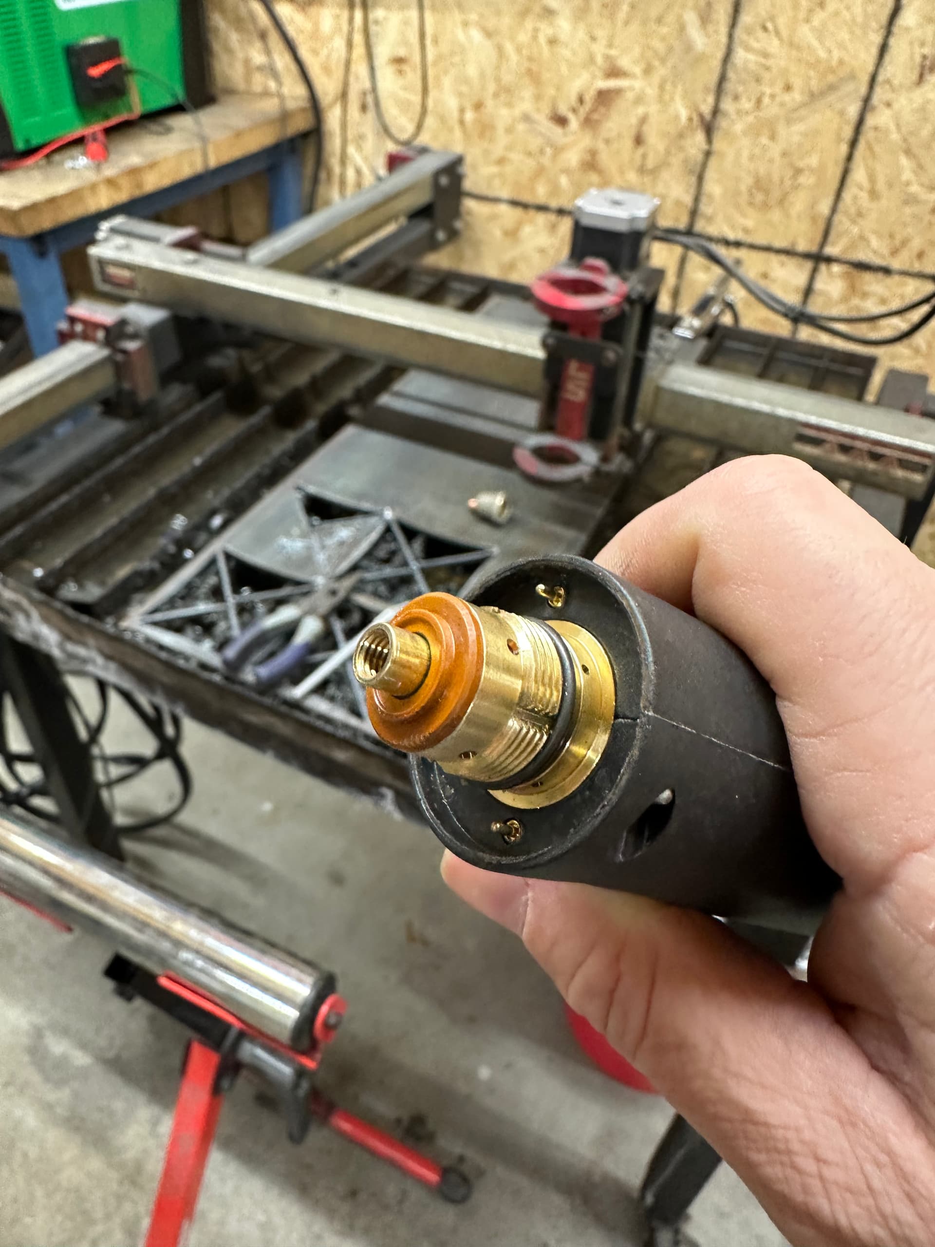

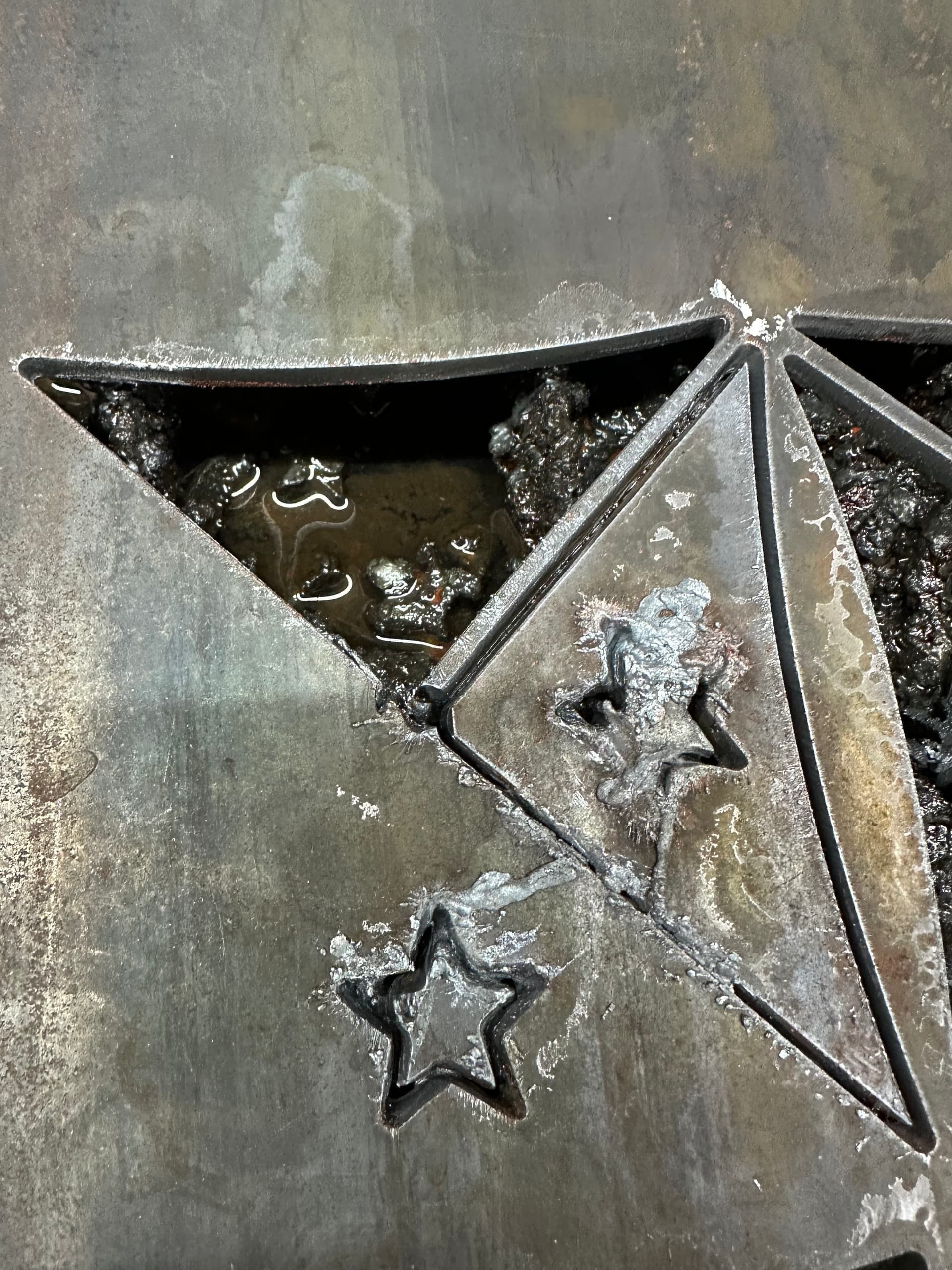

So I ran a good size job, 1/4” plate then switched over to 3/16”. Everything ran good til the last set of gussets, cutter wouldn’t blow through, I assume consumables were done, so I switched out consumables and now the torch won’t fire. Where should I begin checking? Here is a pic of the last cut
Worth noting, machine is clicking as if the torch is getting the signal to fire, I am guessing it’s a ground issue considering it wouldn’t blow through randomly, but I’m not sure what to check first? One time I did have an issue of the torch not firing, I removed the control box cover, gave everything a once over, then it worked. I have a feeling that root issue is still lingering.
Make sure the consumables are installed correctly. Make sure the cap is tight, make sure the swirl ring is not put in upside down. Are you using good consumables not amazon.
