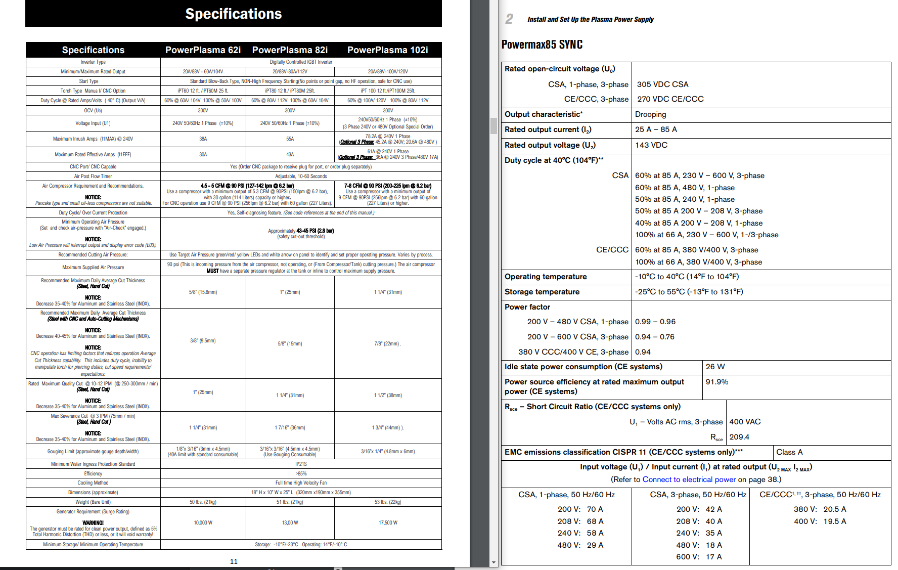

Hey everyone, I am looking at purchasing the Crossfire Pro. I am thinking about buying the Everlast 102i so I can have the versatility of cutting thin material and also have the ability to cut thicker material if needed. I was just hoping to get some feedback of any Everlast 102 owners and see if this is a good thought process or am I looking at it wrong. Any feedback, advice, words of wisdom etc, would be greatly appreciated. Thanks!

Compare the Specs between the Everlast 102i and the Hypertherm 85 sync.
The Everlast is a great machine. I started with a 60s Everlast which worked well but it doesn’t compare to the Hypertherm in actually delivered cutting power and inch per minute .
I probably save 30-40% of my time cutting with my Hypertherm compared to my 60s.

I have a 102i with a hand torch for cutting stuff on the welding table. 82i for the Crossfire. The big limitation will be the 102 needs a 80 amp circuit on single phase. 60 amp on three phase. For most people in a small shop that’s half the circuit panels amp rating. Now if you have a 200 or 400 amp panel than go for it. Its a great machine.

I have run my Hypertherm 85, Everlast 82 and 102 on a 50 amp circuit and cut a lot of thick metal and have never kicked out the breaker. May be because I was not using it continuously for a long time.

Looks like the hyperthem 85 just edges out the everlast 102
12,000 watts for the everlast 102 vs 12,155 for the hyperthem 85.
