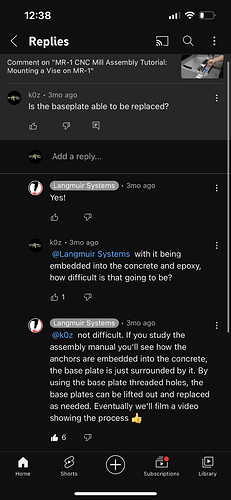

If you add the epoxy coating, is it possible to replace the aluminum base plates at some time in the future, if needed?
I don’t think Langmuir has posted any details on how to remove and replace the base plate, it may be as simple as pulling all the screws that holding the base plate in and milling the old base plate out.
I don’t see the epoxy being a problem even if you had to use a right angle grinder to remove it around the plates perimeter and touch up after the new plate is installed.

While in theory you could replace the plates by removing all the base plate to anchor bolts and prying the base plates free, from a practical sense, it will be a challenge. The base plates have a bow to them, so the anchors that will remain and the concrete around them will have the same bow. Also, the sides are not precisely square to the 2x2 or anchor bolt pattern, so once you get past the bow, there will be a lot of fitting of the plate, then once it fits, transferring the anchor bolt pattern, then use the MR-1 to recreate the 2x2 pattern.
It would be best to consider the baseplates permanent and treat them as such.

“Not difficult” may be an under estimation. The cement on the bottom of my plates was very well attached. also the rough edge around the plates didn’t help. Having some sort of pulley or lift to pull on the plates may have made it easier, but I didn’t have access to those tools.
Would you be willing to share pics of what the pocket looks like?

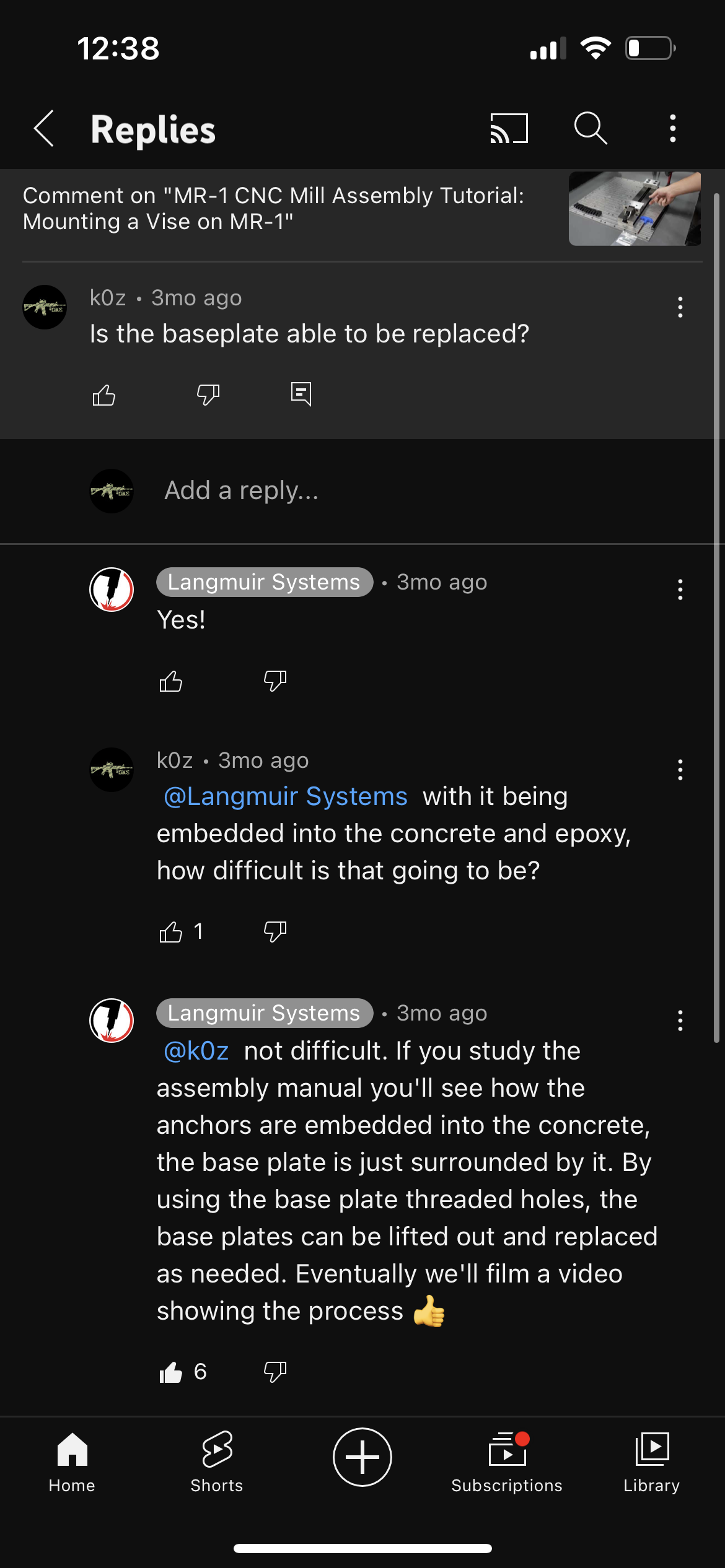

Langmuir’s words not mine.
It was said earlier Langmuir hasn’t said anything or much about it. And I was just sharing as I had the same question, and Langmuir did speak on it—albeit loosely.
