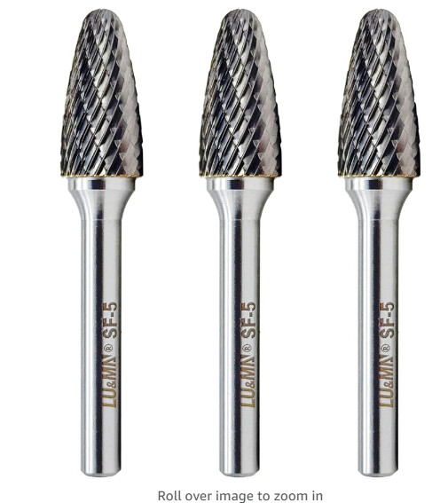

I did get some of these rotary carbide rasps for the future but have not really put them to the test:
https://a.co/d/4w9E9Zr
