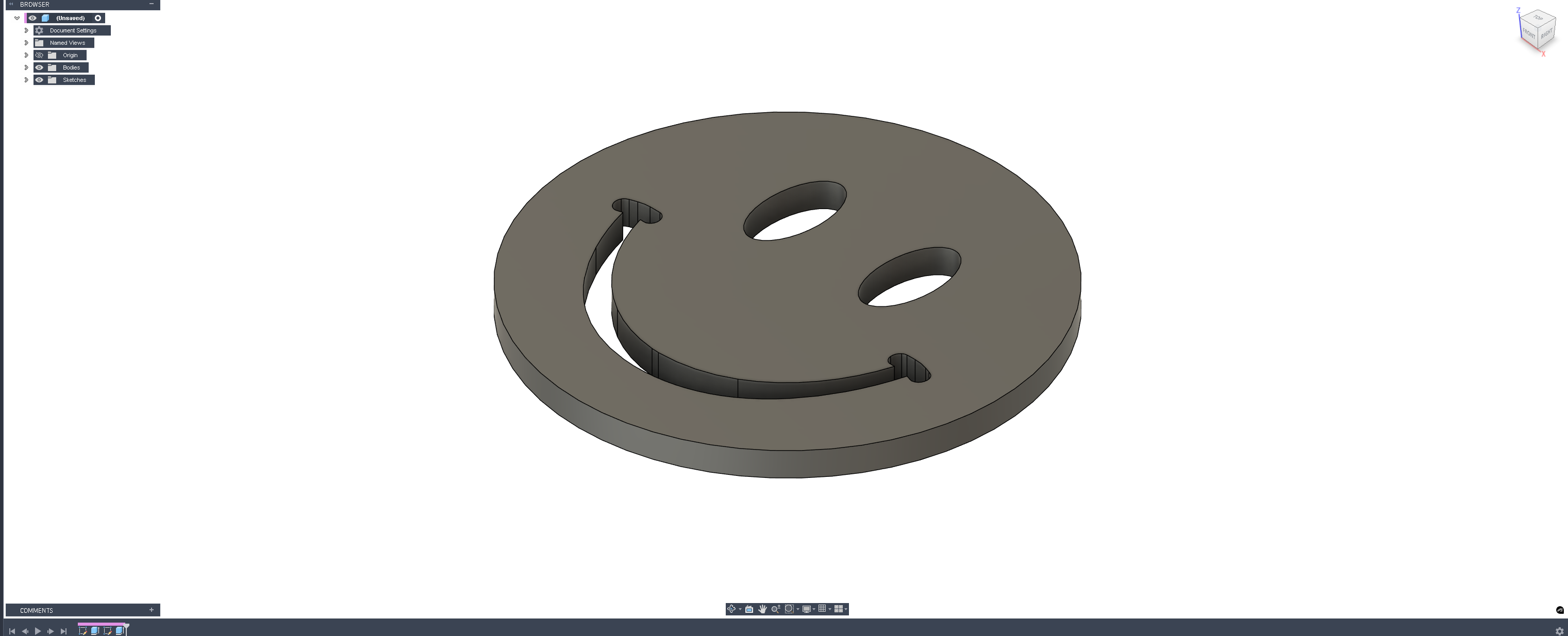

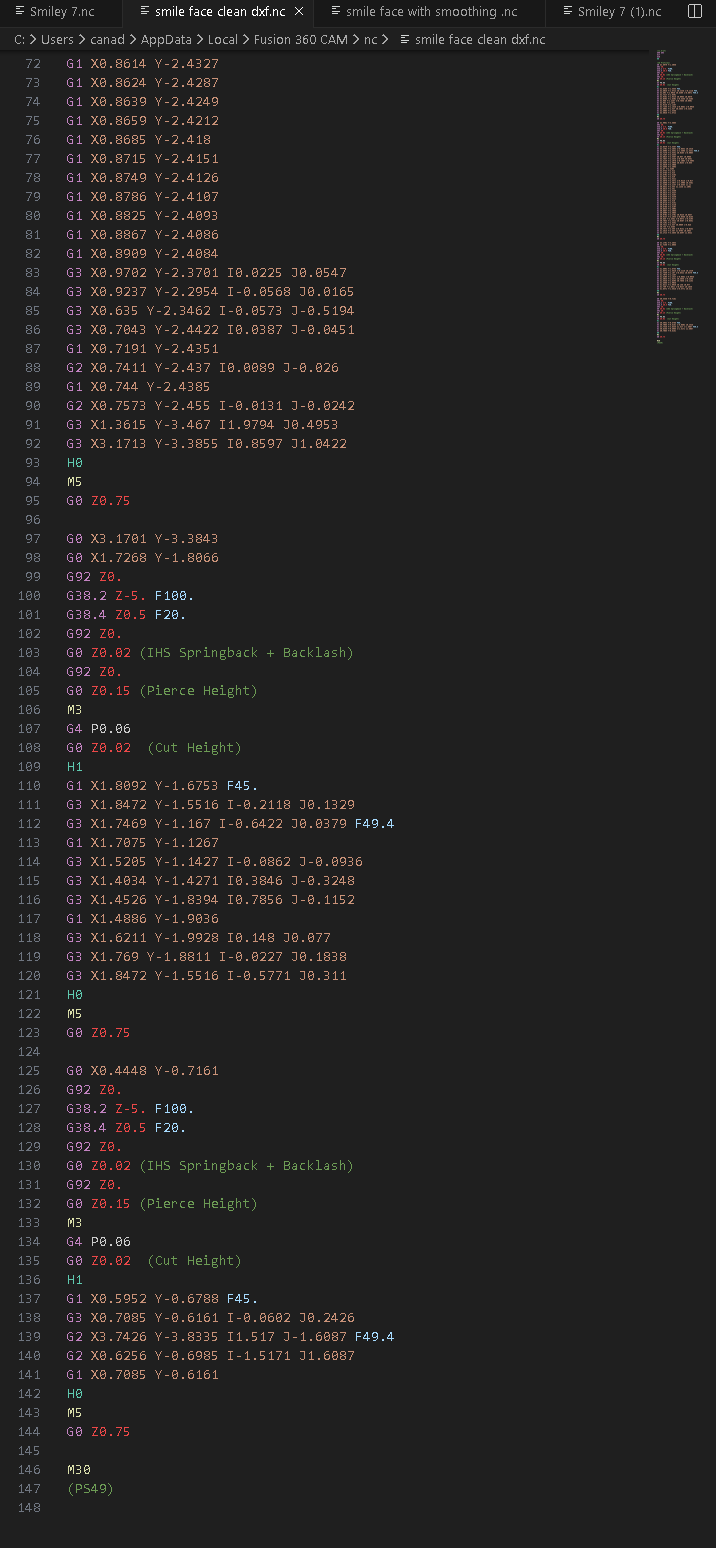

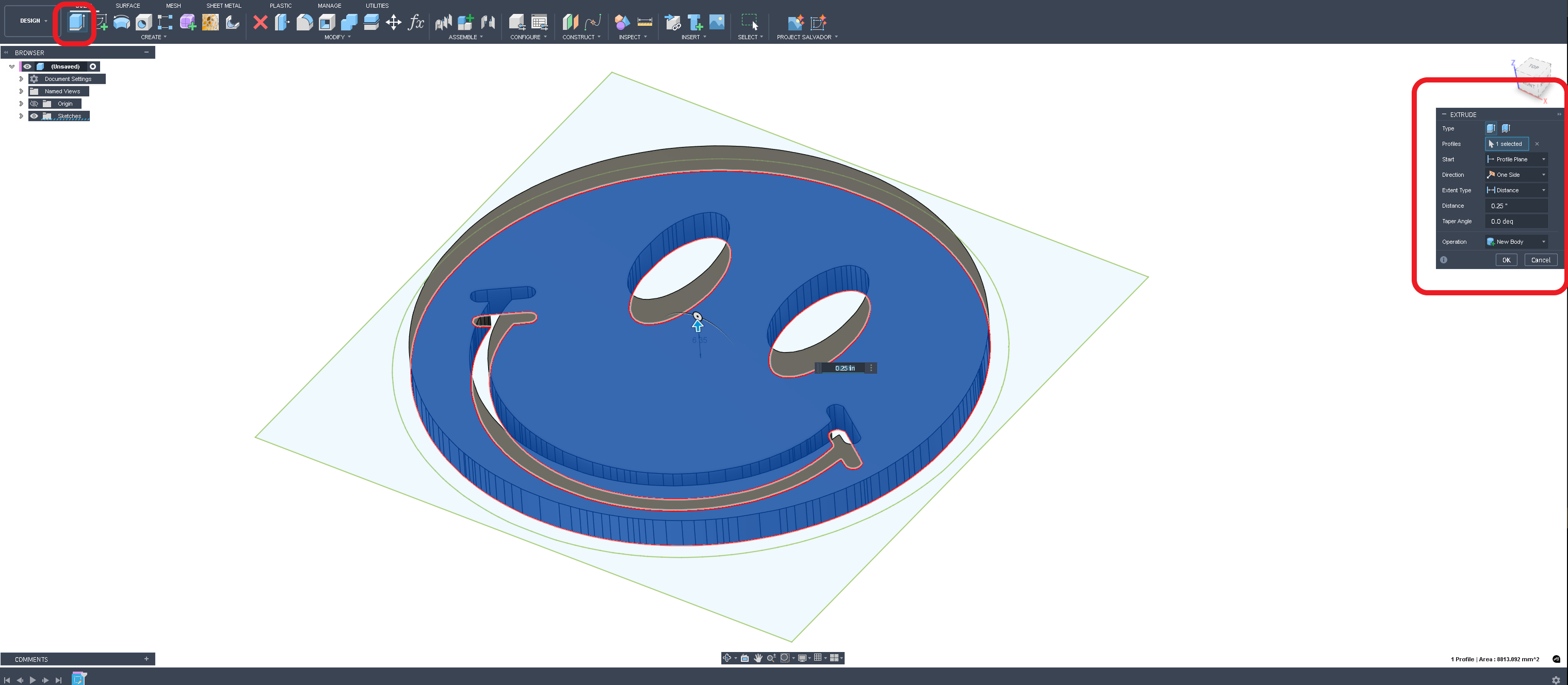

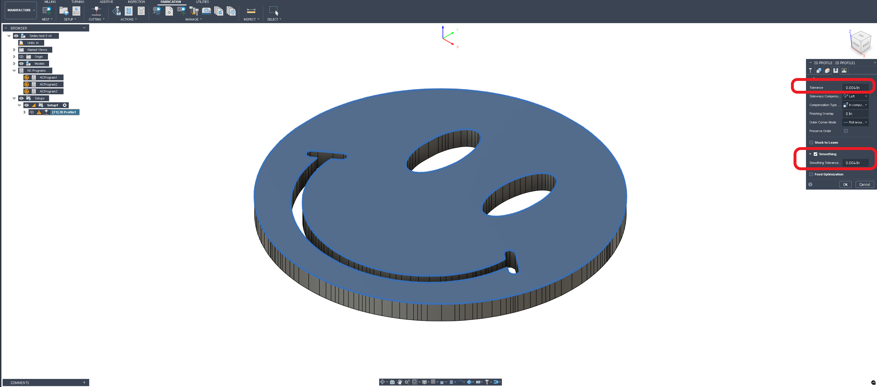

Another comment to add is try to use clean geometry.
You can see the SVG you used is very dirty and faceted.

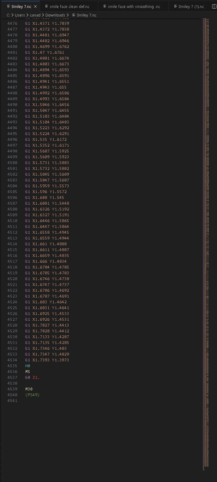

And by the time you’re generating your G code it’s putting out 4541 lines.

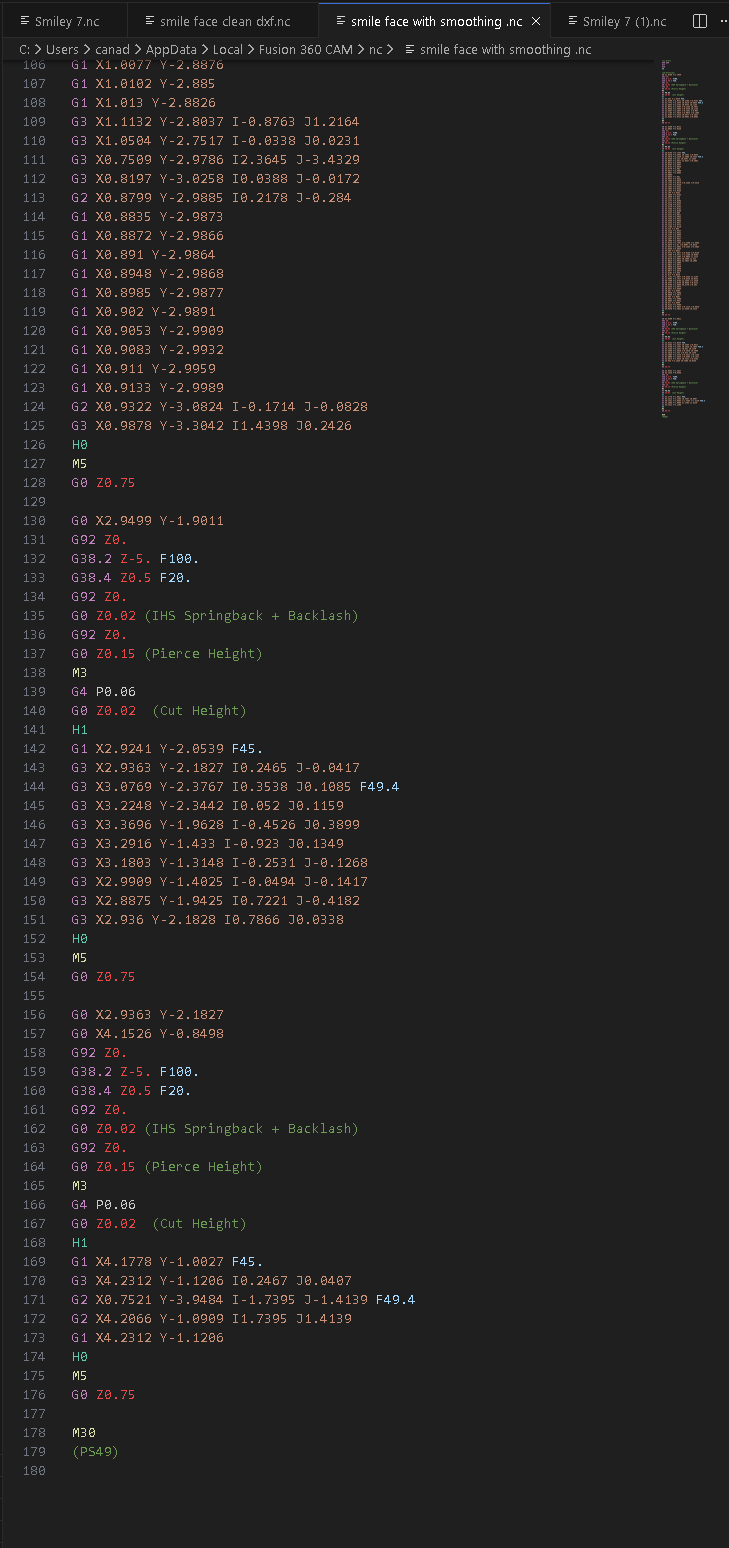

If you add smoothing you can reduce this by a huge margin now it’s only producing 180 lines of code
if you were to use very clean geometry to start with it would only produce 148 lines of code.

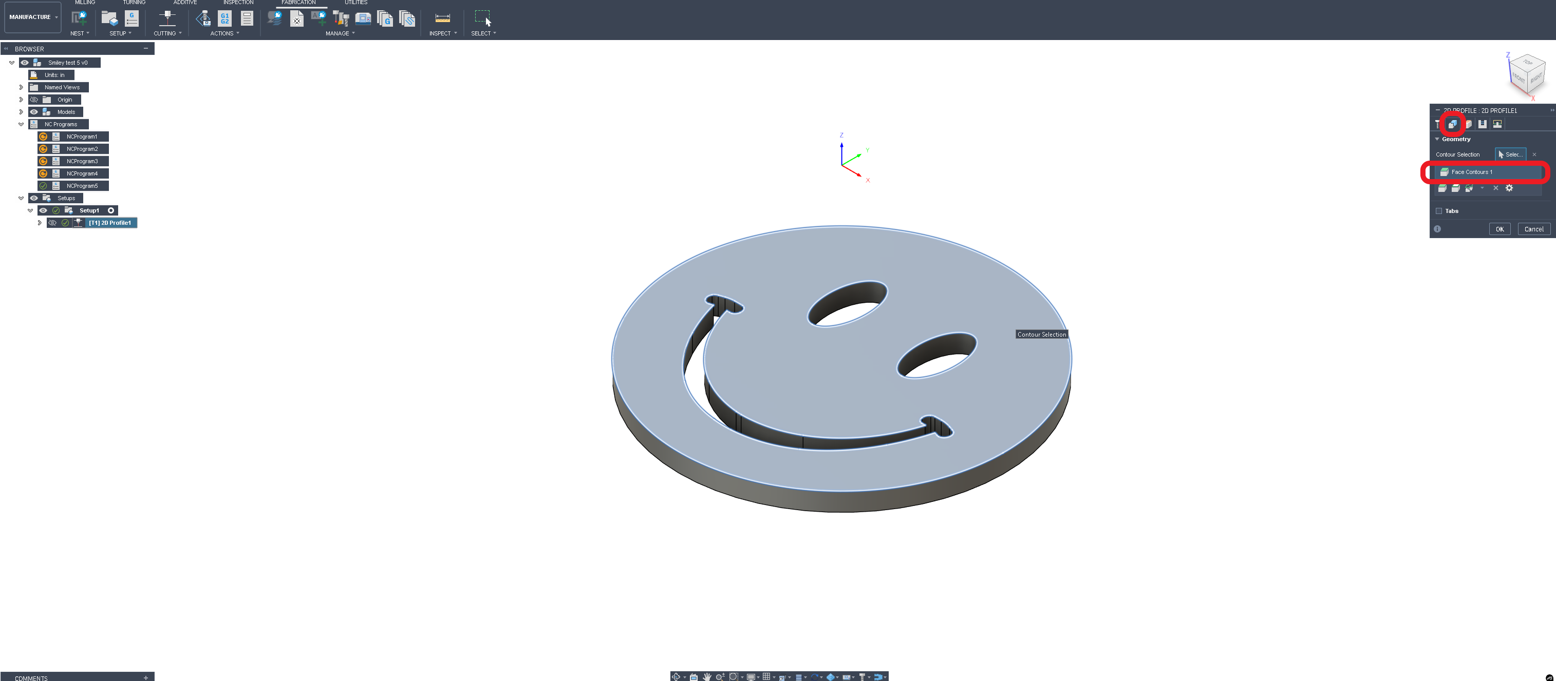

Here’s a screenshot example of how extruding is done
And I’ll reiterate the point of extruding your geometry into a body and then pick a surface face makes it far easier.
and here’s an example of looking at the side facets and how irregular the geometry was it’s way more evident when you extrude it.
See how many facets there are. This screenshot also includes where you can apply smoothing
and this is an example of a body extruded from a clean sketch. Very few facets only where you need them.
You’re trying to get clean geometry but your plasma torch is trying to jerk around and follow every one of those facets you’re gonna have a tough time achieving clean smooth cuts.

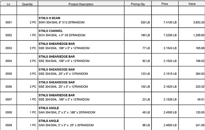

I agree.. stainless at my regular supplier has gotten really nuts.. If you happen to be around northeast US - Penn Stainless Products has very reasonable pricing. Depending on mill origin, and tariffs they have to pay their pricing by pound for the stuff I ordered is as low as $2.1515/lb. But I also ordered some crazy expensive SS structural beams for a project at $7.41/lb
2 PC SSE 304/304L .25" x 6" x 12’RANDOM weighs total 123 LB at a price of $2.1515 LB for a total of $264.63. This would make your 12x12x0.25 about $22 USD. I don’t have any relationship with them.. they are just a surprisingly reasonable and very nice SS supplier.

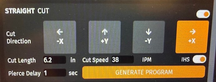

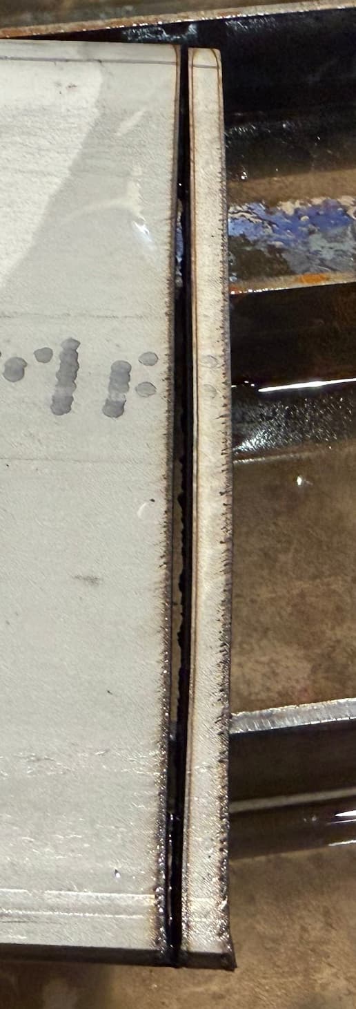

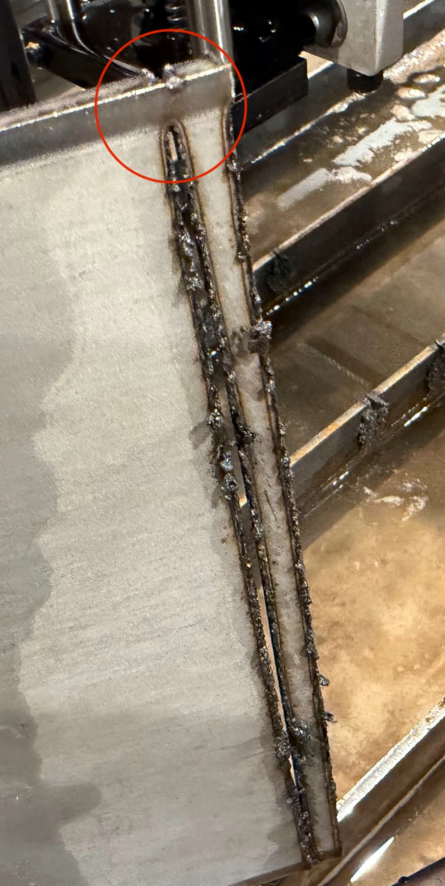

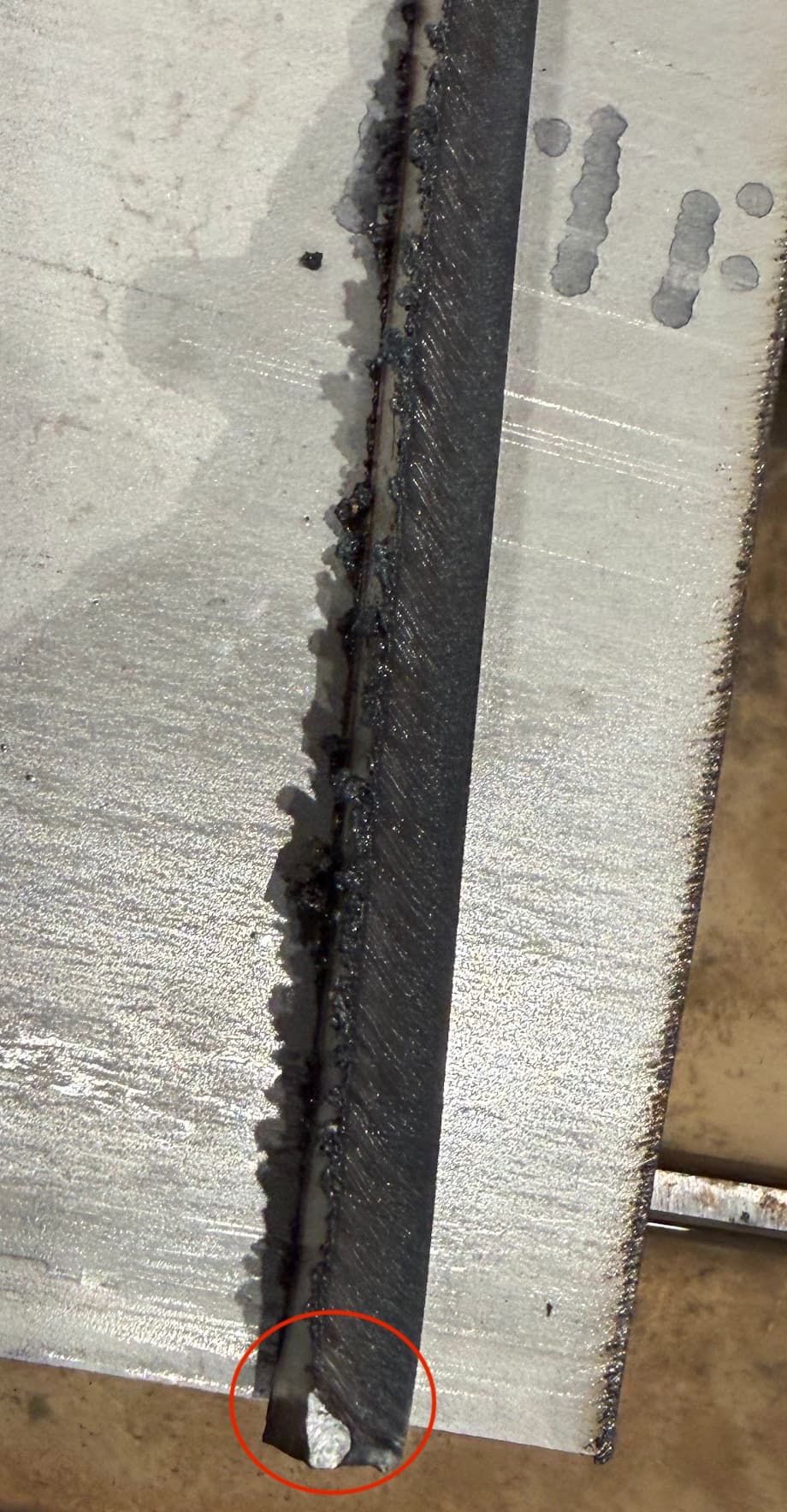

I tried a simple straight cut. same material. The top looks ok.. There is a fair amount of dross. But the biggest issue is that it is not cutting through the end.. I noticed the same on the smiley. The material is 6.0” and I started at the leading edge with a cut length of 6.2”.. likewise on the smiley I used the overlap feature and overlapped by 0.25”
Any ideas on :
  • How to get it to finish the cut?
  • Does the Dross tell you anything about my settings with regard to speed, pressure?
I did confirm that the plasma is maintaining 72 PSI while cutting, and I have it set to 45A.
I am going to take a stab and answer my own question… looking at the side profile it is angled backwards by like 45 degrees, so I gather that my speed is just too high at 38 IPM..

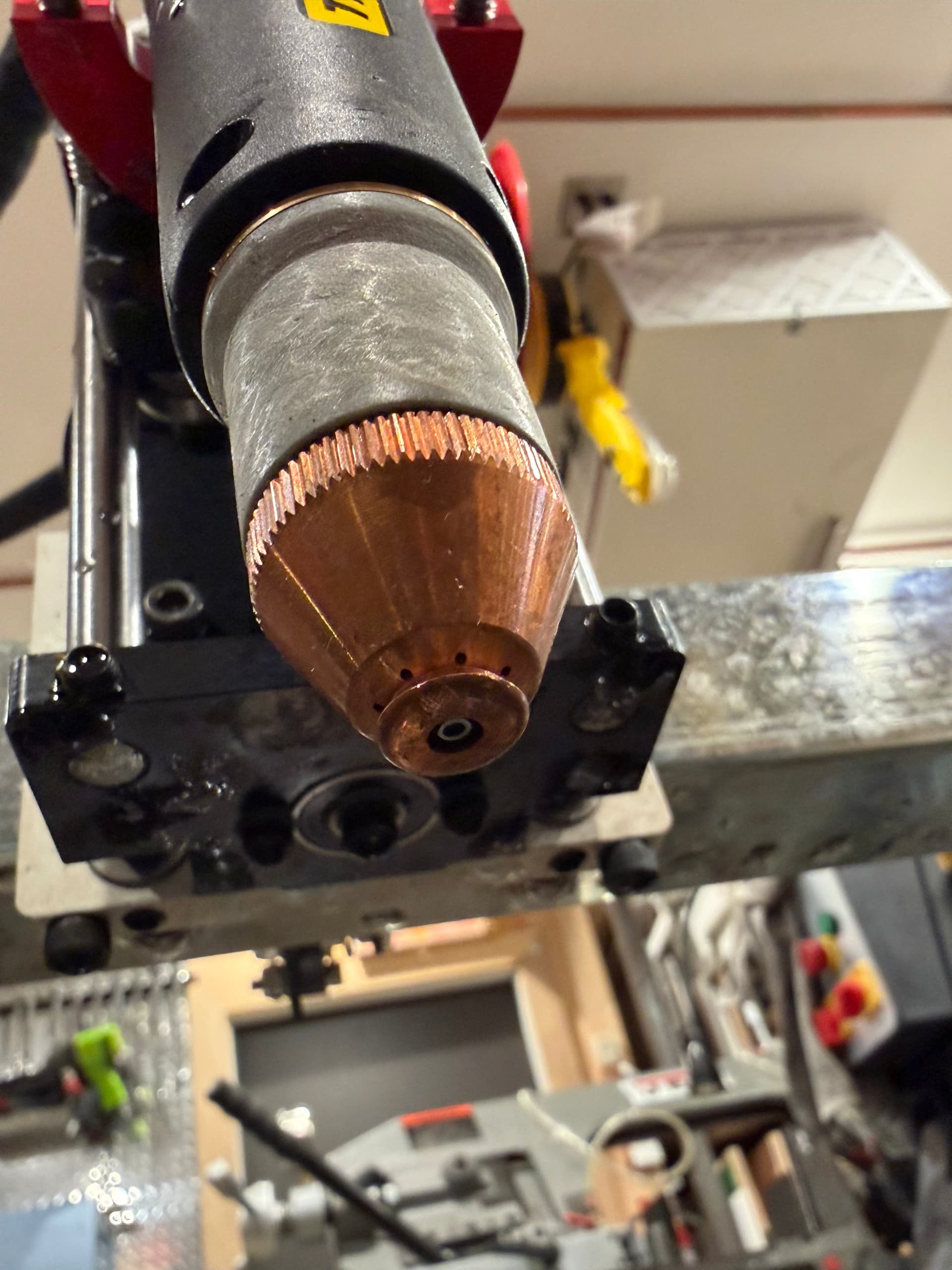

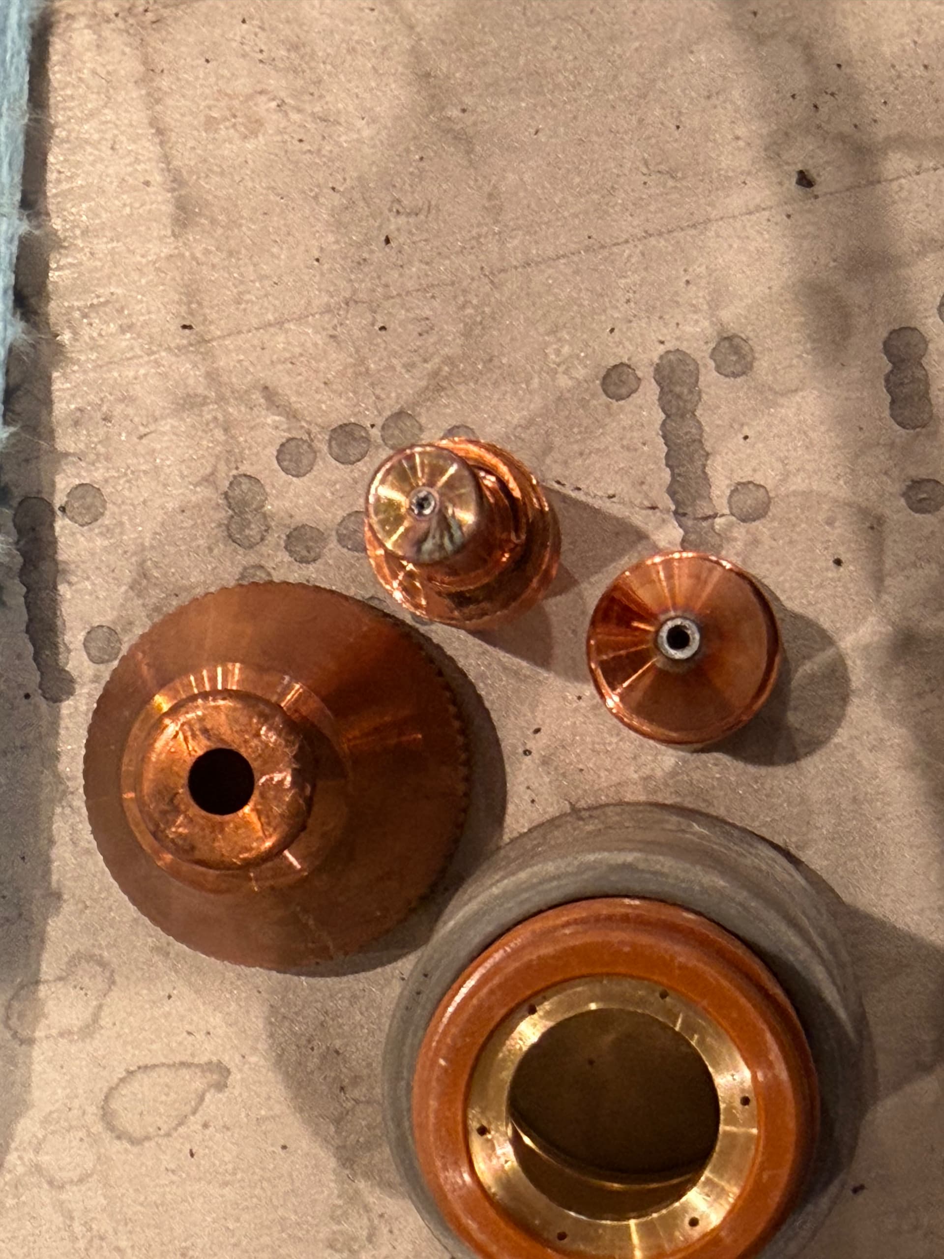

Take a picture of what your nozzle looks like and post it here.
Here you go.
