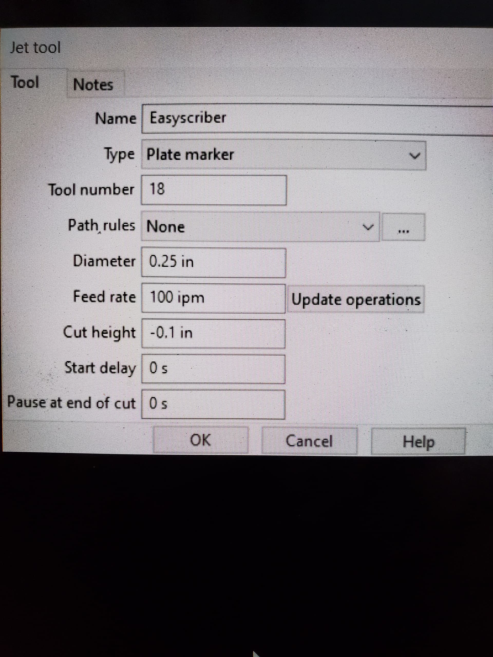

For those who have gotten the EasyScriber attachment for the Hypertherm, what are your settings for SheetCam?
The settings listed by EasyScriber do not seem to work.
And yes I did look around the forum, didn’t find anyone posting settings that are confirmed to work.
              I use the Easyscriber with the Hypertherm 45xp.
I have used it only on hot roll mild steel. Get the p & o hot roll so there isn’t scale.
Have a couple of AL 3003 projects to scribe, but haven’t gotten to them yet.

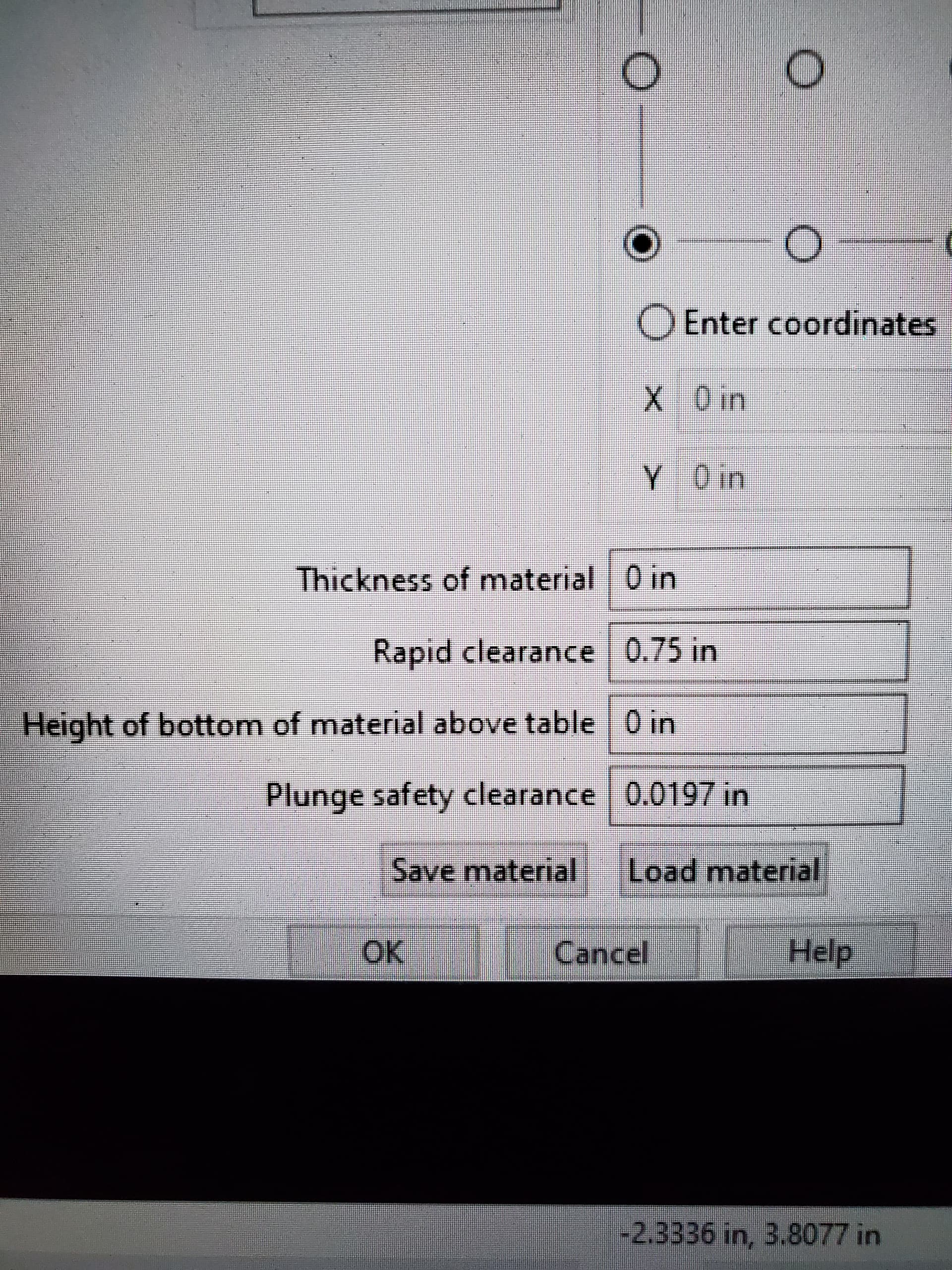

It is spring loaded so you just have to have a negative number entered for cut height. Very important to NOT bottom out the Z height.
Hope this helps.
