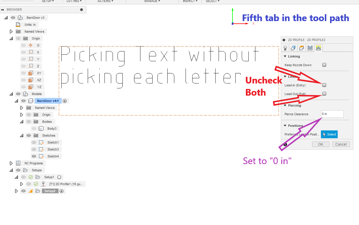

You will want to turn off THC (torch height control) but I don’t think you want to turn off IHS. IHS is only active at the beginning and end of the contour.
In CAM (tool path) you would set your compensation to “center” and eliminate lead-ins and lead-outs. Remove pierce clearance and set lead-in sweep angle to “0”.

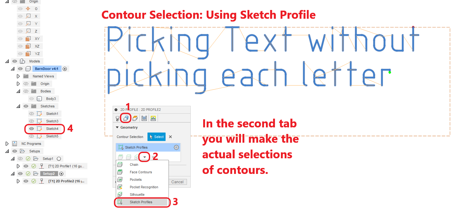

Thanks! Yeah, how do i use selection of sketch? Only been able to select contours one at a time when I’m making the cut file in 360.

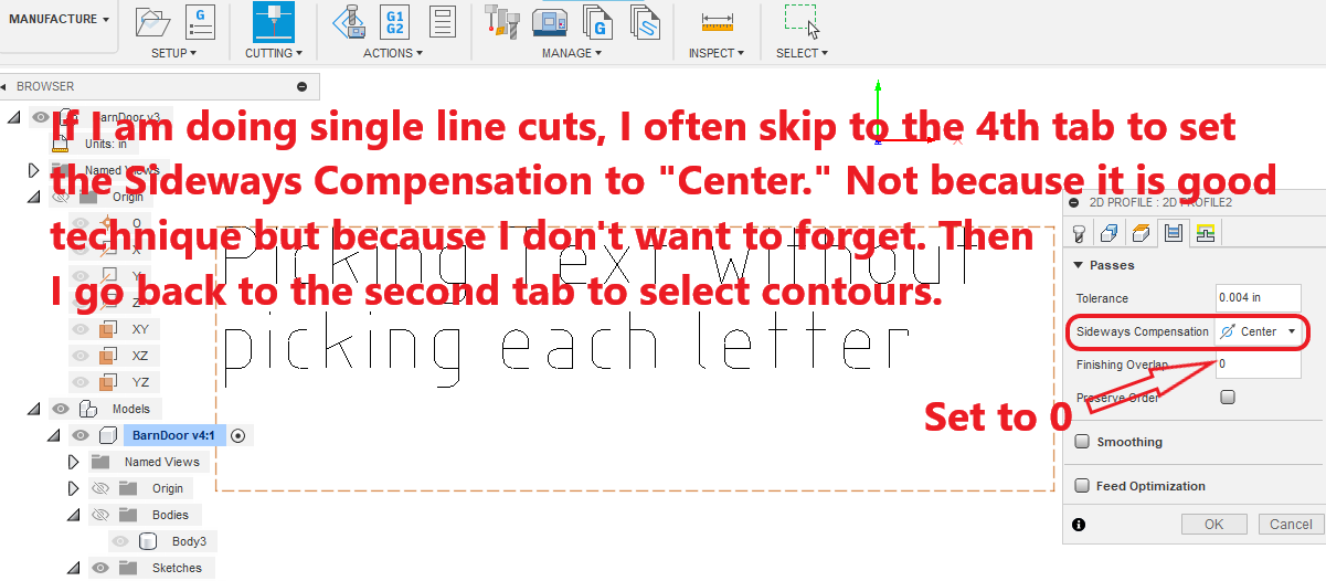

After creating my set-up I then go “cutting” to make the toolpath. In toolpath, since I know I will be doing single line lettering, I go straight to the fourth tab to put in “center” for Sideways Compensation.
Then I go back to tab two, where all of the selection of text takes place. I click on the downward triangle in the menu box and another menu opens. At the very bottom is “sketch profiles” Select that.:

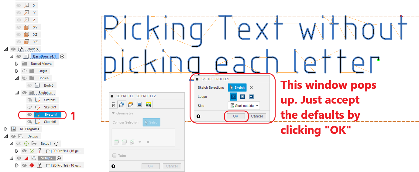

Now you go over to the file tree on the left and find your sketch (turn on the eyes if necessary). Click on your sketch.
I did not find it necessary to change any of the default menus that open such as SKETCH PROFILES. Just click OKAY.
Click OK.
The toolpath is completed and you can run the simulation. You will be amazed!
