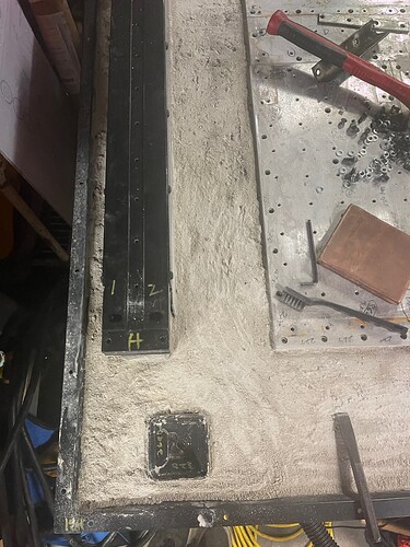

Finished mine and poured, Drains came out great, although the rear drains ended up just touching the y axis rails. Made for an easy location reference. Having a hard time getting the file type to change. I put .pdf at the end of the file name but its not recognizing any tips for windows 10?
