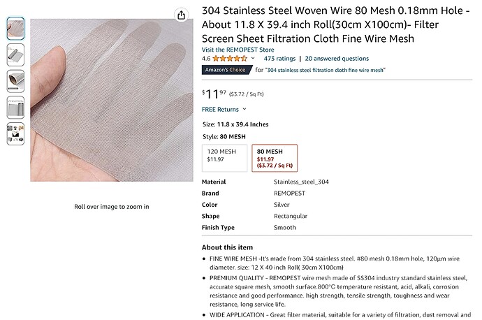

Been contemplating a fine mesh screen that I could make a levy of sorts with, or a bigger screen to sort if pre-filter the coolant before it gets to the drain screens. Just one more thing to clean though. I also plan on building a screen to drop in the tank as well to keep particles from circulating through the pump as much as possible.
Shouldn’t be hard to make new screens with finer mesh.
Tried smaller guage screen. The problem is the screens fit so badly. I have a set of gaskets from MrmachineTX that help, but do not fix the problem.
