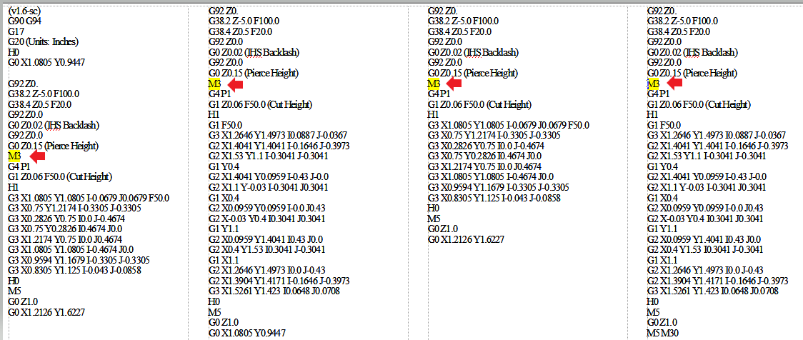

If it does then there is likely four separate times in the gcode where you will find a series of directions and the code M3 (Turn torch ON) will occur a total of 4 times since your widget only has two contours that it is cutting.
Otherwise M3 should only happen two times.

The part comes out great, but its that 'dunking the torch underwater" that has me baffled.
(v1.6-sc)
G90 G94
G17
G20 (Units: Inches)
H0
G0 X1.0805 Y0.9447
G92 Z0.
G38.2 Z-5.0 F100.0
G38.4 Z0.5 F20.0
G92 Z0.0
G0 Z0.02 (IHS Backlash)
G92 Z0.0
G0 Z0.15 (Pierce Height)
M3
G4 P1
G1 Z0.06 F50.0 (Cut Height)
H1
G3 X1.0805 Y1.0805 I-0.0679 J0.0679 F50.0
G3 X0.75 Y1.2174 I-0.3305 J-0.3305
G3 X0.2826 Y0.75 I0.0 J-0.4674
G3 X0.75 Y0.2826 I0.4674 J0.0
G3 X1.2174 Y0.75 I0.0 J0.4674
G3 X1.0805 Y1.0805 I-0.4674 J0.0
G3 X0.9594 Y1.1679 I-0.3305 J-0.3305
G3 X0.8305 Y1.125 I-0.043 J-0.0858
H0
M5
G0 Z1.0
G0 X1.2126 Y1.6227
G92 Z0.
G38.2 Z-5.0 F100.0
G38.4 Z0.5 F20.0
G92 Z0.0
G92 Z0.0
M3
G4 P1
H1
G1 F50.0
G3 X1.2646 Y1.4973 I0.0887 J-0.0367
G2 X1.4041 Y1.4041 I-0.1646 J-0.3973
G2 X1.53 Y1.1 I-0.3041 J-0.3041
G1 Y0.4
G2 X1.4041 Y0.0959 I-0.43 J-0.0
G2 X1.1 Y-0.03 I-0.3041 J0.3041
G1 X0.4
G2 X0.0959 Y0.0959 I-0.0 J0.43
G2 X-0.03 Y0.4 I0.3041 J0.3041
G1 Y1.1
G2 X0.0959 Y1.4041 I0.43 J0.0
G2 X0.4 Y1.53 I0.3041 J-0.3041
G1 X1.1
G2 X1.2646 Y1.4973 I0.0 J-0.43
G2 X1.3904 Y1.4171 I-0.1646 J-0.3973
G3 X1.5261 Y1.423 I0.0648 J0.0708
H0
M5
G0 Z1.0
G0 X1.0805 Y0.9447
G92 Z0.
G38.2 Z-5.0 F100.0
G38.4 Z0.5 F20.0
G92 Z0.0
G92 Z0.0
M3
G4 P1
H1
H0
M5
G0 Z1.0
G0 X1.2126 Y1.6227
G92 Z0.
G38.2 Z-5.0 F100.0
G38.4 Z0.5 F20.0
G92 Z0.0
G92 Z0.0
M3
G4 P1
H1
G1 F50.0
G1 Y0.4
G1 X0.4
G1 Y1.1
G1 X1.1
H0
M5
G0 Z1.0
M5 M30
(PS50)

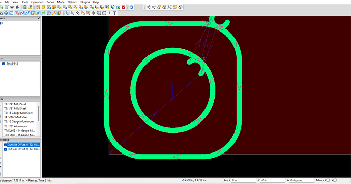

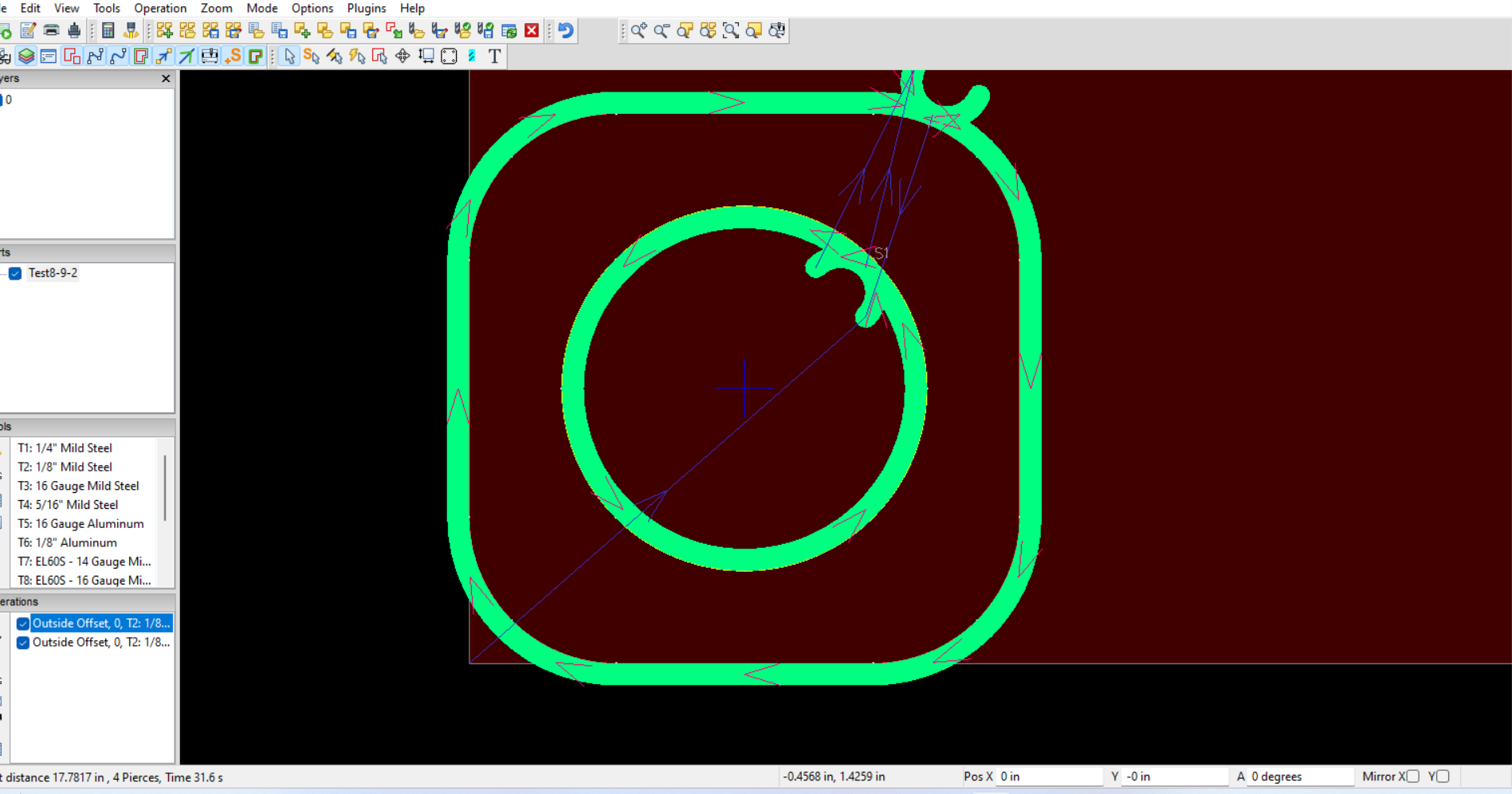

Wow guys thanks for putting up with me. This whole CAD/CAM thing is difficult for me for some reason.
I don’t recall if it has been asking me to “save the job file”
I am not trying to create a 'seperate operation".

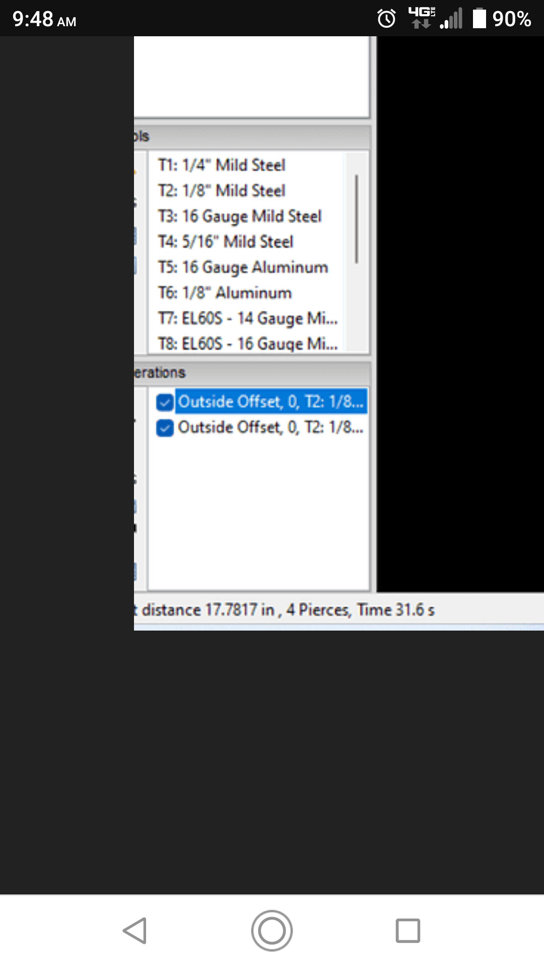

This is 'just before I post process" (I think…see Full disclosure)
Full disclosure: When I went to 'screen shot" this I found that I had about 5 Sheetcam windows open, so this one is the one “I Think” is the one that 'double cuts", but I can’t be 100% positive.
You need to delete one operation. You have 2 created for the same profile.
Click on one and delete it then repost process.

And you can see in your gcode that M3 appears four times. The machine is just doing what you told it to do. Silly machine! :rofl:
