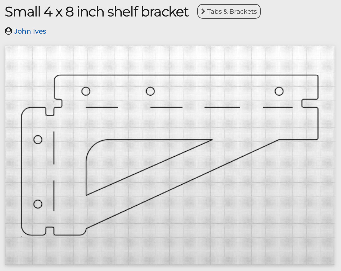

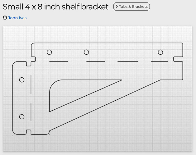

Does anyone still have this file? ...or better
Hi,

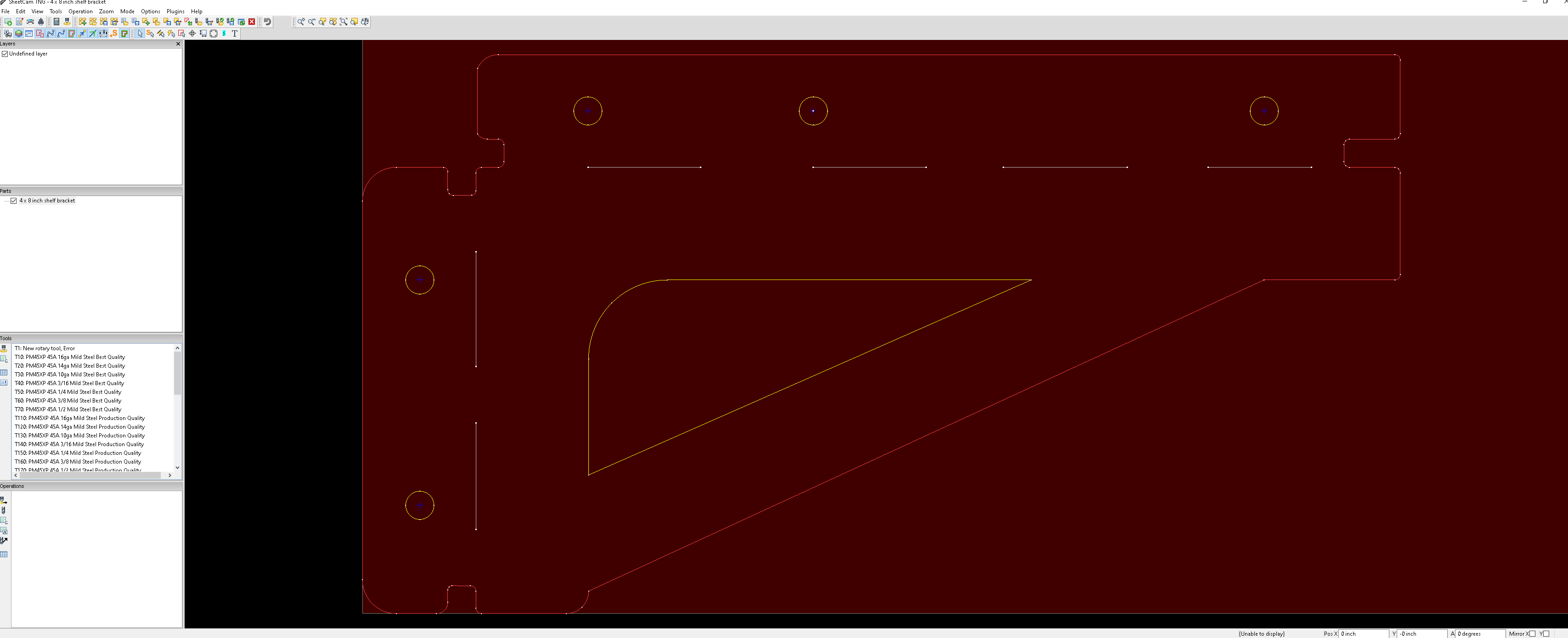

I am making a shelf for my daughter… does anyone have this?
Not sure what your question is, seems that you have file posted here? Download it and extract all then you can import to cad program and modify this bracket the way you want. This file you have posted has extra nodes that you want to delete, they appear as little squares when zoomed on.

This one, however, will not open in Fusion. I opened it in inkscape and it was blank.
If you can get it to work, upload here…
SheetCAM likes it.
Very weird.
I suspect the Layer name of ‘Undefined Layer’ may be a clue.
I’d rename the layer to something meaningful and export the SVG.
Also this bracket will end up being about 10X21 not 4X8
METRIC IMPORT AT 2.54?

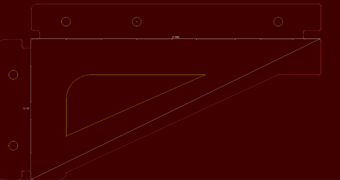

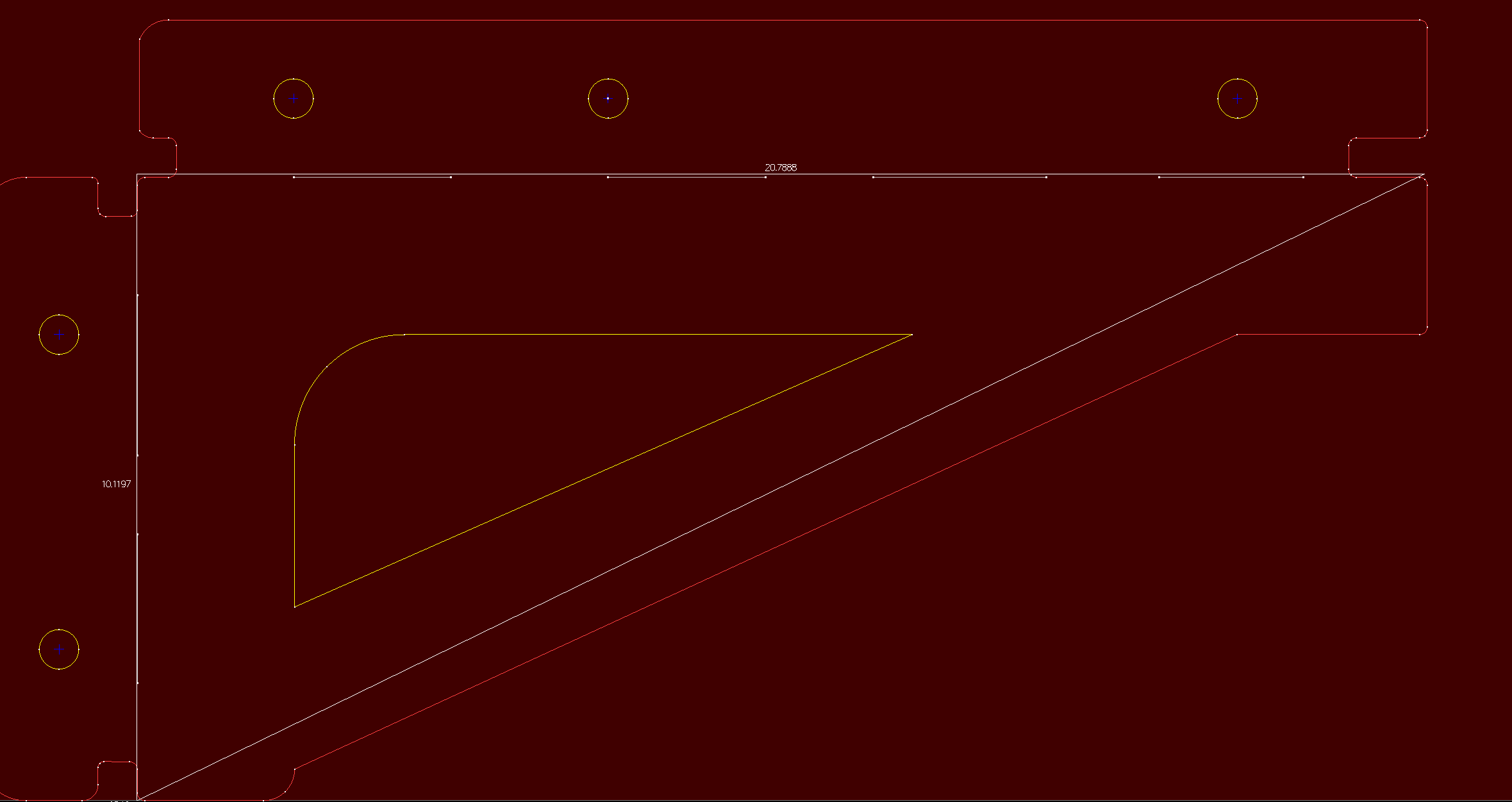

This should work in fusion and be the correct size
4X8 SHELF BRACKET FOR FUSION INCHES.dxf (6.9 KB)
Try this one:
4 x 8 Bracket.dxf (26.5 KB)
How did you come up with that one? Were you able to get the original to work or did you redraw it in Fusion? I redrew the example I posted .
@TinWhisperer this worked! I appreciate it.
This one also work, @Wsidr1.

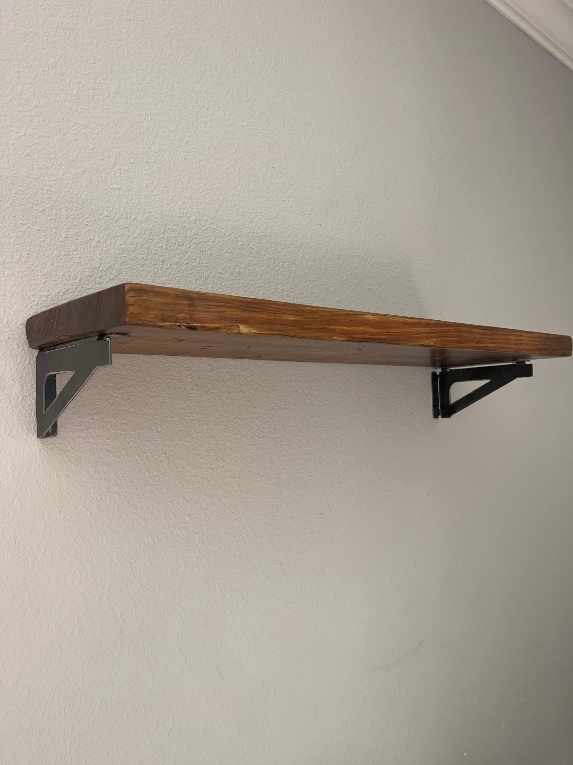

My daughter (and wife) will love it. I have a bit of wood left over, a 2”x12” that I plan to finish today.

I just converted the original file to SVG, inserted it to Fusion, and re-scaled it.
In what program? I tried to use https://convertio.co/ and it did not work for me
Convertio, just like you taught me. :grin:
It came in really small due to units being in mm, and it had a few stray holes drawn in, but otherwise all I had to do was re-scale it.
I had read his post and downloaded the original before you uploaded yours and didn’t even see you had reposted a corrected copy.
So weird it’s the first thing I tried and it came up all garbled for me but i just tried again and it worked perfectly.

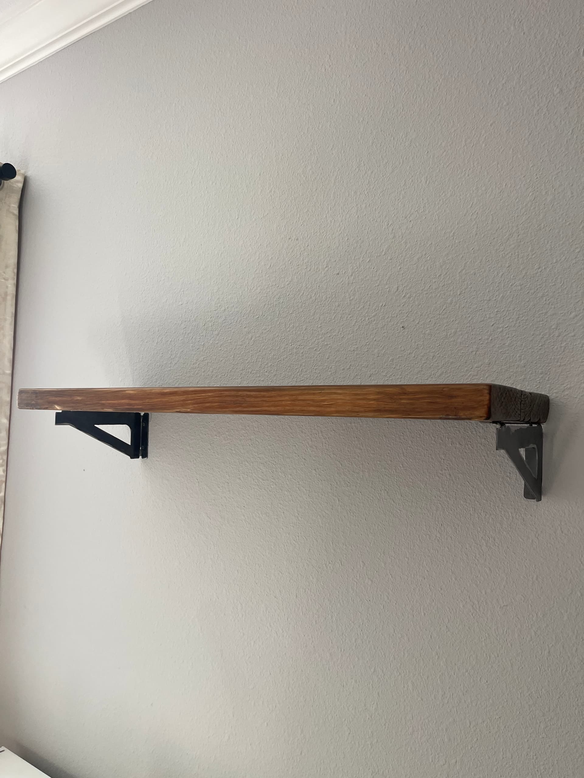

Bare metal for now… As she grows up, we paint it.
Thank you.
The project is complete.
Looks great. The pictures have me thinking that those brackets could also be installed upside down if someone chose to. With the wood plank sitting inside them.
