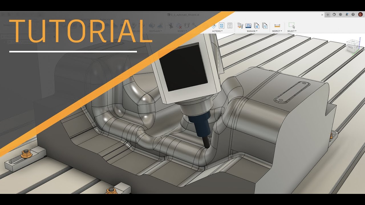

What can be done with a 4th axis? Will Fusion 360 work the same on the MR1?

From what I understand. Langmuir has a 4th axis in the works. Fusion 360 can handle the 4th axis without a problem. You may need to buy a fusion extension to get use of the 4th axis.

F 360 can be used for a 4th and 5th axis.
