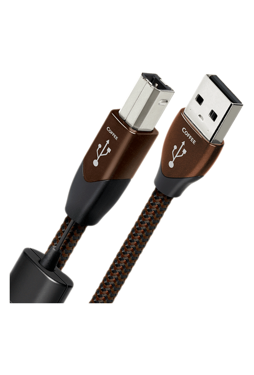

wow. here is a low noise 10’ er for only 900$us.
those audiophiles are something else…
Holy smokes, I’m looking for something a little cheaper ![]()
