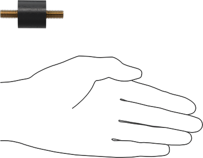

Are you providing any sort of vibration isolation to the connections?

I really like how it turned out. the vibration dampening didnt come to mind at all when designing the bracket so ill have to make some changed to it. Ill prbably make it slightly bigger and i can get those foam tapes or stick on foam sheets at walmart and tape it on to the heat exchanger doesnt get damaged from the vibration.
Limiting movement between the inlet/outlet tubes and the cooler is a lesson I learned the hard way.
My cooler broke at the outlet fitting, due to the cooler vibrating and flexing the tube at the AN fitting.
did you fine a solusion? Im gonna be changing to ptft instead of the hardline that goes from the compressor to the cooler so i wont have to worry about bending it to the exact place i need it.
I don’t know for sure. I zip tied the outlet tube to the cooler, so they don’t move separately. I’m hoping that prevents a repeat of the first broken cooler.
I was able to repair the broken one by cutting back some of the fins and soldering the connector back on, so i have that one for a spare.

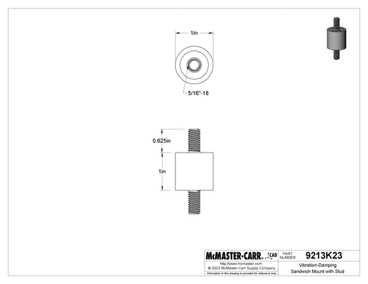

Vibration-Damping Sandwich Mount with Stud
Neoprene, 5/16"-18 x 5/8" Thread Length, 45 lbs. Capacity, 1" High
2-D PDF
Image of Product. Bottom orientation. Vibration-Damping Sandwich Mount with Stud, Neoprene, 5/16"-18 x 5/8" Thread Length, 45 lbs. Capacity, 1" High.
Technical drawing of Vibration-Damping Sandwich Mount with Stud, Neoprene, 5/16"-18 x 5/8" Thread Length, 45 lbs. Capacity, 1" High.
Image of Product. Side1 orientation. Contains SizingReference. Vibration-Damping Sandwich Mount with Stud, Neoprene, 5/16"-18 x 5/8" Thread Length, 45 lbs. Capacity, 1" High.

Mount Type Threaded Stud
Thread Size 5/16"-18
Thread Type UNC
Capacity per Mount 45 lbs.
Deflection @ Capacity 0.1"
Shear Capacity per Mount 8 lbs.
Deflection @ Shear Capacity 0.1"
Diameter 1"
Height 1"
Thread Length 5/8"
Hardness Durometer 50A
Hardness Rating Medium
System of Measurement Inch
Shape Round
Material Black Neoprene Rubber
Stud Material Zinc-Plated Steel
Temperature Range 10° to 180° F

This is the cooler I have mounted on mine as an aftercooler
amazon.com/gp/product/B004XONT3E
I would recommend mounting the cooler OFF of the compressor to maximize rigidity (minimize induced vibration), and run at least a small portion of FLEXIBLE line on both sides. There is some nylon braided AN line you can pick up from summit racing that I used on my old hotrod that should work wonders and not be a total PITA to cut and install, like SS braided.
Also, notice the angle of the tubes. To do it 100% correctly, you need to mount the cooler at a 45° angle so that the tubes are horizontal, avoiding any moisture trapping. (Example, tilt the top of the cooler BACKWARDS in the image of the cooler on the zon)
