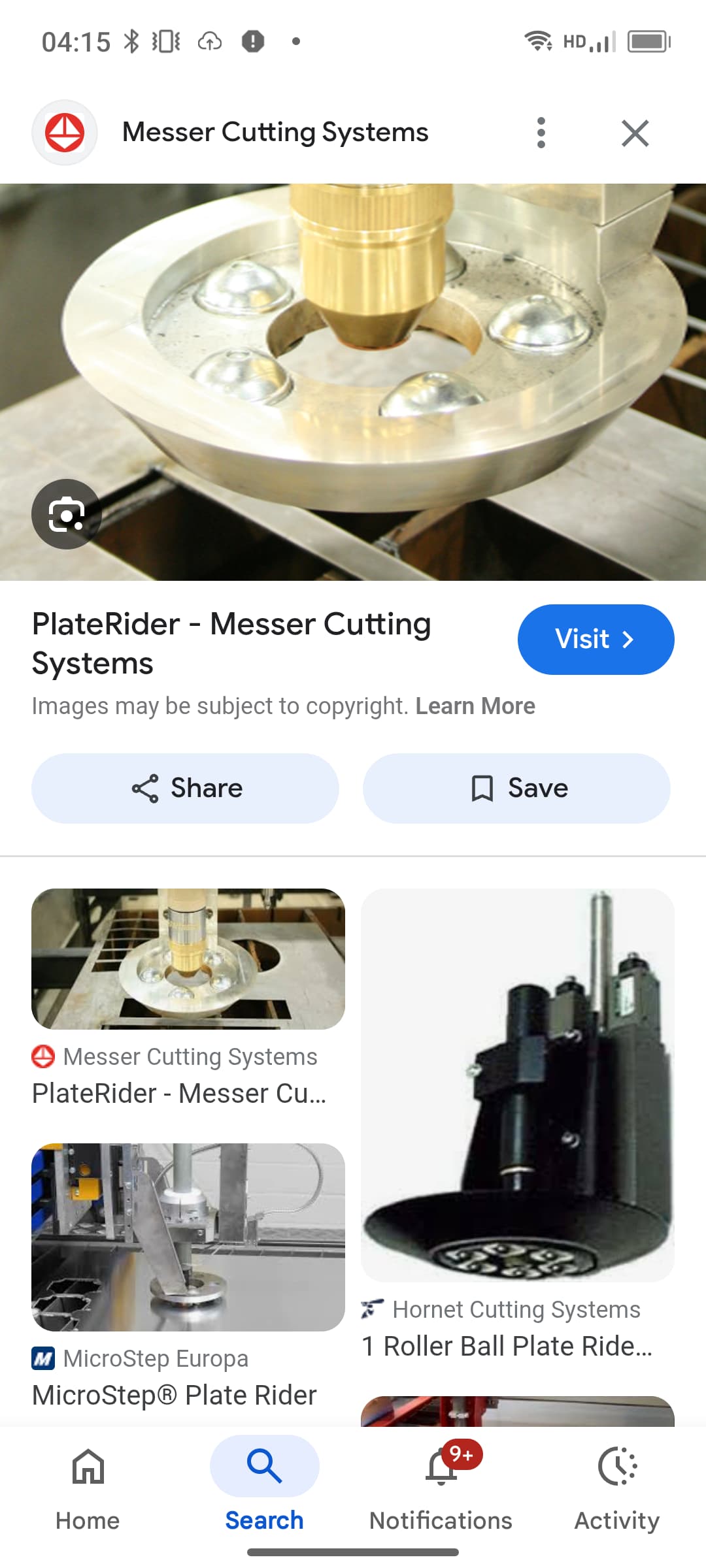

For plasma cutting in the HVAC world to use a device called a “plate Rider”
#1 Roller Ball Plate Rider | Superior Torch Height Control #1 Roller Ball Plate Rider | Superior Torch Height Control
MicroStep® Plate Rider MicroStep® Plate Rider
