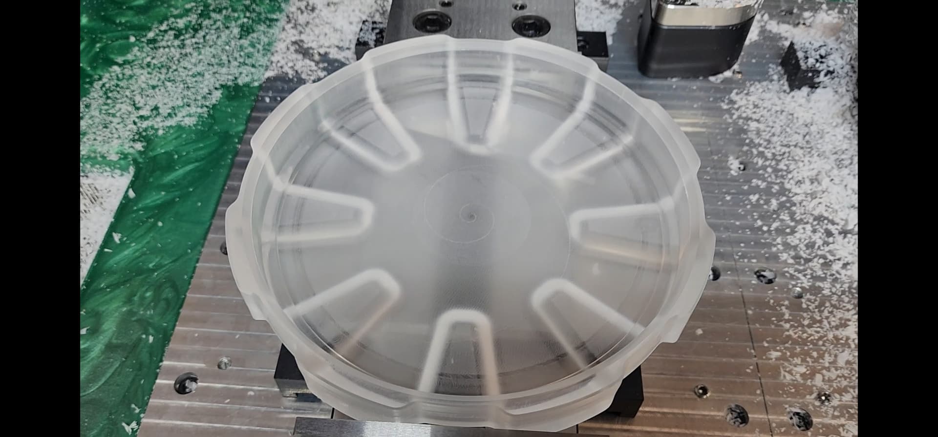

I’m attempting to expand my knowledge with the mr1 and f360.
I’m attempting to cut large ID and OD threads on a 6" wide cap and flange.
I’m assuming I need a threading end mill such as these.
My interest is how to create the end mill in f360 and the steps it takes to program the tool path.
I realize my request is rather broad and thats just because I don’t know what I don’t know. This is juat the beginning of my quest.
And for a visual, this is what I have so far. I need to put inside threads to it like what I modeled in solidworks.
Thanks guys!
You can just create a new tool in your F360 library, it has thread mill as an option, enter the parameters on each tab (tool dimensions and speeds primarily). It’s a little nerve wracking the first few times, but it’s really not that difficult once you see well it works.
