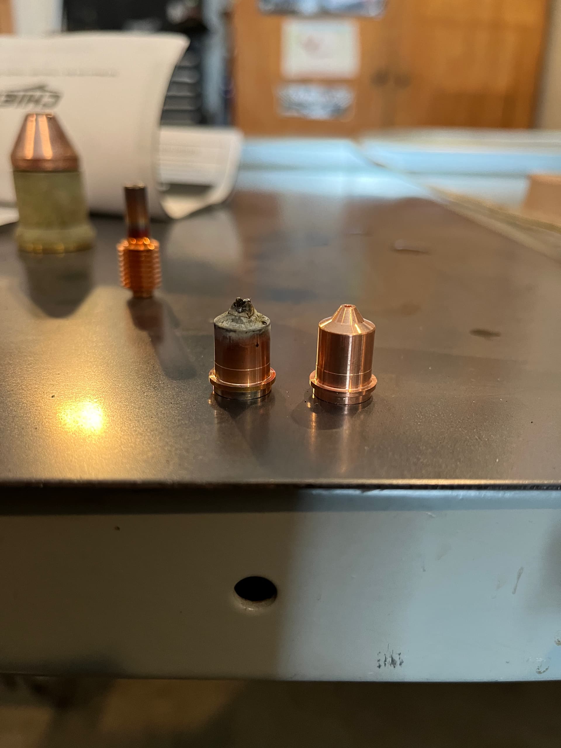

One in the left is the one I’ve been using looks shot right one is a new one sent with
Yeah that’s shot can you do a close up of the end of the electrode?

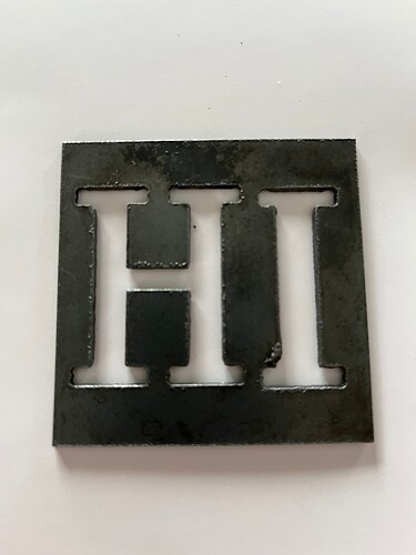

Changed the tip! lead in is at .15 no lead out, outside offset 100 ipm pierce delay .5 looks a lot better but little slag on top and the I still has a little lead in slag? No lead out on anything now. Back looks about the same as the front for slag not much but a little.
You are getting there if your consumables are not lasting. It can be cut height, moisture along with other things.
That really isn’t to bad!
What do you mean what do I have my leads set to lead in and lead out? Lead in .15 , no lead out otherwise don’t know what your talking about for sure
How long will your consumables normally last?
I thought you asked what to do about lead ins.
As for consumables that is a hard one. Depends on air quality, material and so one. When I started I had very little as far as moisture control. I would get a couple hundred pierces out of a set.
Ok well I was over that, but I do have some moisture control. Yes I have lead in at .15 now and no lead out on an arc

@Jarett I think you can appreciate how the the nozzle having the large hole in the side, was probably responsible for a lot of havoc with you cutting. Its job is to focus the plasma stream.
Copied from: https://espritautomation.com/plasma-cutting-consumables/
The nozzle focuses the plasma arc and the gas that surrounds it to make a clean and precise cut. A nozzle with a larger opening is used for gouging, while a nozzle with a smaller opening is better able to direct the gas and so is used for fine, detailed work.
Yes didn’t realize it was that bad
