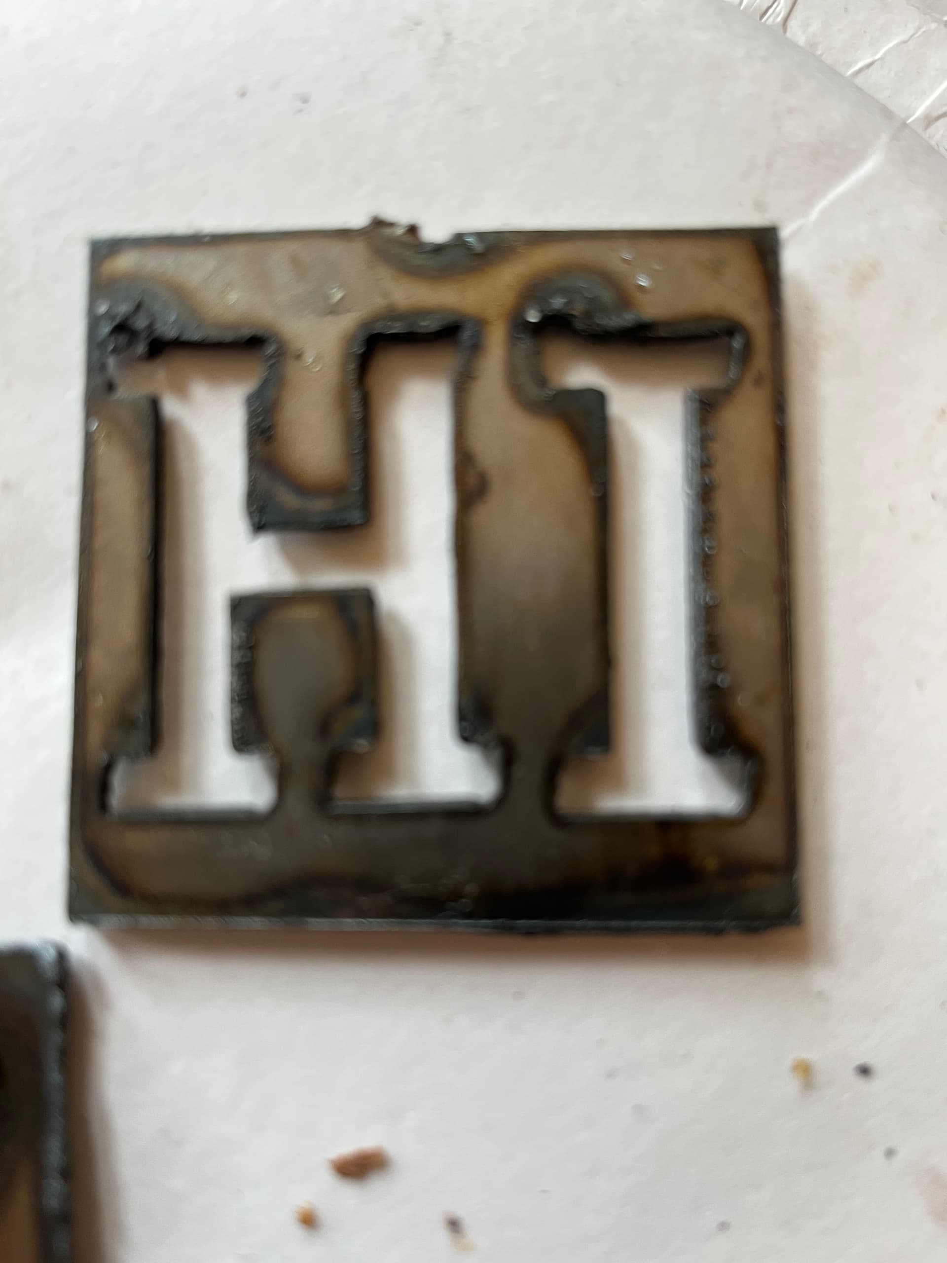

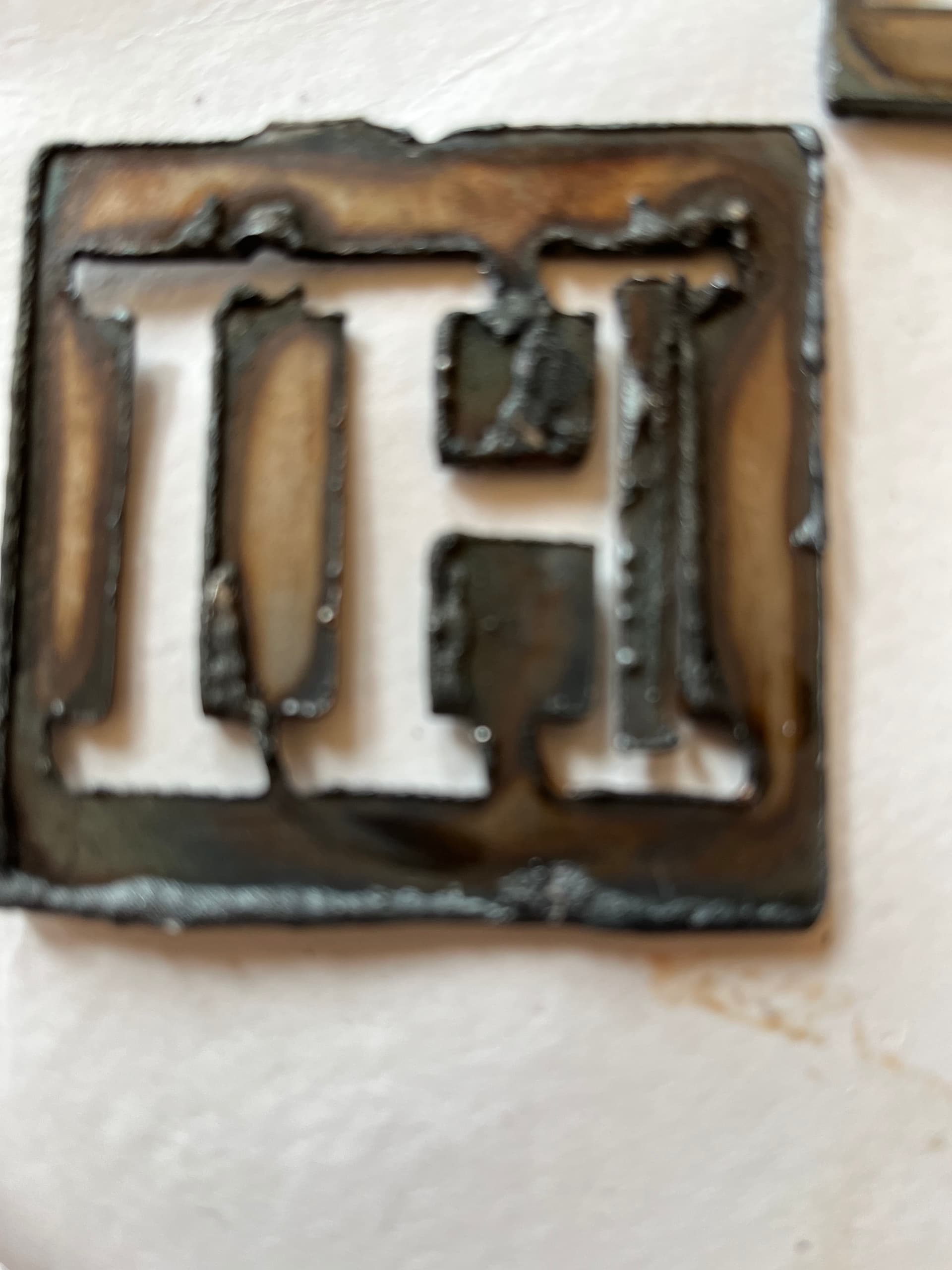

Cutting area too small?
I would definitely try clamp on the material. Also to keep waste down find a small piece to cut as a practice.
Judging by the bevel of the cuts, it appears that your torch may be too far away. And the added power that is needed to cut when further from the material may be resulting in the destruction of your letters.
plasma arc

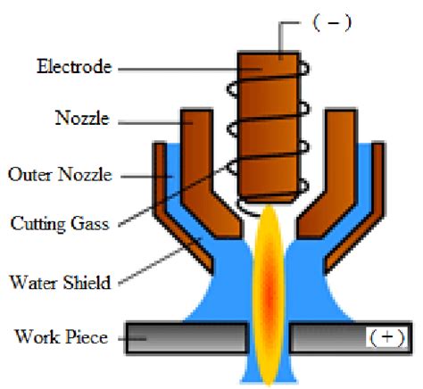

Edit: Corrected to say your torch may be too high. And, ignore the “water shield” in the diagram.

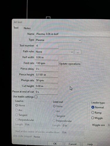

How is that adjusted in sheet cam ?
First off, you would want to confirm exactly what height the torch is during cutting.
  1. Do a test cut and while cutting, press the space bar while FireControl is running the cut. This will stop the cut, torch position and height.
  2. Measure the height between the metal and the torch with a feeler guage.
    Then, if you confirm that the cut height is too high, you give a cut height smaller than you have been in the “cut height” setting of your tool in SheetCAM.
Will do. What is the proper ht anyone know have a razor weld 45
0.06 inches, I believe, will get you in the ball park.
But keep in mind, I would not monkey with those settings until you know that you are using the correct consumables.
I need something adjusted cause I have my lead in and lead out at .08 and I still see them in my cuts

See anything that should be adjusted?
I do pierce at .150 and cut at .06. also I always try to do a lead in and out that is at least double my kerf
Two , 2” cuts front of one back of the other clamp on metal, plasma at 45, air at 80 , speed at 80
Looks terrible
Can you take a up close picture of your nozzle and electrode?
At 45 amps you will need to go faster
@Phillipw - just asking: He has pierce delay set at 0.0 seconds?
I know with Hypertherm, we need at least 0.6 seconds, I need closer to 0.65 seconds. I am not familiar with other machines and SheetCAM.
@Jarett : definitely you cut height is set too high and is consistent with your slope on the cut.
I never even noticed that. With My rw45 .5 on thin stuff.
I also do the same.5 with my ht65 have never had a issue either.
