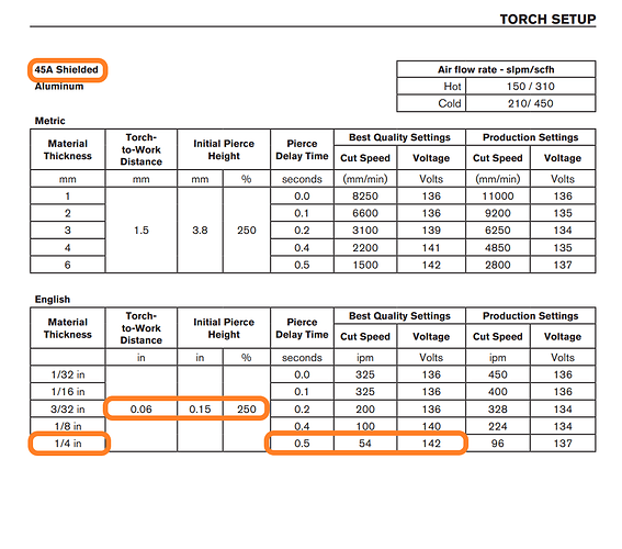

I do not have a Razor Weld but these are the settings I use on my Hypertherm Powermax 85 any detailed aluminum cutting.
I normally run about 10% slower than what’s listed here and I do a 50% reduction for feed rate optimization for the inside corners.

How do I set my Razorweld 45 to 142 volts. It only has amp adjustment.
The voltage shown there is in regards to torch height.
You change your Firecontrol settings from Smartvoltage to Nominal Voltage, and instead of Firecontrol using your programmed cut height value for setting cut height, it will now use the voltage value you entered and adjust its height to maintain that voltage within 1.5v (default).
Ideally you would do test cuts before deciding 142v is what you would/should use.
Really, test cuts for anything new you’re cutting.
You don’t for now.
With your razer weld you’ll likely just be using smart voltage.
Overtime while using smart voltage and getting good cuts you could start paying attention to what the actual voltage is showing up in fire control write it down and then use it under a nominal voltage setting in future operations.
But for right now smart voltage is going to work for you as long as your cut height is correct.

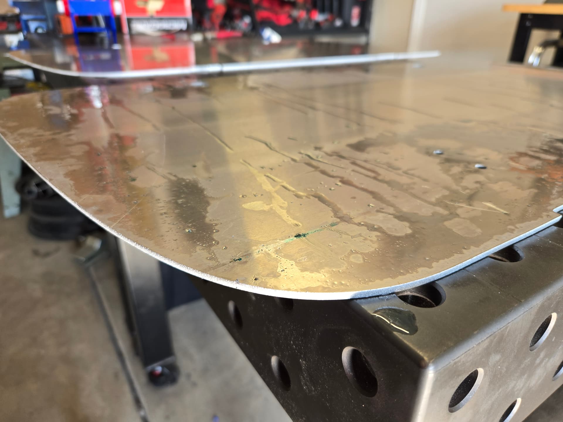

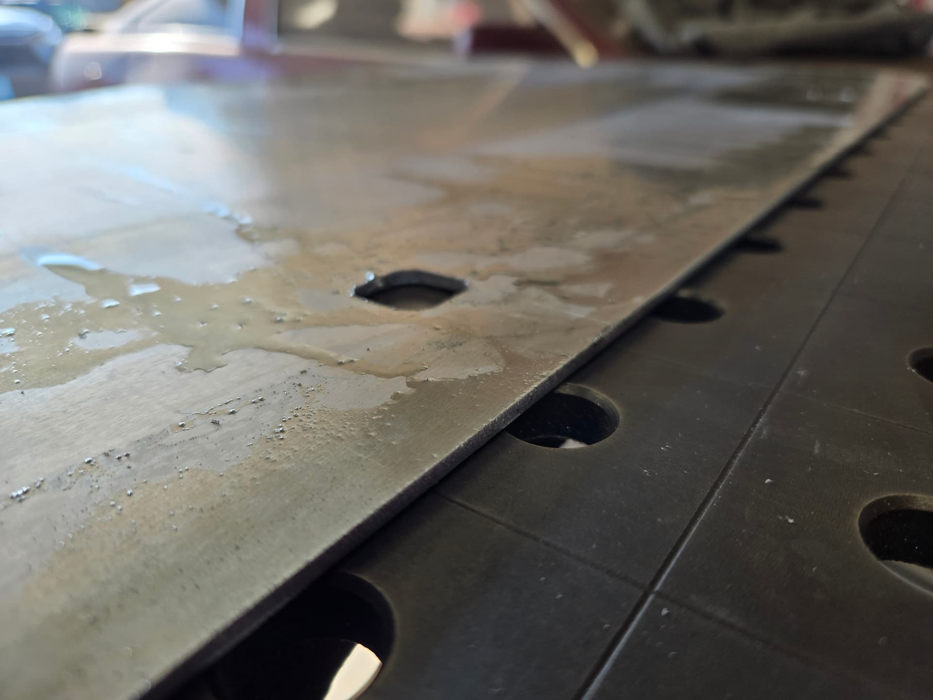

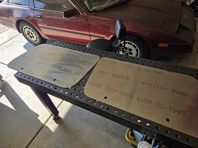

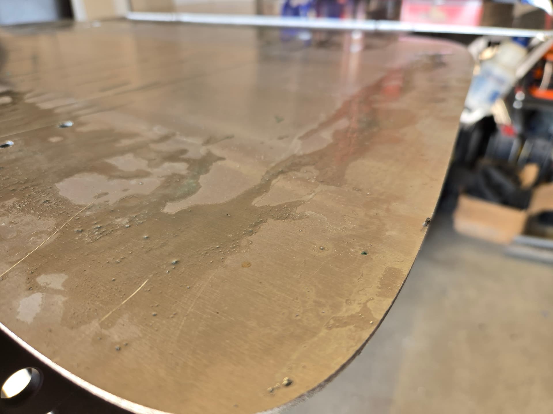

I’ve cut 1/8” and 3/8” and whether it’s thick or thin, you’ll get some blowback from that initial pierce trying to stick on your nozzle. The spray helps to prevent that.
Dialed in you can get some dross-free cuts too (all bottom side pics)
Very happy with how easy it is to cut
