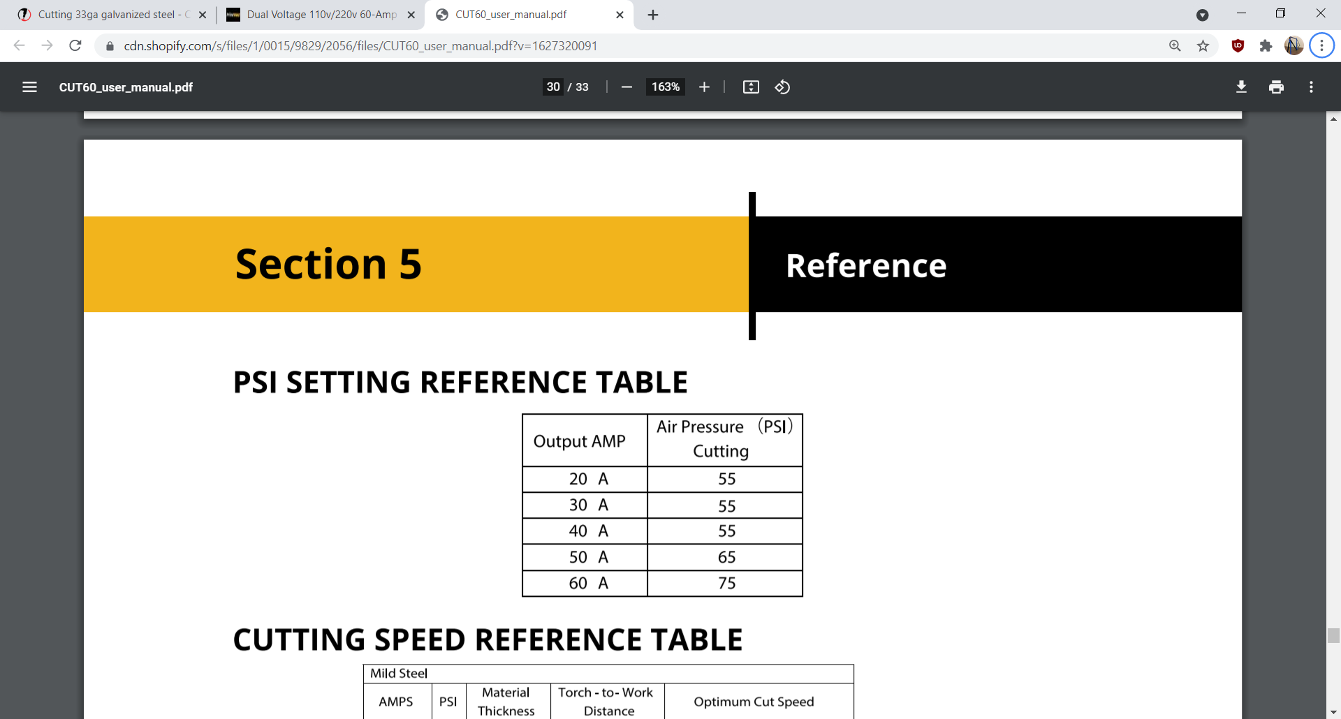

OK so I cut it but it was a bit of a challenge. I set the speed to the maximum, 7620mm/min (300IPM). Set my CUT60 down to 20A and 30PSI, the arc would NOT start. I had to bump up the pressure to 45PSI and 25A. Very strange? Why would that be?
Cuts are remarkably clean, even though I used pretty random settings
It’s not strange at all. Your air pressure was too low to blow back the electrode and start the torch. I’m surprised that it worked at 45psi.
You are absolutely right, I … don’t know what I was doing. As the material was so thin, I guess I extrapolated going way out of the range. This explains it all, now I know.
I had serious warping issues when I tried cutting it last. I was considering using it as prototyping material for testing new designs before cutting the thicker expensive material.
Mine came out surprisingly good. The water splashing underneath might have helped. The THC was working to keep it in the range as it was “moving” while cutting. Disclaimer, I cut a large area, about 24x36, to make a conical shape so I never localized heat too much, and I was going max speed.
A lot of the HVAC guys are using the 0.65mm/20amp and 0.8mm/30 amp consumables for cutting out duct work it gives them really fine cuts.
Oh that makes sense. I used the regular consumables that I use for 1/4" material :sweat_smile:
In the future I will stock in a wider variety of consumables.
I tried again at 20A 50PSI max speed (7620mm/min (300IPM)) and it’s perfect
