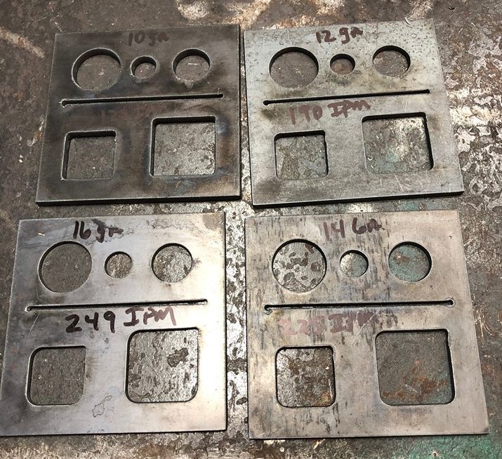

Make yourself a line test and assign each cut path a different IPM setting to determine where you need to be in the ballpark. I started doing this for my different materials and my gosh did it take a lot of the headache away.
I just draw a simple 5x5 square, though you could do 10x10 if you so wish. Within the square you would draw 10 lines spaced out appropriately and setup the cut paths in F360 CAM with different IPM settings. For example, you could start at 60 IPM, 50 IPM, 40 IPM and so on. I have a line test file setup for my aluminum that I could share. You would need to change the CAM profiles to meet you needs. PM me and I’ll gladly send it.
I agree with thatguytom, Line tests are the way to go, I posted up a sample file here How do I set up a line test?. Every machine can be different so it comes down to trial and error but if somebody is getting a clean cut and can share the info, then I do a line test around that number in increments of 5 ipm to dial it in.
Also when people give feed rates, you really need to also say what machine it is, not just 30 or 45. I had a Razorweld 45 and now have the Hypertherm 45xp and feed rates are totally different. For example with the RW45, 10ga I was at 40-45 ipm for a decent cut where with the Hypertherm 45xp I am now at 130 ipt for an extremely nice cut with little dross. So far the Hypertherm cut chart in the manual has been spot on.
Exactly! We’ve done this for years in the laser world. I have a cut & engrave design I use on every new material on my lasers. It let’s me get the settings dialed in right away. It also let’s me see if the laser is starting to age over time and lose power.
The same technique can be used for cuts. The line test file doesn’t need to be big but I like the 5x5 reccommendation - gives enough time to accelerate the head to speed.
Also you might want to add a couple of cut outs - a couple of circles & squares. One each for inside & outside cuts so you can see what a couple of standard lead-in/out distance/angle/radius will look like.
The circle & square cutouts will let you measure your kerf and the lead-in/out variations will give you a handle on what works so you can adjust those for other designs.

I have this file that I run after I get the speed dialed in with the line test. Need to work on the inside squares in Sheetcam as they are getting rounded out on the thinner stuff. I come from about 18 years of having a CNC router so a lot of the speed/feed and test cuts are normal for me.
