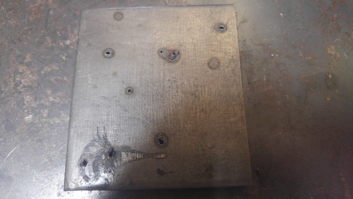

Hi everyone; I’m new on the forum. This morning Dennis was kind enough to demo his machine for me, as I live nearby and am interested in possibly getting a Crossfire. We attempted to cut a shape in 1/4 inch mild steel plate, and as he stated above, it resulted in a large buildup of slag or dross on the top, surrounding the hold. It does pierce through in about 1 second or so at 30 amps setting. I’m going to try to attach photos showing this.
This image shows the top side; I can only attach one image per post, so a subsequent post will show the bottom side. We tried setting the tip height higher and lower than the gauge, but basically the slag simply fills in all around the tip, and sometimes completely fills the gap between steel and tip. It seems with such a thick slag buildup the tip would not be able to return anywhere near the pierce location, without crashing into the slag pile. This can’t be right??
As Dennis stated, he tried changing the nozzle and electrode, but no difference. He also tried clipping the ground wire clamp directly to the workpiece, as we though perhaps using such a small piece of steel was preventing a good ground contact with the slats.
Finally we are wondering about the proper gap setting, given that the torch that comes with the 30 Air is meant to be dragged manually across a surface. Does this imply the gap should be set as close to zero as feasible? Or rather does it mean we should be using a different torch that is designed for CNC cutting??

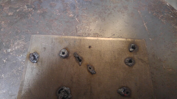

The following image shows the bottom side of this piece:

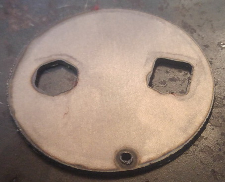

This image shows the result on a piece of 18 Gauge steel, top side:
38_resize

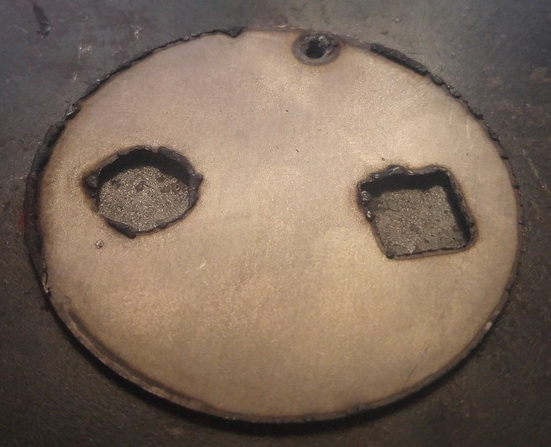

This last image shows the bottom side of that 18-ga piece:
46_resize
Slag like that on top is caused by the torch spewing the molten metal out the top instead of pushing it through the material. You can usually knock it off easily with a welder’s hammer for instance.
Typical causes are a worn nozzle, too fast a speed or nozzle standoff is too high. In your case since you’re using what sounds like a drag tip I’d go with too much standoff. If you do have a drag tip and you used the thin Crossfire shim you’re just about twice as high as you should be for 30A.
I’d drop it until the tip was just touching and you can feel a little drag - but not so much you bind the motors. Just kiss the steel with it.
