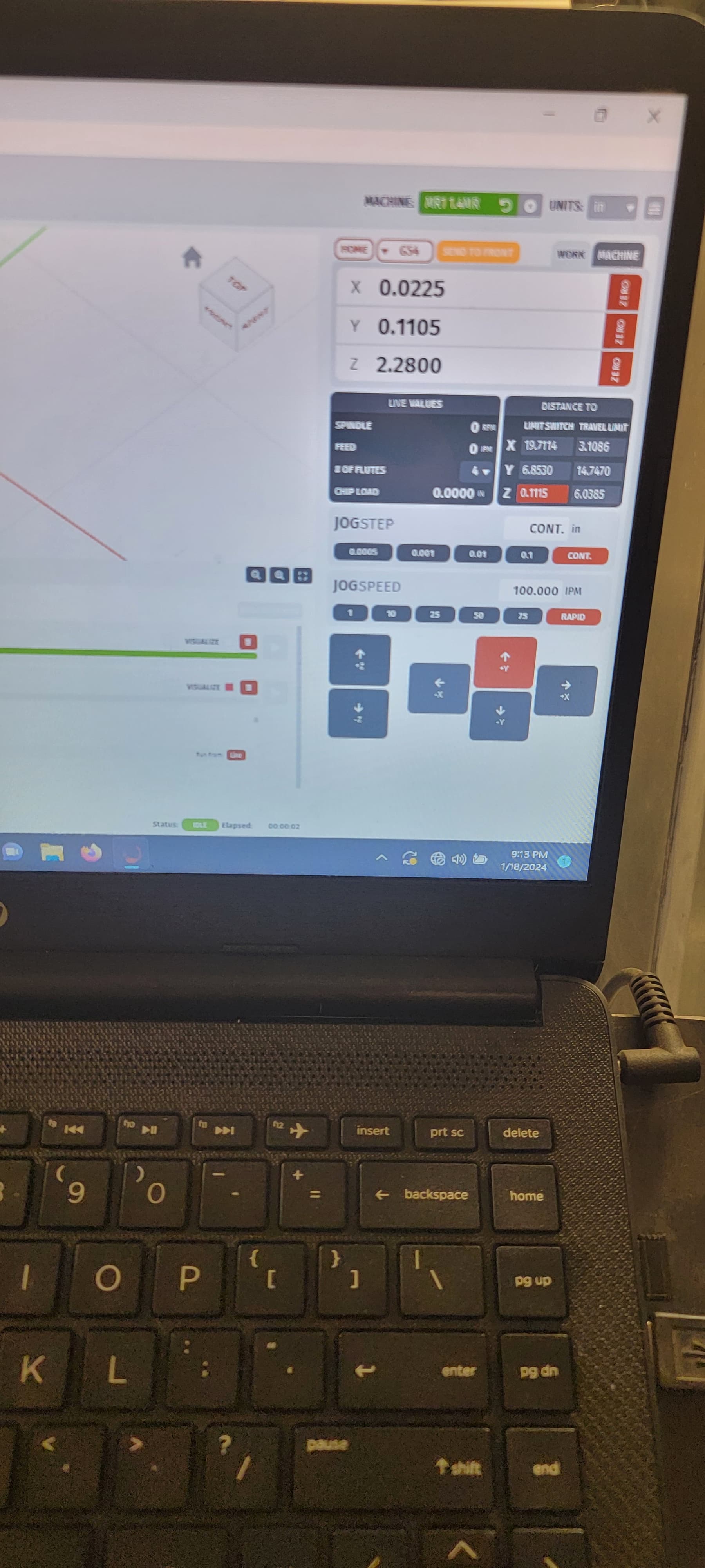

Had one issue pop up last night, can’t remember exactly what I was doing as it was late, pretty sure it was during a send to front. I bumped an arrow key on accident, nothing happened but when I was done changing the tool an error was on the screen saying command couldn’t be processed or something and then I had no control over movement and noticed the y+ arrow was stuck on the screen. Had to completely restart cut control to get anywhere. Verified it wasn’t my keyboard or mini keyboard stuck also.
