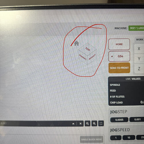

Is there anyone else that has no orbit box in the machine view any longer? The box is there but no zoom and the box will not move which means no orbit either? Everything else works but not that box and it stinks when you want to see where a line highlight is place you see the green point in the screen. What am I missing?
Perhaps a picture of what you are referring to?
Sorry for such a delay but I get pulled in all kind of directions. This box no longer moves? I have tried with a mouse as this is touch screen. I have looked for all updates and see none. Just dont understand why?
