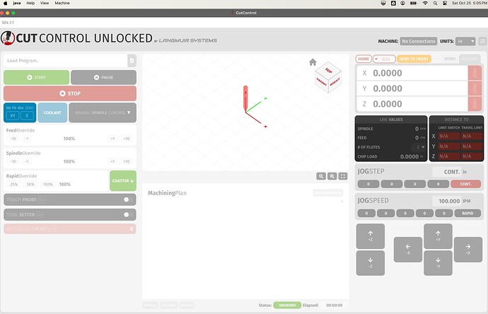

Turns out… it’s not very hard to decompile a java program. You’ll note that Langmuir never released 24.1.1 for Mac (I’ve decompiled the windows release and recompiled here for Apple Silicon Mac) and I’ve changed the text in the UX to read “unlocked”.
I do know its easy but its a lot easier if they provided all the info instead of us having to RE it.
