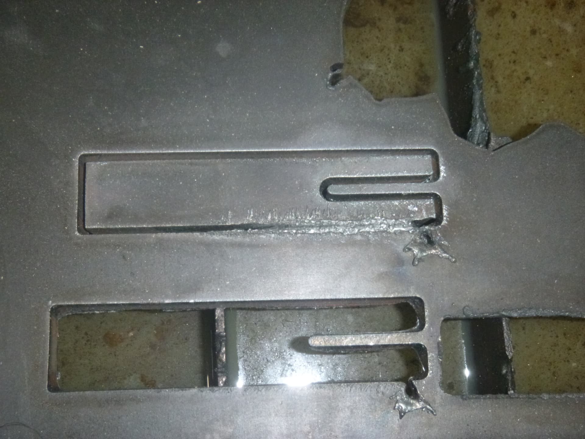

Cut will pierce but then not cut for about an inch before cutting through
Initially the postive connection is made as the amps ramp up the connection is lost. Always make your connection to the metal your cutting.
A magnetic welding lug works great. This is what a lot of us use.This magnetic ground clamp has a finned design to lower temperature by 27% and provides a strong, reliable hold on any flat or round steel surface. Check it out now! Amazon.com
Your settings or other problems may exist but lets get this fixed first to eliminate a bad work clamp connection.

Understood. Only reason I question is because with the issue I am seeing in is “Consistently” bad in the same spot. This to me reflects a different sort of error especially as I run a NC file from someone else and it cuts just fine. My main agenda is to tune settings from here to eliminate that consistent error

I’m wondering if it has something to do with the pierce delay?
When I was having those same issues, we found that increasing the pierce delay
really helped!
Ours is set at around 1-1.1sec (works best for us).
-Mike
Yes that was my initial thought too. In my original picture the delay times were changed between all the cuts and it would pierce fine but then not cut. The only thing that helped a little was to slow the cut way down. I will definitely take your advice and play with the delay time some more. Thanks:)
I’m sorry, guys, but a pierce delay of 1.1 or greater is the correct setting for 3/8 A36. If you guys make signs with 16-gauge, .5 or .7 would be the longest. If your pierce delay is too long, you are blowing a hole in the metal, and the THC is losing its reading with the plate that is no longer there. Just my two cent from a table that works correctly every single day.
You’re one it as usual Bigdaddy.
I cut almost exclusively 16 and 18 gauge signs. My pierce is 0.7 secs for the 16 ga and 0.6 for the 18 ga.
With a RW45 and Duramax torch my PD on 14 ga is .2 with the original torch it was .5
Yes i cut mainly 14g and I have found .7 seconds to be the sweet spot so I am on par with you guys.
