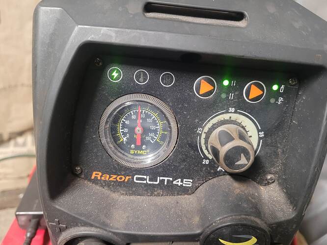

I feel like all my fittings and whatnot may be a good part of my issue. I supposed I should find a permanent home for everything and run some bigger air lines or something. The regulator was temporary to testing purposes and was mounted directly to the tank previously. Don’t grill me too hard on my air setup, I honestly forgot how many reduction fittings I had most likely due to adding things and moving things around for previous setups.
Torch off
Torch on
The more I think of it and look at these photos the more it makes sense why this is most likely my problem. Just the fact that my machine was cutting great for a bit really threw me for a loop.
Any insight on some ideas to run better air lines in my shop would be appreciated, going to do some research in the meantime. Is pex the way to go?
