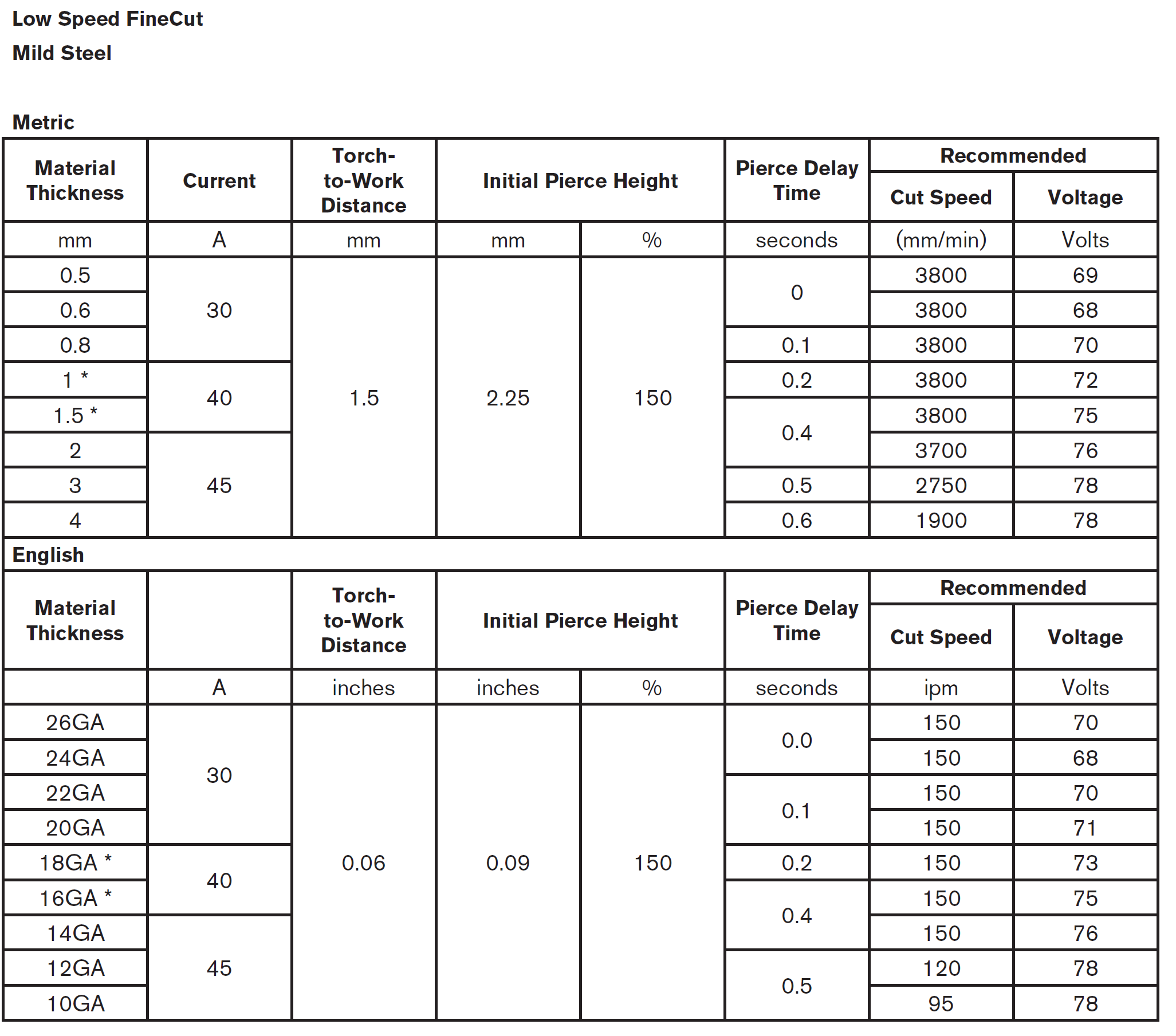

You mentioned wanting to have 300 ipm functioning properly (agreed!) for those cuts on thinner material. Since most of my cuts are presently in the 75 - 150 ipm range when are you using a cut rate of >220 ipm? Not rapids but actual material that would see such hi speed torch movement?
Anyway, thank you very much for editing the code as a temporary work around - it’s very much appreciated!! (I have a note hanging on the machine called Greg’s NOTE to remember to change back to the original post processor if/when this gets resolved)
I use a Hypertherm 600 with the new Duramax torch. The factory chart for fine cut consumables which are used on thin material is:
I’ve cut 22 gauge at 300 IPM and it worked well.
Hypertherm does provide a low speed chart for fine cut:
the reasoning you can read here on plasmaspider TLDR the higher speeds will give better cut. Slower speeds published for lower cost machines that can’t go that fast.
Cutting at 325 ipm! Not happening here. I’m using the Razor Cut 45 for now and will go with the slow fine cuts. Thanks for sharing these charts. I’m learning everyday!
