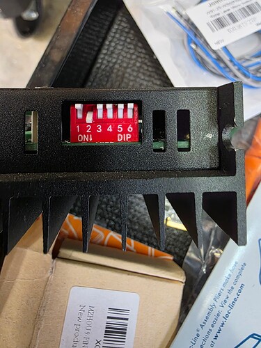

Hi Kwikfab, (and everyone else reading)
I know this post is a bit old, but do you have any additional info or pics on the correct dip switch positions? I’ve having an issue with my IHS setting much lower than programmed. I have to command .3 (yes, .3 as in almost 5/16) to get an actual pierce/cut height of .062 or 1/16.
Additionally, I don’t know if the Z-axis is supposed to move in the same commanded increments as the x & y axis, but if I have 1/16 increments selected and I move the Z-axis 1 increment, it’s much less than 1/16" actual movement.
I’ve been looking for info regarding IHS calibration/function but haven’t found anything…it’s all about THC (which works just fine when the pierce/cut heights are physically correct)
Any input is greatly appreciated and thanks to all in advance!
That definitely sounds like a dip switch setting on the driver.
All of the drivers should have the same dip switch settings.
Check the X , Y1 & Y2 drivers and set the Z to match.
Thanks for the info guys! I pulled the cover off and the 2nd dip switch is down (just like the others). I even toggled it up/down to make sure it’s “engaged”.
If I run my torch down until the IHS light turns on and zero my z-axis DRO, it takes 5 increments of 1/16” step to get to ~.062 actual height (and the DRO reads .312 as if it actually moved those 5 steps of 1/16”). What else could cause this? I just don’t know what else I can do or check. Processing: IMG_6562.jpeg…
It could be the coupler, between the motor and the lead screw, slipping. It probably won’t slip on the way down, because there isn’t much load on it. It has to lift the torch on the way up, so the extra load could make it slip.
Other, less likely, possibilities could be burnt pins in the stepper motor connector or a bad stepper motor or driver.
EDIT: Try switching the Z axis motor to the X axis port and see if the movement is correct. That would indicate that the Z driver is bad.
Thanks for the feedback! It’s not the coupler…I watched it while moving up/down and the lead screw turns the same as the stepper.
That’s a great idea, feel pretty stupid I didn’t think of that. Was trying to figure out how I could test the driver…DUH! Now I have to wait all day until I can get home & try it!
Thanks ds690, I really appreciate your help & suggestions…that was it!
Plugged the Z-axis motor into the y-axis driver and immediately upon jogging the “actual z-axis” you could tell the difference in sound & speed. Did a quick test similar to what I explained previously & although there’s still a small offset, it’s expected & within acceptable range.
