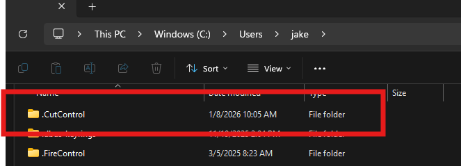

Hey fellas,
Here is our official fix for the JVM error. We’ll be making a long term fix for it in the next CutControl update so it shouldn’t be around for too long.
  1. Download the updated CutControl folder from this link https://drive.google.com/drive/folders/1XI6KUZwtEXHygH9SktcH_RBRhJvxhfYU?usp=sharing. Then find the file in your downloads folder and copy it.
  2. Open the File Explorer, go to This PC → C: Drive → Users → (Your Username) and you should see a folder named .CutControl. See attached picture that shows what my computer looks like after that.
  3. Paste the new .CutControl file from step 1 into this folder to replace the old one.
  4. Re-open the main CutControl software to see if the JVM error remains.
