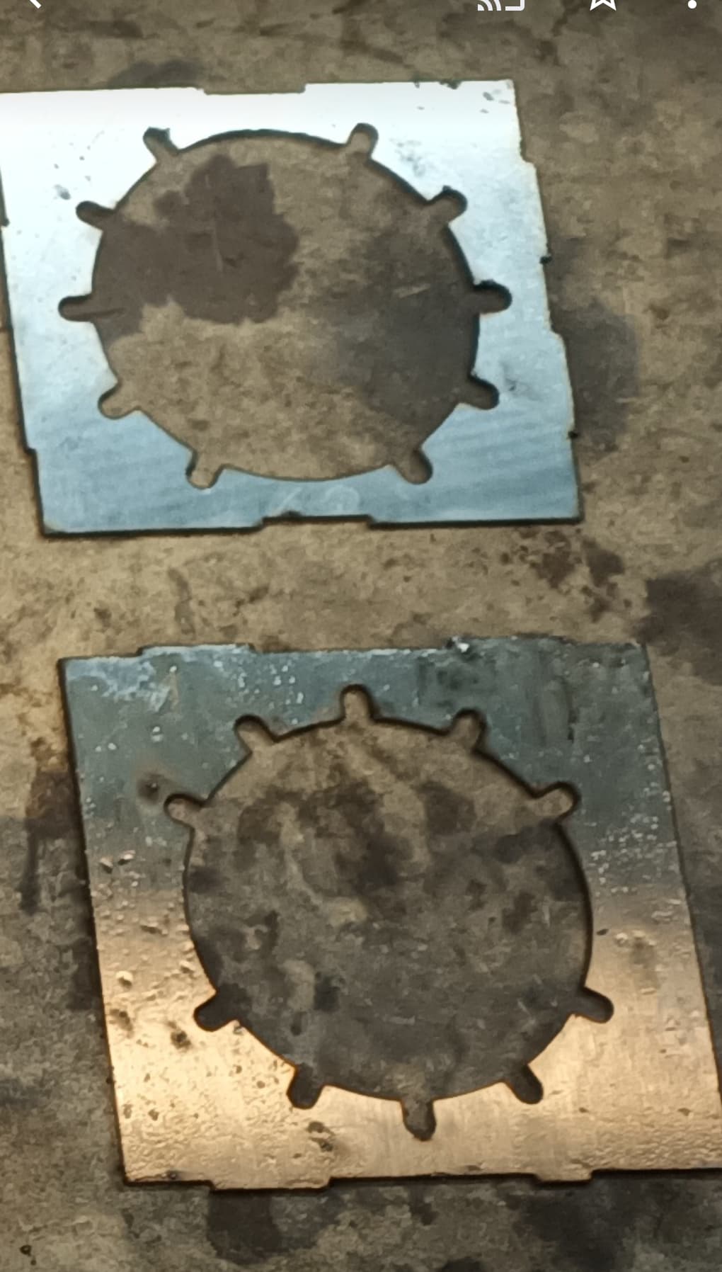

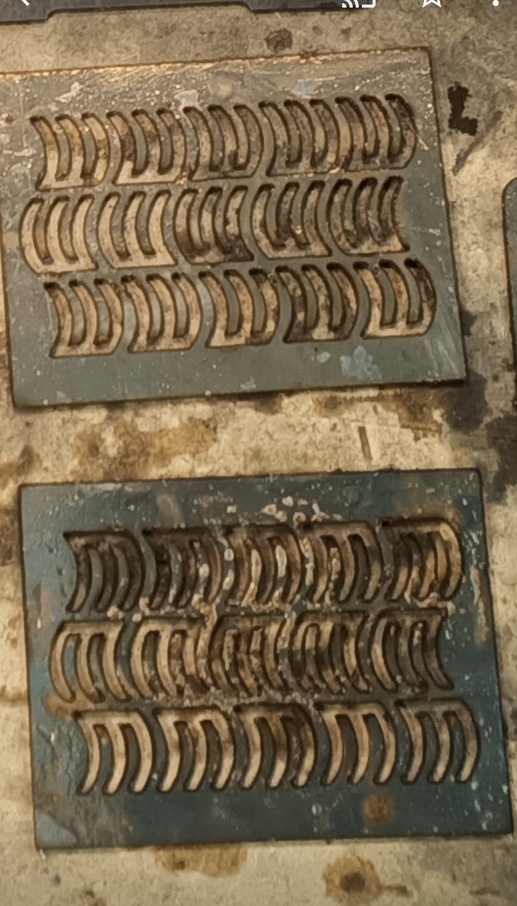

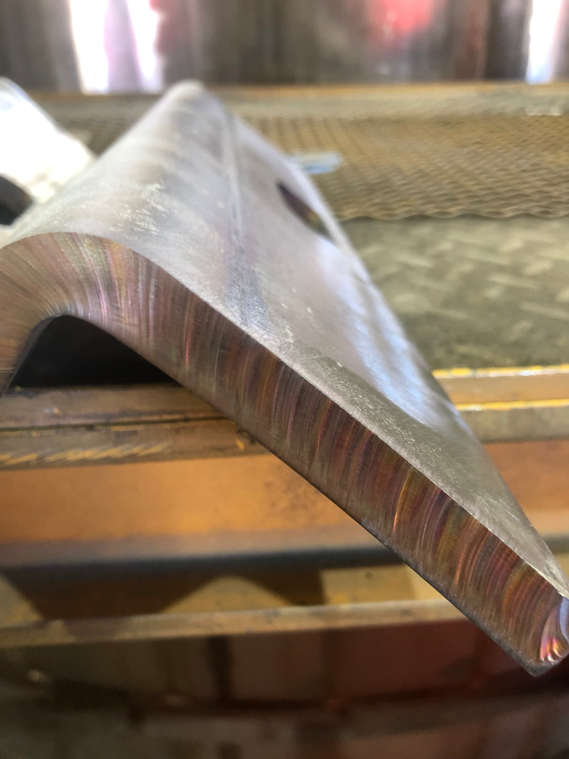

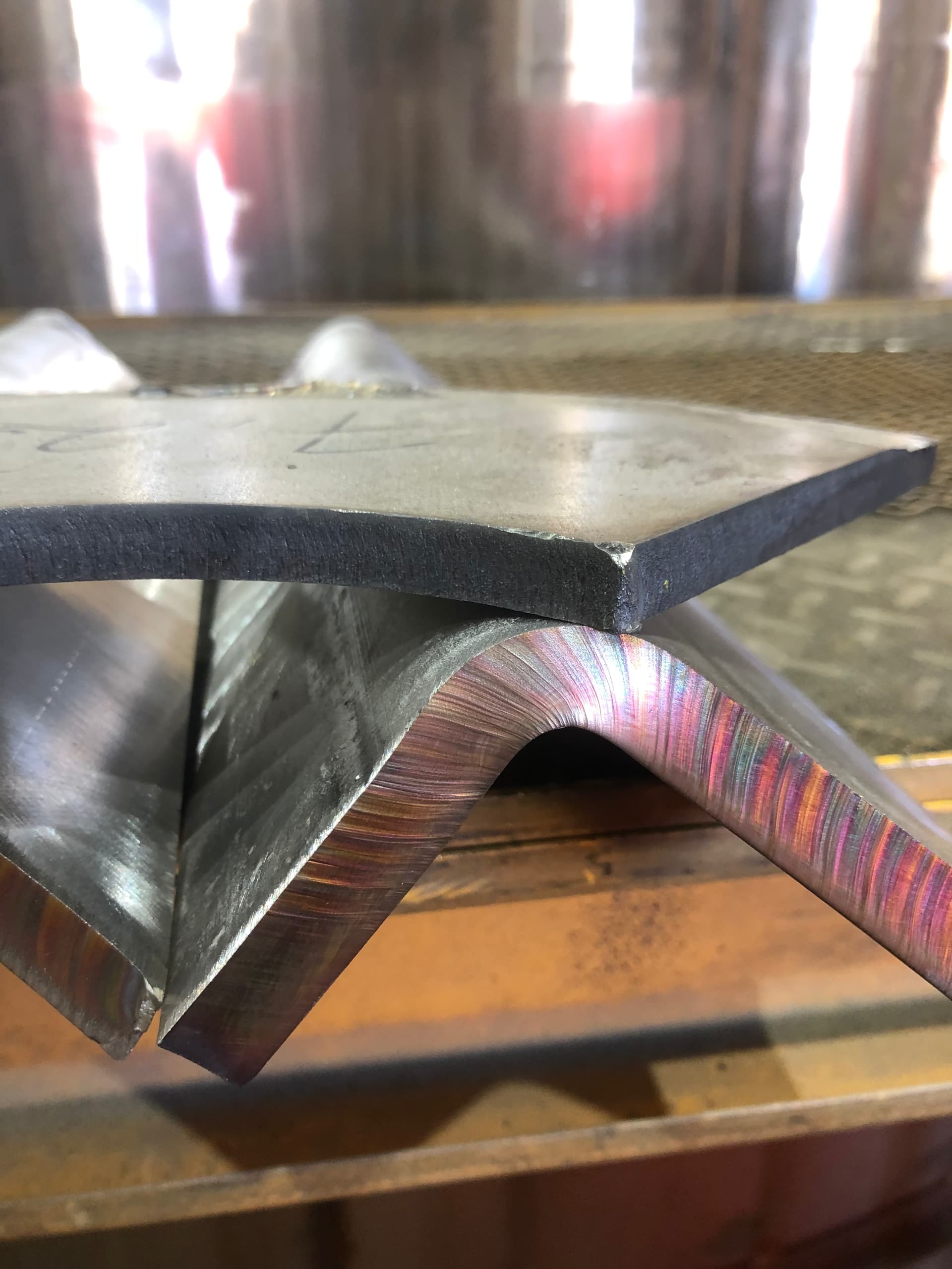

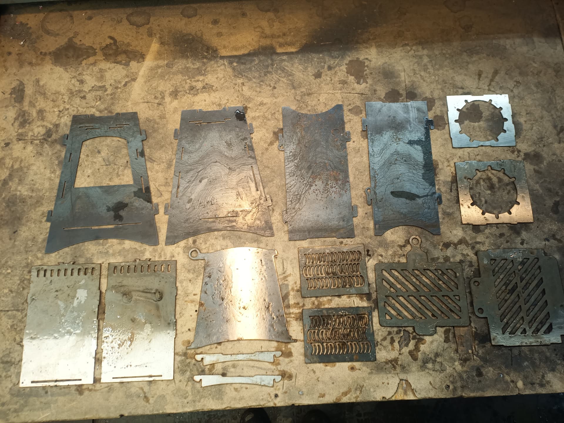

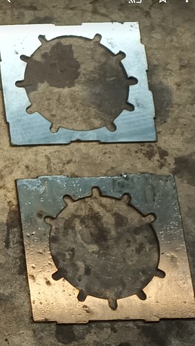

If you really want to make clean cuts on stainless you would have to use an inert shielding gas like argon. It won’t be cheap but that is how it is cut in production setting. Here is pics I took from one of my buddies who runs an industrial table that use other gas for the cutting jets. 304 ss

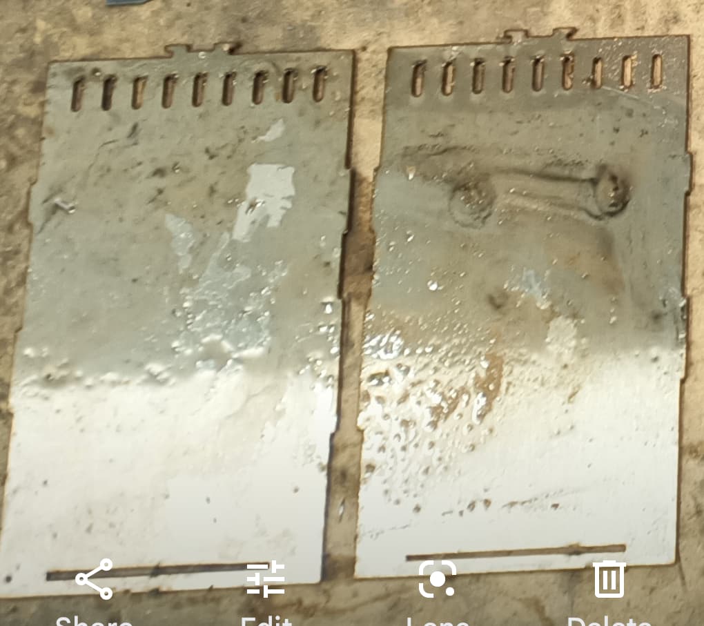

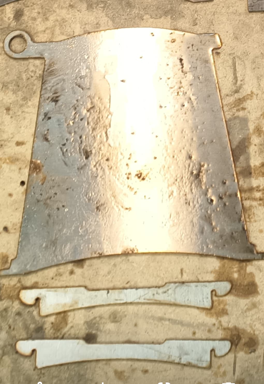

I use the book settings on my hypertherm with fine cut consumables and end up with almost a dross-free ready to use part.
During the cut I’m literally dumping water on top of the sheet
None of these parts in the picture have been cleaned up I’m going to try to find a backside pic but there’s very little to no dross on these parts
Edit. The picture of the parts on the table above is the back side of the part,s uncleaned and still wet from the table
I also run a very low cut height to prevent in entrainment of the atmospheric air into my arc column.
And for scale the one piece that looks like it has a bunch of E s cut out in it is just under 5 inch x 3 inch
