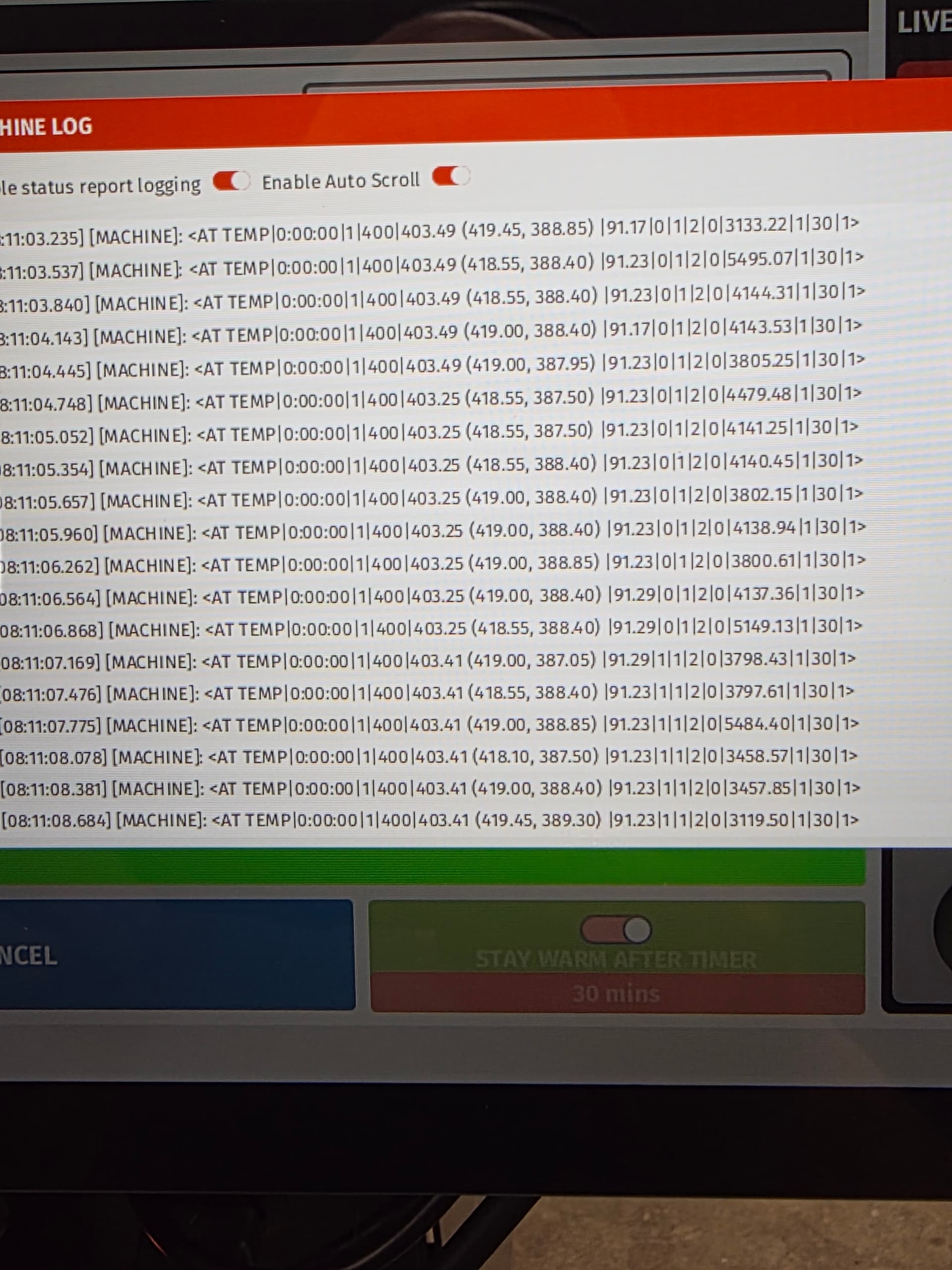

Add another. Show the individual thermocouple readings so people can tell which one is acting up when you get a message that the temperature difference between the two is far apart.

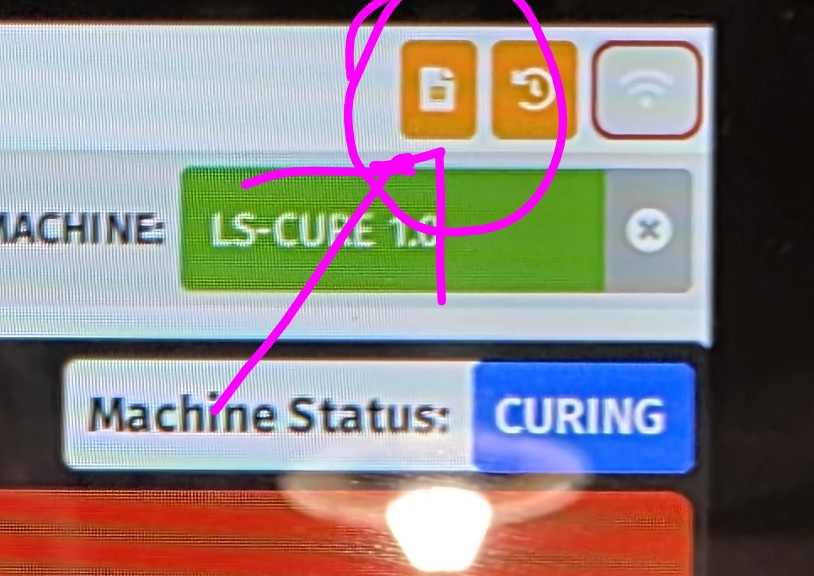

Go to the top right of CureControl and tap on the page icon. You can monitor each thermocouple and even track them on the scroll setting, as for the temp differential alarm. There really isn’t an issue except that the alarm threshold is too tight in CureControl during warm-up. They will address that in the future, I am sure.

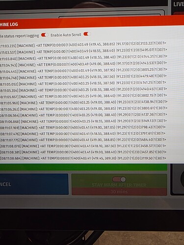

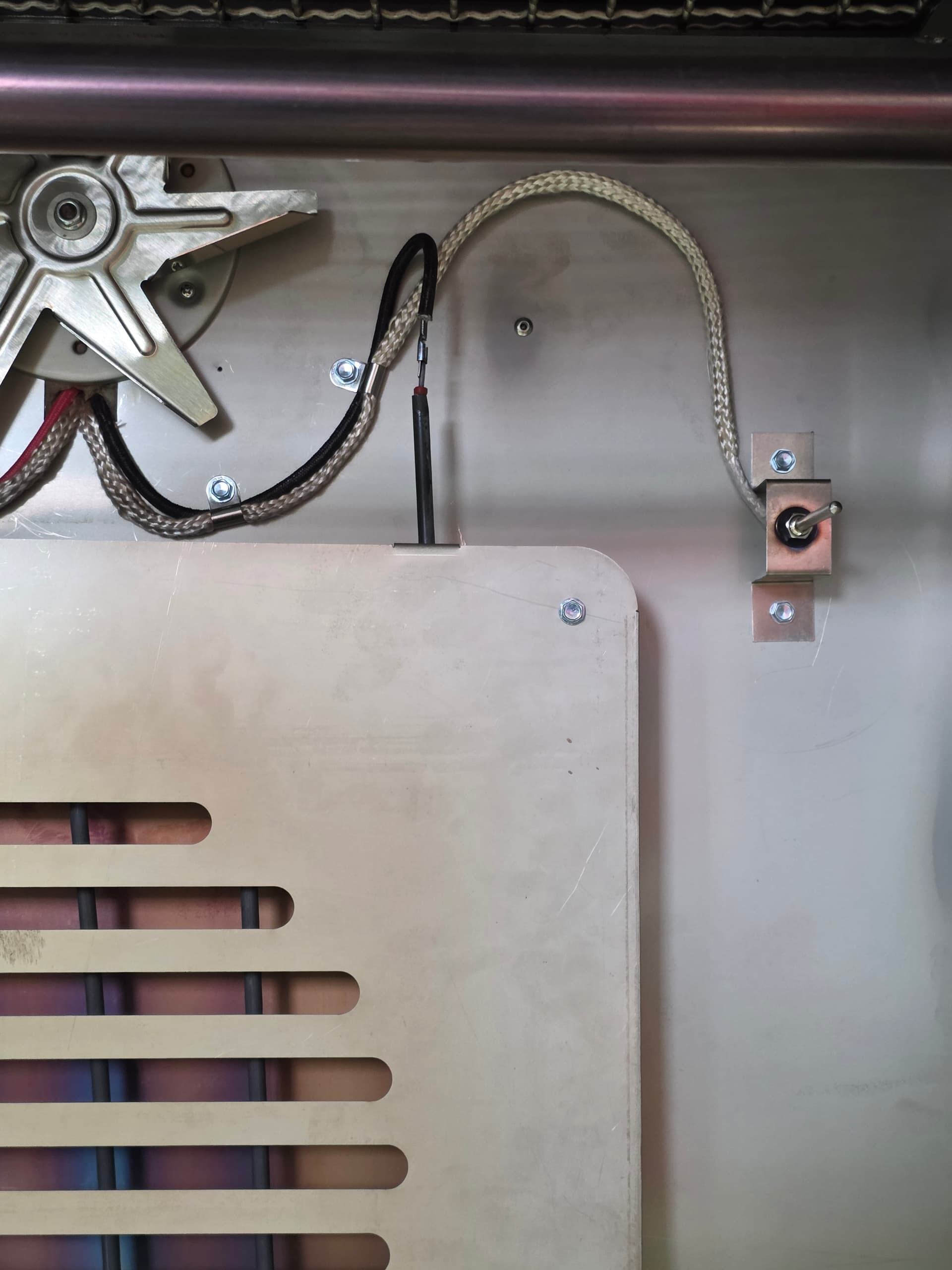

Thanks for that. Here is another reason I think it might be helpful to have the individual thermocouple measurements exposed on the main screen. The machine is just showing the average temp, but it would be good to see the delta to know when things are evenly up to temp. On mine, I see a 25 degree temperature spread between the two with the curculator fan running. That could be something else going on, as I know one of these thermocouples is behaving inconsistently, but unless you see that info up front, you wouldn’t know something is up because you’d just see the average. I think it would be a useful thing to see.
Out of curiosity, what is the temperature deviation you’re seeing between the two measurements on yours?
It looks like one is at 419° and the other at 389°.
I would get a meter on continuity and check if the thermocouple is going to ground via the metal shield cable to the oven chassis. I installed 600° shrink tube over the entire cable. The fiberglass cover in my picture keeps the spring from touching the chassis. I will check mine in the morning and report back. If one is grounding out, it will read low. The high temp shrink tube is available from McMaster Carr.
Another way to check is a sore subject, but if you temporarily disconnect the chassis ground and see if the thermocouple starts reading closer, that will tell you if it is a ground loop issue.
With mine, they sleeved them in fiberglass for about the first 4 feet off of the thermocouple. That said, it looks like what I thought were high temp plastic insulators aren’t doing so great, so I need to figure out a better solution there. That blackened ring around the thermocouple on the mount used to be a whitish color insulating washer. At a minimum, its now carbonized and could be the culprit.
If it’s touching the chassis, it will read low.
The ceramic insulators are the fix. I installed thread rivets inserts in the oven and screwed in 1/4 - 20 x 1-inch SS set screws. 1/4 -20 x .375 button head bolts. They will screw in the insulators. Problem solved as long as the cables aren’t touching. Do you have them mounted at 20” and 29”?

With a setpoint of 410 degrees, thermocouple #1 @ 29 inches is at 429.80 degrees. Thermocouple #2 @ 20 inches at 394.25 degrees. My machine has a 35-degree difference between the two levels of the oven. This is without the fan being turned on. Hope this helps you. Just a note, I do occasionally get an alarm during warm-up due to a high temperature differential.
Thanks. I’m not surprised at that level of differential without running a circulator fan, but I am a little surprised that its as large. As it is on mine after temps have stabilized and with the fan running. I would have expected the air to stay mixed and for the temperature throughout the oven to be more even. At a glance, it seems like the circulating fan isn’t really making a huge difference, at least on low.

Talking with the engineers over at Langmuir on Monday, I asked about the expected temperature differential between thermocouples with the over preheated and circulator fan running and they said they were only seeing like 3 degrees of delta. Just thought I’d pass that along.
I was busy this morning but, I did test the oven with the fan running and it was about 3 to 5 degrees differential when it reached setpoint.

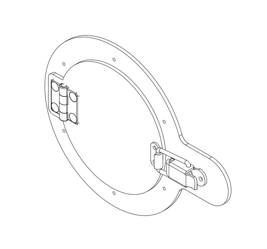

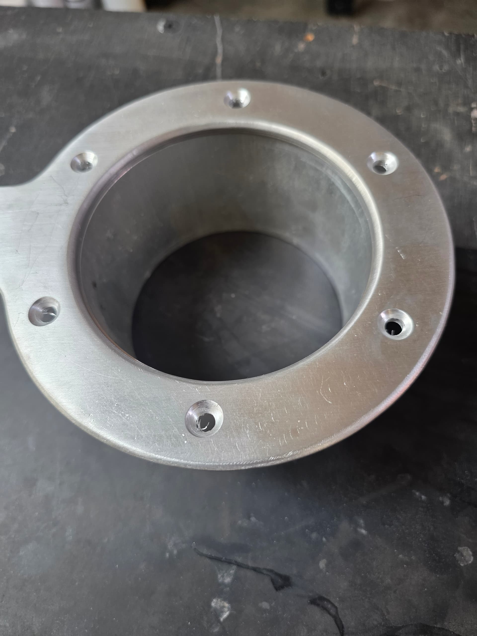

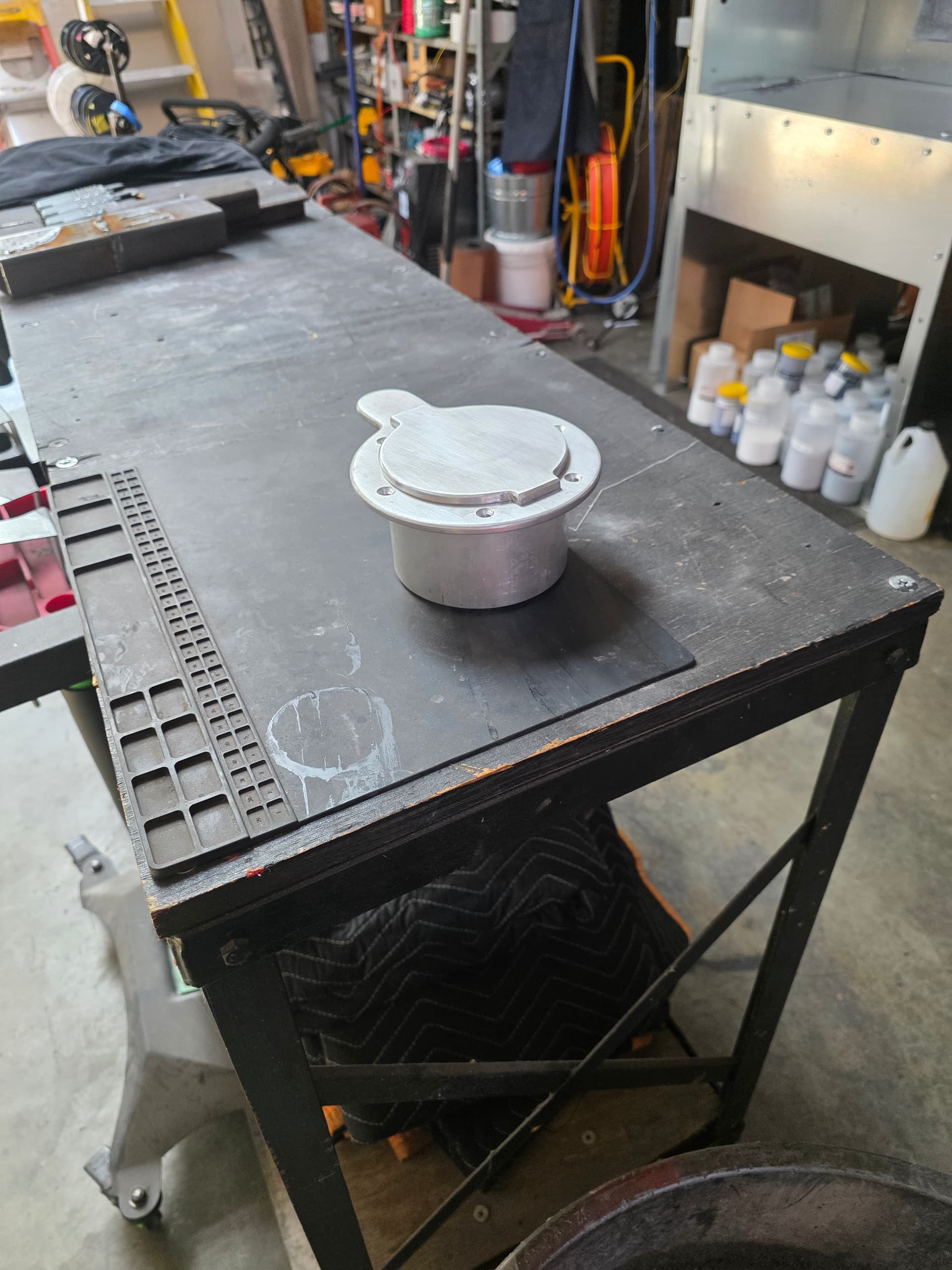

Almost finished with the port in the Vulcan door. @thesupermarket cad design. Now getting the balls to cut a 4-inch hole in the door..:zany_face:
Wow looks great! Nice work
