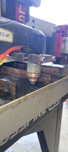

Was experimenting a little more today and the issue was a little more sporadic. Below are some observations:
  • Issue did not seem relegated to a particular side of the table. Guessing last time was more just coincidence with it occurring on one side. Below is a photo of my current setup.
  • Still had intermittent issues with the same program getting a good cut and then not. In the below photo, you will see several successful cuts on a rectangular tab rounded off on one end. On the fourth one, without changing anything about the program or ground, it pierced but didn’t continue the cut until 2" into the path.
  • A few times today at the start of a program, it wouldn’t iniate a cut and would instead throw a cup error back to the machine. When I would reset this and turn the crossfire off, the plasma cutter would fire manually no problem. Every time this happened today, it was only when running a cut program…but not every time. I also pulled the torch off and attempted a manual cut by hand and it cut just fine.
  • Hopefully you are able to see the video in the icloud link below but I attempted this program multiple times today. Several times resulted in the issues described above…in the video, you can see it starting and getting a good clean cut. Then, midway through, the cut path has intermittent issues.
With successful cuts mixed in with these errors, a little lost in what to chase down next.
With no metal on the table, can you manually jog the torch below the top of the slats in the offending area?
I can’t tell from the pictures. Were do you have the holder clamped to on the torch? Are you using a CNC shield?
Torch looks both clamped right, and waayyy high.
If the clamp is overly tightened it will deform the cup and cause some of these kinds of problems.
But only on the right side of the table?
Yes as the torch moves the torch cable is putting undue pressure on one side of the cup or twisting it.
I originally thought it was one side of the table because of repetitions but after today, I’m thinking it was just coincidence. I will get some photos tomorrow to address some of the other comments. Appreciate everyone’s feedback.
Looks like in photo you have a drag shield installed on torch? If you do the cut height will be wat to high and will have intermittent torch misfire and cuts. As George stated make sure you have machine shield .

Sorry for late response but just got around to some follow up photos which are below. The torch is able to go plenty far below the slats. Other photo shows my torch setup. Doesn’t have a drag shield on there. Cup condition appears ok. Again, I can get a great cut and then randomly lose it on the next run or middle of the current. Seems very sporadic so hard to pin down a consistent variable.
