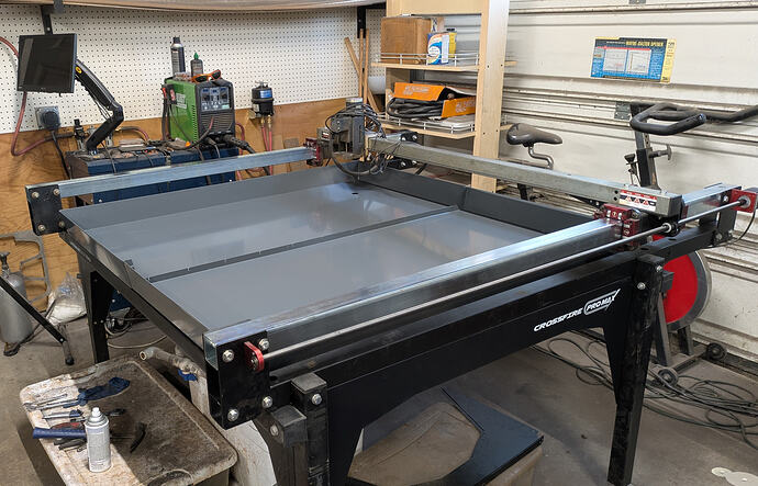

My upgrade kit showed up yesterday and I got most of it done today. All of the upgrade parts are installed (except the water pan) and it’s moving again. I read thru the instructions online, but decided to do it my own way. I didn’t see the need to remove the electronics enclosure to move the rear legs and several other steps made more sense to do in a different order.
The water pan is going to take some work to get it the way I want it. I’m not a fan of the drain holes in opposite corners, so I’ll probably weld them up and cut new holes in the center. I might weld the pan together, but that isn’t as easy as the old stainless pan. This one is painted and that will be a lot of grinding to remove the paint for welding, so I may take a chance with sealant.

I ran into an issue with my upgrade. It seems that the X axis motor cable is about 2” too short for the gantry to make it all the way to the front of the table. I looked through the instructions to see if there was a step where the electronics enclosure was mounted differently to account for this and didn’t see anything. I ordered a DB9 extension to get me running again
I needed the extension also. I made them aware of the issue. Oh well.
Next issue. No hardware to bolt the water pan together and no sealant. Maybe I’m supposed to reuse the hardware I threw away 4 years ago.
Now to decide if I weld it or buy some stainless nuts and use some of my stash of stainless M5 bolts.
3M 5200 is a good sealant. Takes a long time to dry and is more soupy than firm like normal silicone. It will never leak, though. 3M 4200 is good also, but dries much faster.
Welding worked for me. I tried sealing mine first and it leaked at one of the end points.
For welding prep, I used a 4” cutting disc to angle those slots where the bolts go and that provided a bit more access to weld in those troughs. I fusion welded (no filler rod) with TIG and haven’t had a leak since (about 3 yrs).
Or forget all of that and bend up one piece pan and put the drain where you want it.
I welded my old stainless pan. This one is painted or powder coated, so a bit more prep work is involved.
I have some 3m 4200 on the way, so I’ll try that first.
3M is good stuff but like mentioned, let it cure.
My 40+ gallon water bed has remained leak-free from having used 3M 5200 to seal the two parts together.
Both 4200 and 5200 are marine grade, but 5200 is meant to be a permanent solution whereas 4200 allows removal/disassembly.
