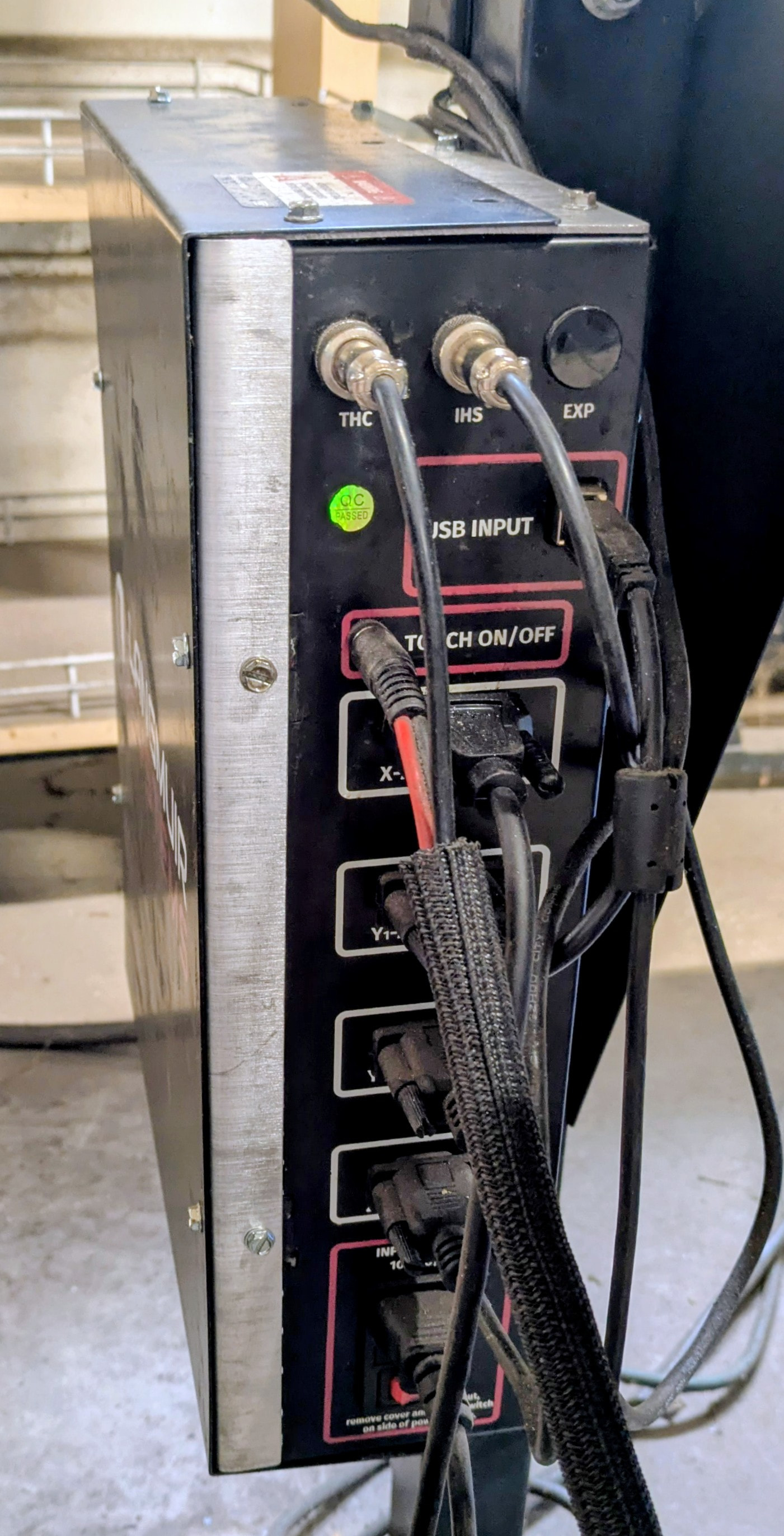

A few notes:
The drivers are bigger than the originals and the cover doesn’t fit back on the control box. I duct taped it back on until I can fabricate a new one.
I also had to put them in at an angle with only one screw. I was going to drill new holes, but the new holes interfered with the mounting screws for the box to the table leg.
It ran backwards with the wires transferred directly to the same terminals as the original drivers. I switched the B+ and B- wires to get it to run the correct direction.
I just came back in the house after installing the same drivers, with the same cover interference situation. I drilled new holes without any issues.

I made some filler pieces for the cover. Just a rectangle for the top and some 90 degree bent pieces for the sides. I bent the tabs out on the sides of the case to attach the side pieces. I left the bottom open for cooling.
