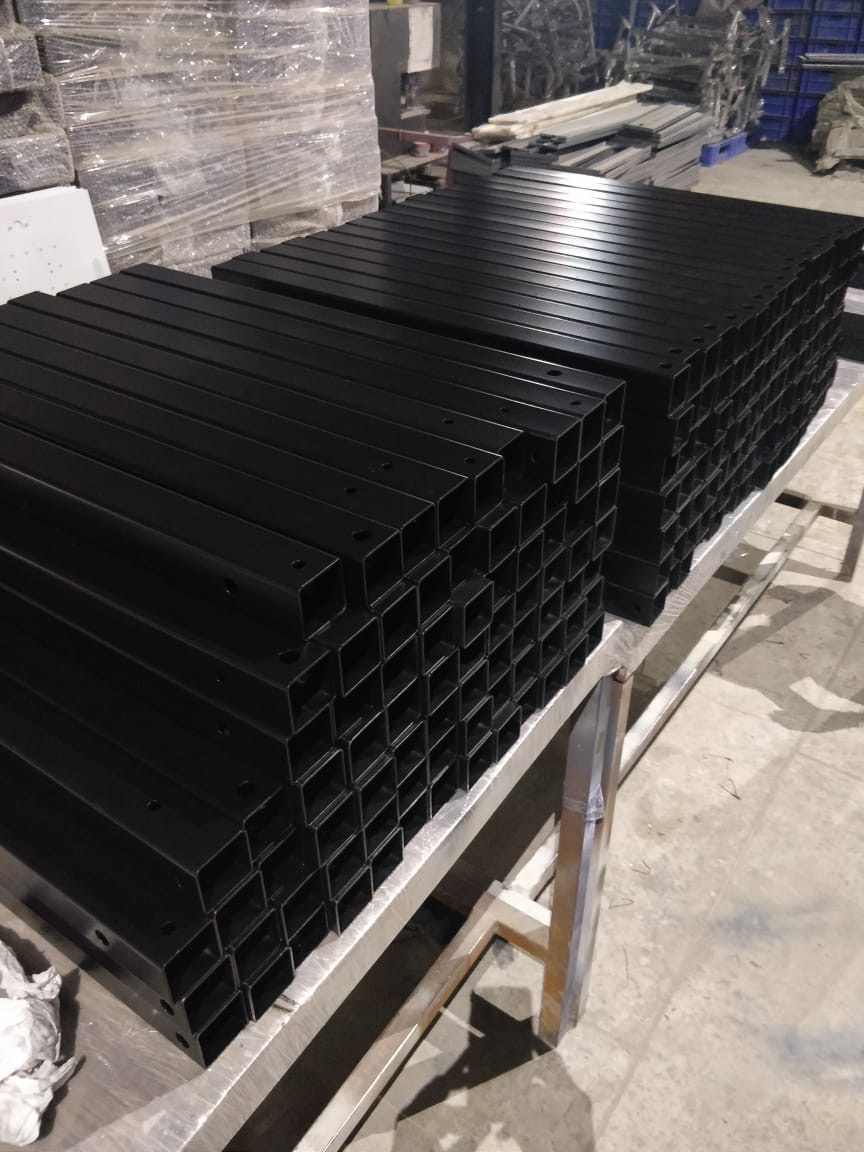

Quick update today; Some CrossFire PRO tubes coming off the powdering coating line!
Those ones on the left end are mine :yum:
Very nice!!! Really excited to get the new table in. Keep up the great work guys :facepunch:t5:
