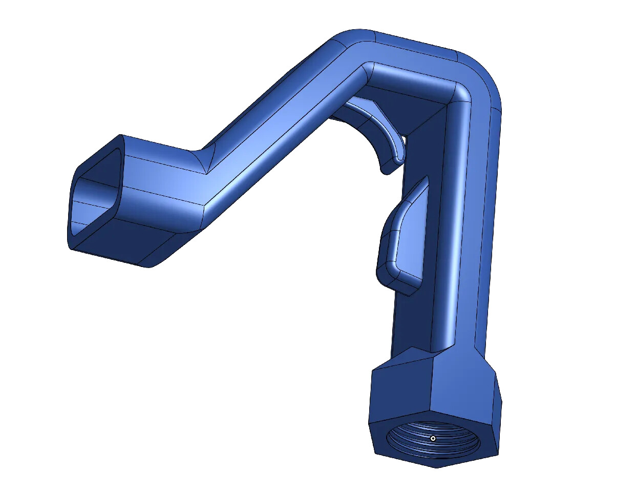

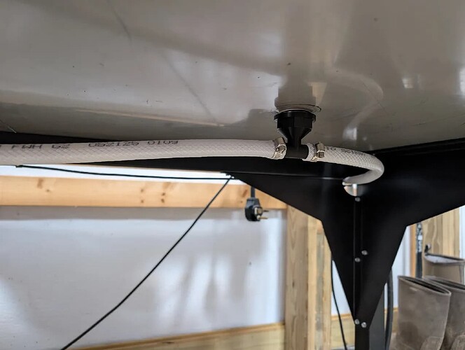

Langmuir Crossfire Pro CNC Plasma Drain Mod - Allows for easy draining with a garden hose.
CNC Plasma Water Table Filler - Fills table quickly without splashing.

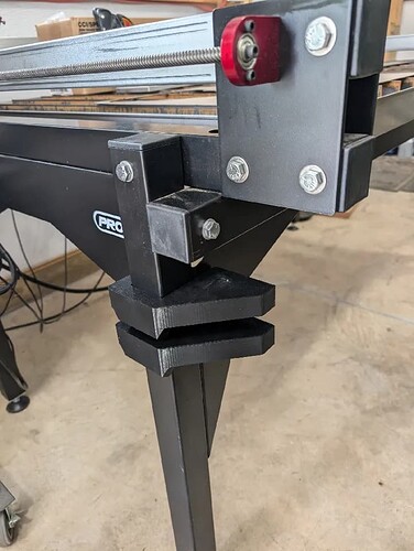

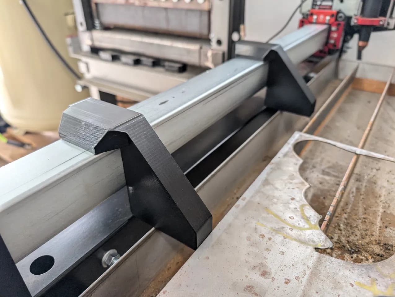

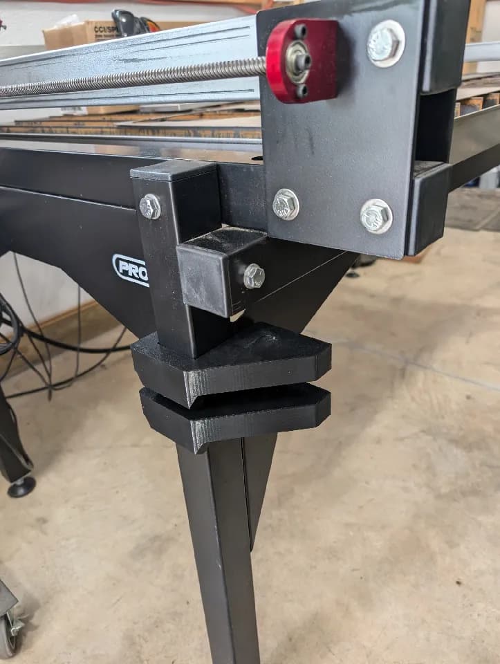

Langmuir CrossFire Pro CNC Sheet Alignment Tool - I’ve seen metal versions, this one is printable and less likely to scratch your rails.

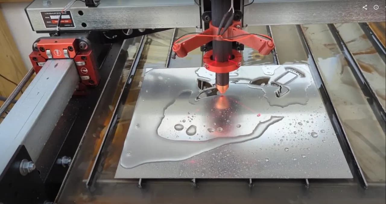

CNC Plasma Laser Guide/Crosshairs - My favorite mod, makes it super easy to set work zero.

I can see the slip on fence being very handy. Do you have magnets in them to hold them on the rails?
Yes sir, uses two 8x3 magnets (each)… has the added bonus that you can store them on the table legs.

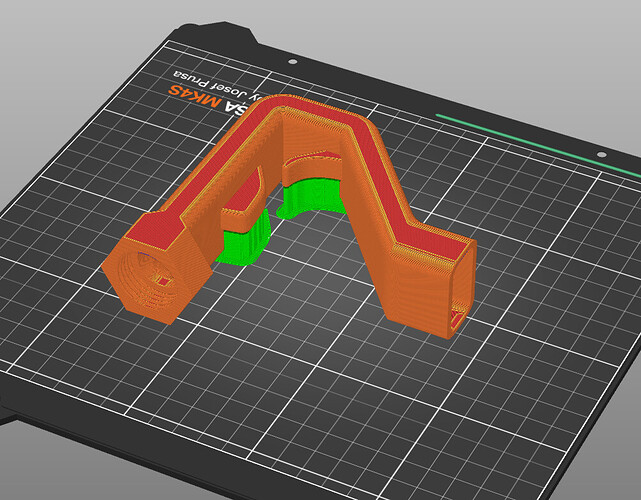

These mods are awesome! I tried to print the water table filler, and it kept failing. I’m sure it’s a problem on my end. Did you use supports when you printed it?
What type of printer do you have?
Bambu P1 and P2
Here is how I printed it (supports on the outer two “tabs” but no supports internally). Please let me know how it goes!
ok I’ll try it this way, thank you
I tried the sheet alignment tools and the sheet is too close to the rail. Am I missing something?
