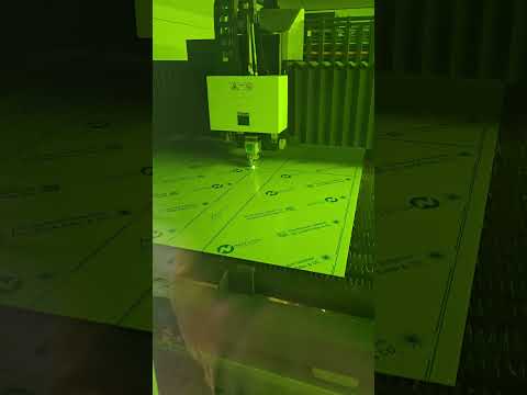

Craig, I just took a roadtrip to a local CNC shop to have a piece of 11g polished stainless steel cut on a laser table. This guy has a large houseboat at the marina.
This Laser table is a 12000w Trumpf $900k
Very impressive. It will cut 1.250 stainless like butter.
Here is a crummy video I took through the window.
First it plots the sheet position
Then changes the optical lens to what its cutting.
Then it low power cuts the vinyl cover
Then cuts the sheet.
12kW is killer big and fun to watch!

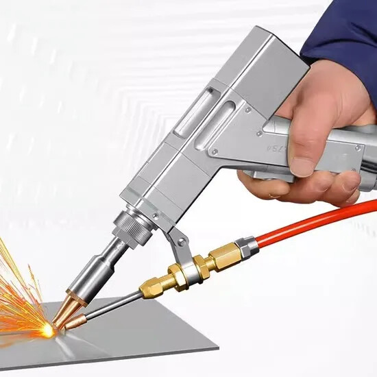

Looks like xtool has a better wire feeder attachment to the gun. Most of these laser welders have a mickey-mouse setup.

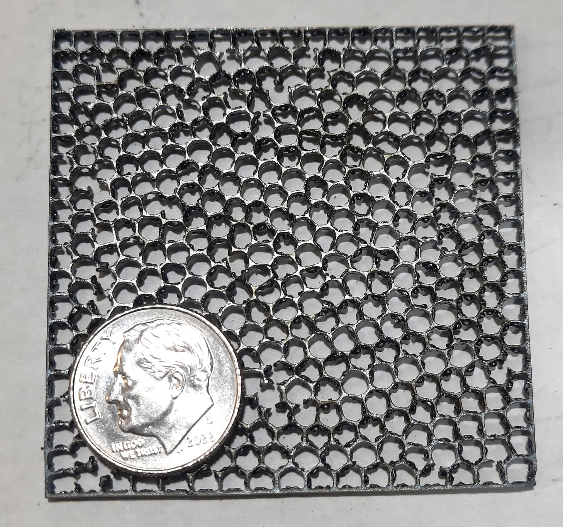

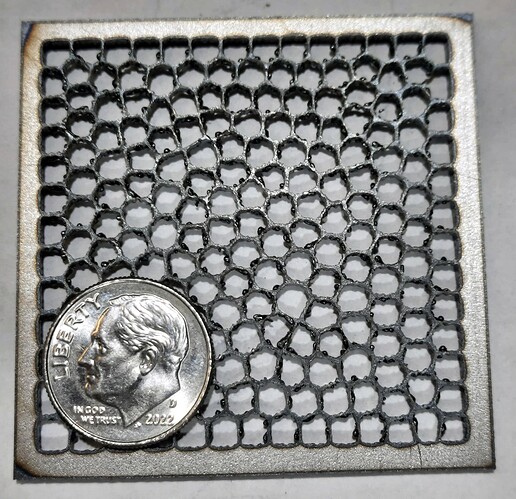

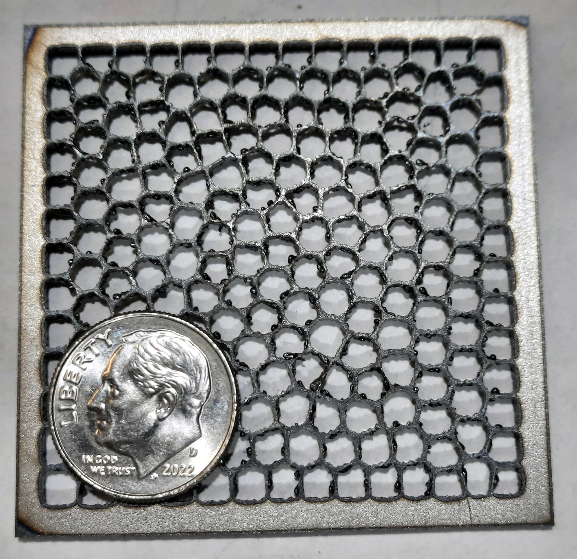

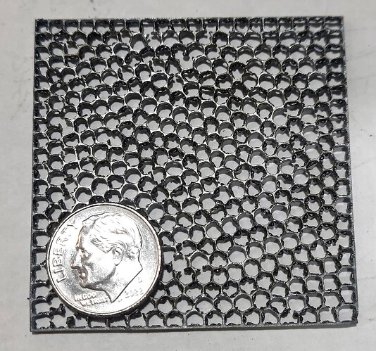

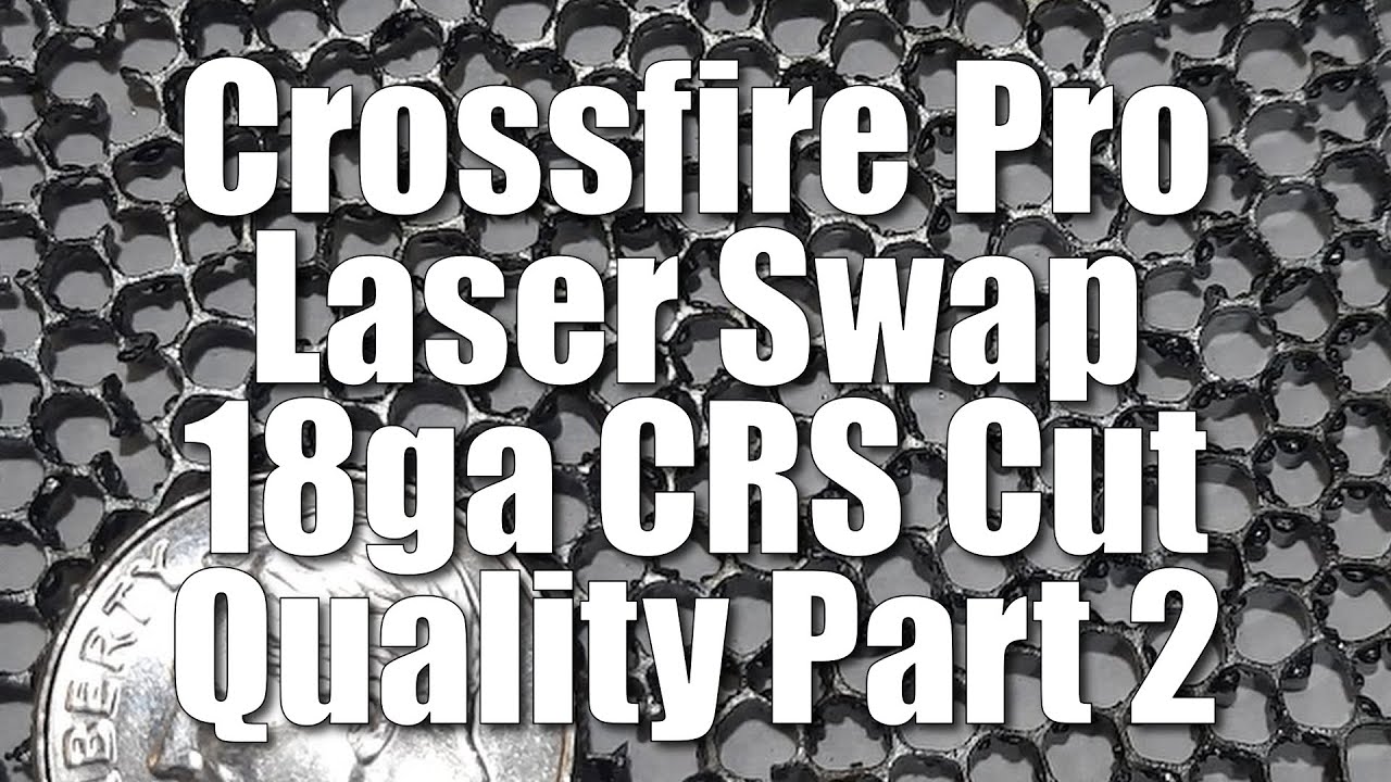

Friday Laser Fun.
18ga CRS 50x50mm voronoi coupon
40IPM 400W 200 cut outs 0.5mm spacing
20IPM 300W 400 cut outs 0.4mm spacing
Quite impressive, with these wafer thin bridges removing back side dross would likely tear the piece apart. I believe the second coupon is a little past the Crossfire Fire’s mechanical repeatability tolerance. Stock flex poses a serious issue with some of the bridges being blown out.
