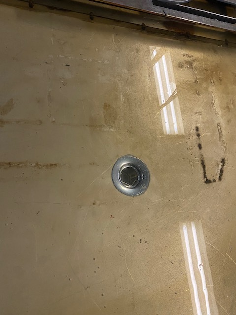

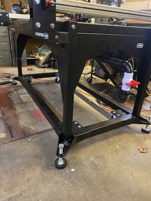

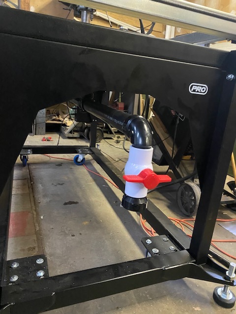

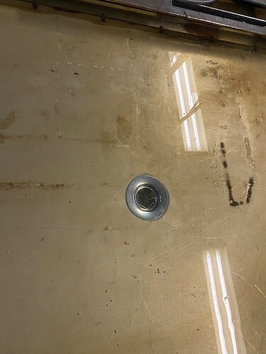

Erik thank you for the details of your project for the rolling base. Mine is almost identical less the 3" 3x3 angle iron(did not incorporate, rather I raised the caster base plate leaving enough room for full swivel. Also enlarged the drain holes of the stainless pan(with crossfire while in place) to accept larger drains with filters, to a 1.5" abs pipe and ball valve - to put a 5gal pale short term until I get a water tank/pump/filter setup.
